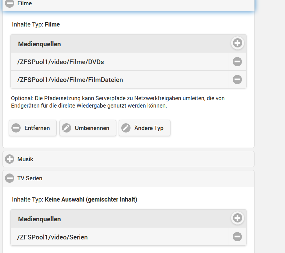

blublub 10 Posted April 16, 2015 Posted April 16, 2015 (edited) Hi I just switched from the old plugin to the new Emby plugin and I did follow the instructions (deinstalled old plugin, reset skin, , cleane dup kodi library and then installes emby plugin). Emby plugin now syncs Movies (I have 2 Types: Movies, Dokumentation) and Boxsets successfully. However the plugin does not sync my TV series. While syncing TV series pops up for a split second and is gone the next even though it should take the longest. I set Emby to "debug". Here is the Kodi log. thx kodi.log Edited April 16, 2015 by blublub
Solution xnappo 1611 Posted April 16, 2015 Solution Posted April 16, 2015 Please check that on the server you have the content type set to TV.
blublub 10 Posted April 16, 2015 Author Posted April 16, 2015 (edited) Please check that on the server you have the content type set to TV. It somehow show up as "unknown" but I have set it up as "TV" and in Emby web interface it is under "TV" !? Ok I now set it up with the correct type, hopefully my stats are not removed.... Edited April 16, 2015 by blublub
