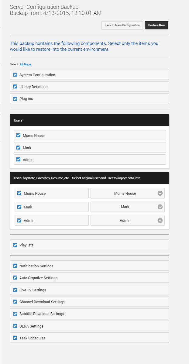

ebr 16342 Posted April 13, 2015 Posted April 13, 2015 Can you show me a screen cap of the restore screen just before you hit the Restore Now button?

ebr 16342 Posted April 14, 2015 Posted April 14, 2015 Try doing it piecemeal to see if we can isolate the issue. Deselect everything except the users to restore and try it. If that works, then just do the user data.
Spaceboy 2573 Posted April 14, 2015 Author Posted April 14, 2015 ok, the problem is located. did just users and still no go, then went user by user, the problem is user Mums House. Now looking at this the clear difference is that Mums House has a space in the name and i remember that emby made me call it Mums_House initially but i was able to rename it to remove the _. so it seems that the server backup plugin doesn't support user names with a space in the name. Hope this is helpful!
ebr 16342 Posted April 14, 2015 Posted April 14, 2015 I don't think it is the backup plug-in per se I think it is the actual core server that has a problem with them. Thanks for nailing it down.
