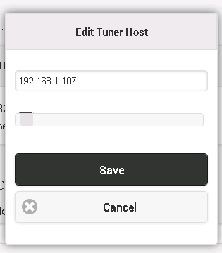

oldschool 16 Posted June 11, 2015 Posted June 11, 2015 I decided to try out this plugin, but I messed up. For some reason, my router is listing a hostname for my HDHR, but I can't ping that hostname. I would rather use a hostname instead of an IP because my router is using DHCP and that IP will most likely change the next time I restart my router. When I went to the config page (using FIrefox and Chrome), it didn't offer me a nice list of the HDHR tuners I have. I tried to input the hostname in the box, and immediately Emby crashed. I now cannot recover. My server will not startup. When I try to launch Emby, it gives me the error: Unhandled exception: The remote name could not be resolved: 'hdhr-13125dd3'. I tried searching inside the C:\Users\Administrator\AppData\Roaming\MediaBrowser-Server\config\system.xml file and it doesn't find that entry. I'm not sure where you're storing this setting right now. I cannot start Emby at the moment because of this issue.
mediacowboy 438 Posted June 11, 2015 Posted June 11, 2015 Look in the plugin folder for a configurations folder. Inside that folder is the embytv.xml and delete that. That should fix it where your server can boot up. 1
oldschool 16 Posted June 11, 2015 Posted June 11, 2015 Thank you for the quick response! BTW - once I corrected it in the XML, it showed up in the configuration, but on Firefox, there's a problem with the GUI. See attached image.
mediacowboy 438 Posted June 11, 2015 Posted June 11, 2015 I'm not sure on that one. Do you see that if you add a new Turner?
