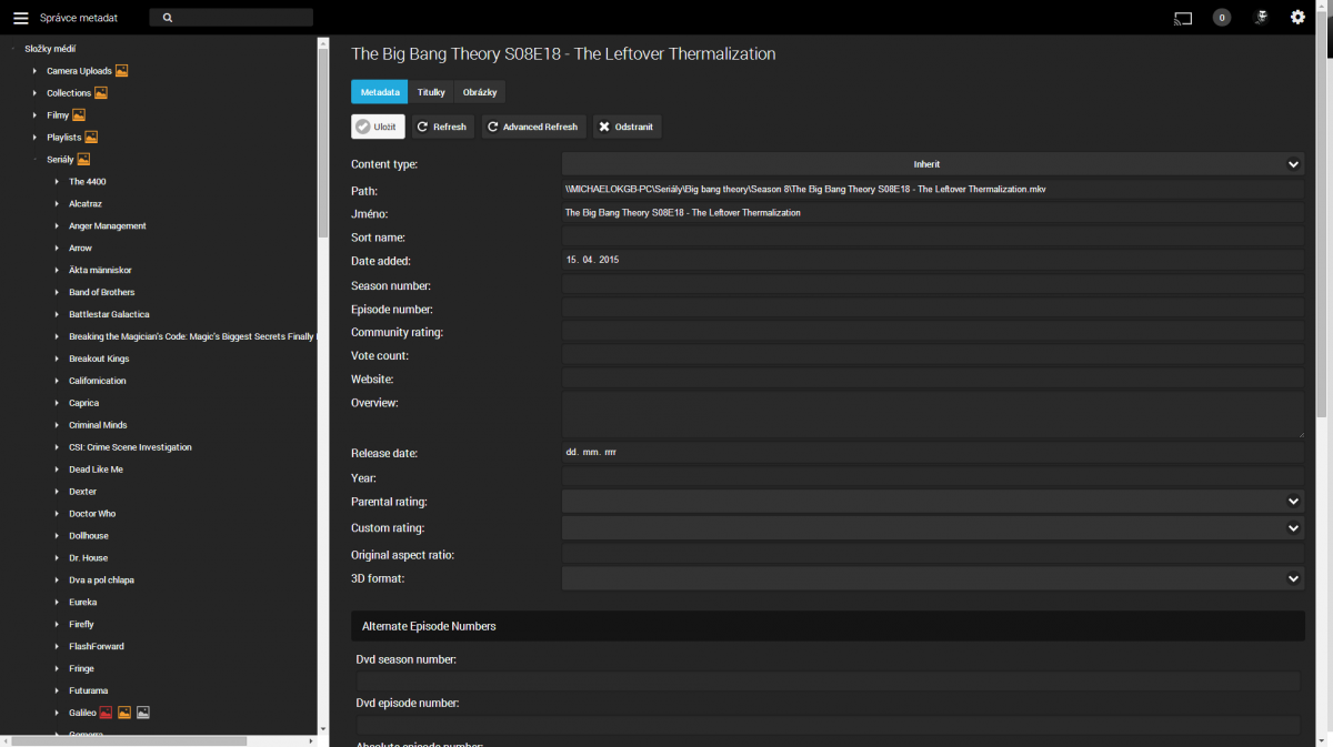

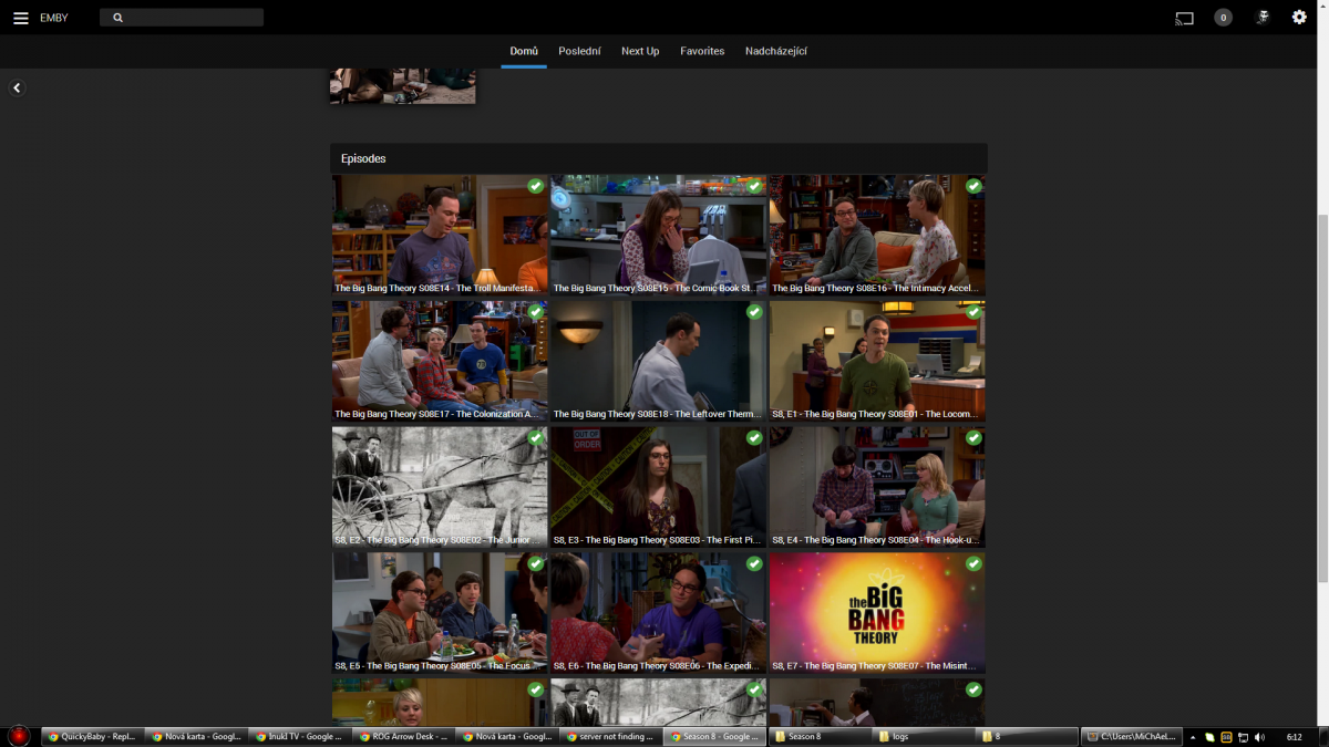

MiChAeLoKGB 7 Posted April 16, 2015 Posted April 16, 2015 (edited) Ok, so I uninstalled cover art... that dman thing is generating too much spam in logs... I restarted the server, moved those unrecognized parts to separate drive, removed the metadata saved about them, did a season refresh & waited a bit. Then I put those parts back, waited till EMBY finds them on its own and waited again. As it did not pick up the metadata I used refresh, but with no luck. Also attaching how it looks in Season 8 folder of TBBT. You can just search for Big Bang in the log to find it faster... but I think you know that, lol Parts of the log Deleting of the files: 2015-04-16 06:07:16.5858 Debug - LibraryMonitor: Changed detected of type Deleted to F:\Seriály\Big bang theory\Season 8\The Big Bang Theory S08E14 - The Troll Manifestation.mkv 2015-04-16 06:07:16.5858 Debug - LibraryMonitor: Changed detected of type Changed to F:\Seriály\Big bang theory\Season 8 2015-04-16 06:07:16.5858 Debug - LibraryMonitor: Changed detected of type Deleted to F:\Seriály\Big bang theory\Season 8\The Big Bang Theory S08E14 - The Troll Manifestation-thumb.jpg 2015-04-16 06:07:16.5858 Debug - LibraryMonitor: Changed detected of type Changed to F:\Seriály\Big bang theory\Season 8 2015-04-16 06:07:29.3715 Debug - LibraryMonitor: Changed detected of type Deleted to F:\Seriály\Big bang theory\Season 8\The Big Bang Theory S08E15 - The Comic Book Store Regeneration.mkv 2015-04-16 06:07:29.3715 Debug - LibraryMonitor: Changed detected of type Changed to F:\Seriály\Big bang theory\Season 8 2015-04-16 06:07:29.3715 Debug - LibraryMonitor: Changed detected of type Deleted to F:\Seriály\Big bang theory\Season 8\The Big Bang Theory S08E15 - The Comic Book Store Regeneration-thumb.jpg 2015-04-16 06:07:29.3715 Debug - LibraryMonitor: Changed detected of type Changed to F:\Seriály\Big bang theory\Season 8 2015-04-16 06:07:38.9691 Debug - LibraryMonitor: Changed detected of type Deleted to F:\Seriály\Big bang theory\Season 8\The Big Bang Theory S08E16 - The Intimacy Acceleration.mkv 2015-04-16 06:07:38.9691 Debug - LibraryMonitor: Changed detected of type Changed to F:\Seriály\Big bang theory\Season 8 2015-04-16 06:07:38.9691 Debug - LibraryMonitor: Changed detected of type Deleted to F:\Seriály\Big bang theory\Season 8\The Big Bang Theory S08E16 - The Intimacy Acceleration-thumb.jpg 2015-04-16 06:07:38.9691 Debug - LibraryMonitor: Changed detected of type Changed to F:\Seriály\Big bang theory\Season 8 2015-04-16 06:07:49.2847 Debug - LibraryMonitor: Changed detected of type Deleted to F:\Seriály\Big bang theory\Season 8\The Big Bang Theory S08E17 - The Colonization Application.mkv 2015-04-16 06:07:49.2847 Debug - LibraryMonitor: Changed detected of type Changed to F:\Seriály\Big bang theory\Season 8 2015-04-16 06:07:49.2847 Debug - LibraryMonitor: Changed detected of type Deleted to F:\Seriály\Big bang theory\Season 8\The Big Bang Theory S08E17 - The Colonization Application-thumb.jpg 2015-04-16 06:07:49.2847 Debug - LibraryMonitor: Changed detected of type Changed to F:\Seriály\Big bang theory\Season 8 2015-04-16 06:07:49.6807 Debug - LibraryMonitor: Changed detected of type Deleted to F:\Seriály\Big bang theory\Season 8\The Big Bang Theory S08E18 - The Leftover Thermalization.mkv 2015-04-16 06:07:49.6807 Debug - LibraryMonitor: Changed detected of type Changed to F:\Seriály\Big bang theory\Season 8 2015-04-16 06:07:49.6807 Debug - LibraryMonitor: Changed detected of type Deleted to F:\Seriály\Big bang theory\Season 8\The Big Bang Theory S08E18 - The Leftover Thermalization-thumb.jpg 2015-04-16 06:07:49.6807 Debug - LibraryMonitor: Changed detected of type Changed to F:\Seriály\Big bang theory\Season 8 Adding files back: 2015-04-16 06:08:10.0159 Debug - App: Running MovieDbSeasonProvider for F:\Seriály\Big bang theory\Season 8 2015-04-16 06:08:10.0619 Debug - App: Running SeasonXmlProvider for F:\Seriály\Big bang theory\Season 8 2015-04-16 06:08:10.0619 Debug - App: Running TvdbSeasonImageProvider for F:\Seriály\Big bang theory\Season 82015-04-16 06:08:10.5229 Debug - App: Running FanArtSeasonProvider for F:\Seriály\Big bang theory\Season 8 2015-04-16 06:08:10.5229 Debug - ProviderManager: Saving F:\Seriály\Big bang theory\Season 8 to Emby Xml. 2015-04-16 06:08:10.5399 Debug - LibraryMonitor: Changed detected of type Changed to F:\Seriály\Big bang theory\Season 8\season.xml 2015-04-16 06:08:10.5399 Debug - LibraryMonitor: Ignoring change to F:\Seriály\Big bang theory\Season 8\season.xml 2015-04-16 06:08:10.5399 Debug - LibraryMonitor: Changed detected of type Changed to F:\Seriály\Big bang theory\Season 8\season.xml 2015-04-16 06:08:10.5399 Debug - LibraryMonitor: Ignoring change to F:\Seriály\Big bang theory\Season 8\season.xml 2015-04-16 06:08:10.5399 Debug - App: Saving F:\Seriály\Big bang theory\Season 8 to database. 2015-04-16 06:08:10.5799 Debug - App: Running FFProbeProvider for F:\Seriály\Big bang theory\Season 8\The Big Bang Theory S08E05 - The Focus Attenuation.mkv 2015-04-16 06:08:10.5889 Debug - MediaEncoder: C:\Users\MiChAeLoKGB\AppData\Roaming\MediaBrowser-Server\ffmpeg\20150331\ffprobe.exe -i file:"F:\Seriály\Big bang theory\Season 8\The Big Bang Theory S08E05 - The Focus Attenuation.mkv" -threads 0 -v info -print_format json -show_streams -show_chapters -show_format 2015-04-16 06:08:10.8159 Debug - App: Running TvdbEpisodeProvider for F:\Seriály\Big bang theory\Season 8\The Big Bang Theory S08E05 - The Focus Attenuation.mkv 2015-04-16 06:08:10.8199 Debug - App: TvdbEpisodeProvider returned no metadata for F:\Seriály\Big bang theory\Season 8\The Big Bang Theory S08E05 - The Focus Attenuation.mkv 2015-04-16 06:08:10.8199 Debug - App: Running EpisodeXmlProvider for F:\Seriály\Big bang theory\Season 8\The Big Bang Theory S08E05 - The Focus Attenuation.mkv 2015-04-16 06:08:10.8199 Debug - ProviderManager: Saving F:\Seriály\Big bang theory\Season 8\The Big Bang Theory S08E05 - The Focus Attenuation.mkv to Emby Xml. 2015-04-16 06:08:10.8199 Debug - LibraryMonitor: Changed detected of type Changed to F:\Seriály\Big bang theory\Season 8\metadata\The Big Bang Theory S08E05 - The Focus Attenuation.xml 2015-04-16 06:08:10.8199 Debug - LibraryMonitor: Ignoring change to F:\Seriály\Big bang theory\Season 8\metadata\The Big Bang Theory S08E05 - The Focus Attenuation.xml 2015-04-16 06:08:10.8199 Debug - LibraryMonitor: Changed detected of type Changed to F:\Seriály\Big bang theory\Season 8\metadata\The Big Bang Theory S08E05 - The Focus Attenuation.xml 2015-04-16 06:08:10.8199 Debug - LibraryMonitor: Ignoring change to F:\Seriály\Big bang theory\Season 8\metadata\The Big Bang Theory S08E05 - The Focus Attenuation.xml 2015-04-16 06:08:10.8199 Debug - App: Saving F:\Seriály\Big bang theory\Season 8\The Big Bang Theory S08E05 - The Focus Attenuation.mkv to database. 2015-04-16 06:08:10.8509 Debug - App: Running FFProbeProvider for F:\Seriály\Big bang theory\Season 8\The Big Bang Theory S08E12 - The Space Probe Disintegration.mkv 2015-04-16 06:08:10.8509 Debug - MediaEncoder: C:\Users\MiChAeLoKGB\AppData\Roaming\MediaBrowser-Server\ffmpeg\20150331\ffprobe.exe -i file:"F:\Seriály\Big bang theory\Season 8\The Big Bang Theory S08E12 - The Space Probe Disintegration.mkv" -threads 0 -v info -print_format json -show_streams -show_chapters -show_format 2015-04-16 06:08:10.9809 Debug - App: Running TvdbEpisodeProvider for F:\Seriály\Big bang theory\Season 8\The Big Bang Theory S08E12 - The Space Probe Disintegration.mkv 2015-04-16 06:08:10.9809 Debug - App: TvdbEpisodeProvider returned no metadata for F:\Seriály\Big bang theory\Season 8\The Big Bang Theory S08E12 - The Space Probe Disintegration.mkv 2015-04-16 06:08:10.9809 Debug - App: Running EpisodeXmlProvider for F:\Seriály\Big bang theory\Season 8\The Big Bang Theory S08E12 - The Space Probe Disintegration.mkv 2015-04-16 06:08:10.9809 Debug - ProviderManager: Saving F:\Seriály\Big bang theory\Season 8\The Big Bang Theory S08E12 - The Space Probe Disintegration.mkv to Emby Xml. 2015-04-16 06:08:10.9809 Debug - LibraryMonitor: Changed detected of type Changed to F:\Seriály\Big bang theory\Season 8\metadata\The Big Bang Theory S08E12 - The Space Probe Disintegration.xml 2015-04-16 06:08:10.9809 Debug - LibraryMonitor: Ignoring change to F:\Seriály\Big bang theory\Season 8\metadata\The Big Bang Theory S08E12 - The Space Probe Disintegration.xml 2015-04-16 06:08:10.9809 Debug - LibraryMonitor: Changed detected of type Changed to F:\Seriály\Big bang theory\Season 8\metadata\The Big Bang Theory S08E12 - The Space Probe Disintegration.xml 2015-04-16 06:08:10.9809 Debug - LibraryMonitor: Ignoring change to F:\Seriály\Big bang theory\Season 8\metadata\The Big Bang Theory S08E12 - The Space Probe Disintegration.xml 2015-04-16 06:08:10.9809 Debug - App: Saving F:\Seriály\Big bang theory\Season 8\The Big Bang Theory S08E12 - The Space Probe Disintegration.mkv to database. 2015-04-16 06:08:10.9959 Debug - App: Running FFProbeProvider for F:\Seriály\Big bang theory\Season 8\The Big Bang Theory S08E09 - The Septum Deviation.mkv 2015-04-16 06:08:10.9959 Debug - MediaEncoder: C:\Users\MiChAeLoKGB\AppData\Roaming\MediaBrowser-Server\ffmpeg\20150331\ffprobe.exe -i file:"F:\Seriály\Big bang theory\Season 8\The Big Bang Theory S08E09 - The Septum Deviation.mkv" -threads 0 -v info -print_format json -show_streams -show_chapters -show_format 2015-04-16 06:08:11.0909 Debug - App: Running TvdbEpisodeProvider for F:\Seriály\Big bang theory\Season 8\The Big Bang Theory S08E09 - The Septum Deviation.mkv 2015-04-16 06:08:11.0909 Debug - App: TvdbEpisodeProvider returned no metadata for F:\Seriály\Big bang theory\Season 8\The Big Bang Theory S08E09 - The Septum Deviation.mkv 2015-04-16 06:08:11.0909 Debug - App: Running EpisodeXmlProvider for F:\Seriály\Big bang theory\Season 8\The Big Bang Theory S08E09 - The Septum Deviation.mkv 2015-04-16 06:08:11.0909 Debug - ProviderManager: Saving F:\Seriály\Big bang theory\Season 8\The Big Bang Theory S08E09 - The Septum Deviation.mkv to Emby Xml. 2015-04-16 06:08:11.0909 Debug - LibraryMonitor: Changed detected of type Changed to F:\Seriály\Big bang theory\Season 8\metadata\The Big Bang Theory S08E09 - The Septum Deviation.xml 2015-04-16 06:08:11.0909 Debug - LibraryMonitor: Ignoring change to F:\Seriály\Big bang theory\Season 8\metadata\The Big Bang Theory S08E09 - The Septum Deviation.xml 2015-04-16 06:08:11.0909 Debug - LibraryMonitor: Changed detected of type Changed to F:\Seriály\Big bang theory\Season 8\metadata\The Big Bang Theory S08E09 - The Septum Deviation.xml 2015-04-16 06:08:11.0909 Debug - LibraryMonitor: Ignoring change to F:\Seriály\Big bang theory\Season 8\metadata\The Big Bang Theory S08E09 - The Septum Deviation.xml 2015-04-16 06:08:11.0909 Debug - App: Saving F:\Seriály\Big bang theory\Season 8\The Big Bang Theory S08E09 - The Septum Deviation.mkv to database. 2015-04-16 06:08:11.1019 Debug - App: Running FFProbeProvider for F:\Seriály\Big bang theory\Season 8\The Big Bang Theory S08E03 - The First Pitch Insufficiency.mkv 2015-04-16 06:08:11.1019 Debug - MediaEncoder: C:\Users\MiChAeLoKGB\AppData\Roaming\MediaBrowser-Server\ffmpeg\20150331\ffprobe.exe -i file:"F:\Seriály\Big bang theory\Season 8\The Big Bang Theory S08E03 - The First Pitch Insufficiency.mkv" -threads 0 -v info -print_format json -show_streams -show_chapters -show_format 2015-04-16 06:08:11.2669 Debug - App: Running TvdbEpisodeProvider for F:\Seriály\Big bang theory\Season 8\The Big Bang Theory S08E03 - The First Pitch Insufficiency.mkv 2015-04-16 06:08:11.2669 Debug - App: TvdbEpisodeProvider returned no metadata for F:\Seriály\Big bang theory\Season 8\The Big Bang Theory S08E03 - The First Pitch Insufficiency.mkv 2015-04-16 06:08:11.2669 Debug - App: Running EpisodeXmlProvider for F:\Seriály\Big bang theory\Season 8\The Big Bang Theory S08E03 - The First Pitch Insufficiency.mkv 2015-04-16 06:08:11.2669 Debug - ProviderManager: Saving F:\Seriály\Big bang theory\Season 8\The Big Bang Theory S08E03 - The First Pitch Insufficiency.mkv to Emby Xml. 2015-04-16 06:08:11.2699 Debug - LibraryMonitor: Changed detected of type Changed to F:\Seriály\Big bang theory\Season 8\metadata\The Big Bang Theory S08E03 - The First Pitch Insufficiency.xml 2015-04-16 06:08:11.2699 Debug - LibraryMonitor: Ignoring change to F:\Seriály\Big bang theory\Season 8\metadata\The Big Bang Theory S08E03 - The First Pitch Insufficiency.xml 2015-04-16 06:08:11.2699 Debug - LibraryMonitor: Changed detected of type Changed to F:\Seriály\Big bang theory\Season 8\metadata\The Big Bang Theory S08E03 - The First Pitch Insufficiency.xml 2015-04-16 06:08:11.2699 Debug - LibraryMonitor: Ignoring change to F:\Seriály\Big bang theory\Season 8\metadata\The Big Bang Theory S08E03 - The First Pitch Insufficiency.xml 2015-04-16 06:08:11.2699 Debug - App: Saving F:\Seriály\Big bang theory\Season 8\The Big Bang Theory S08E03 - The First Pitch Insufficiency.mkv to database. 2015-04-16 06:08:11.2699 Debug - App: Running FFProbeProvider for F:\Seriály\Big bang theory\Season 8\The Big Bang Theory S08E11 - The Clean Room Infiltration.mkv 2015-04-16 06:08:11.2699 Debug - MediaEncoder: C:\Users\MiChAeLoKGB\AppData\Roaming\MediaBrowser-Server\ffmpeg\20150331\ffprobe.exe -i file:"F:\Seriály\Big bang theory\Season 8\The Big Bang Theory S08E11 - The Clean Room Infiltration.mkv" -threads 0 -v info -print_format json -show_streams -show_chapters -show_format 2015-04-16 06:08:11.4099 Debug - App: Running TvdbEpisodeProvider for F:\Seriály\Big bang theory\Season 8\The Big Bang Theory S08E11 - The Clean Room Infiltration.mkv 2015-04-16 06:08:11.4099 Debug - App: TvdbEpisodeProvider returned no metadata for F:\Seriály\Big bang theory\Season 8\The Big Bang Theory S08E11 - The Clean Room Infiltration.mkv 2015-04-16 06:08:11.4099 Debug - App: Running EpisodeXmlProvider for F:\Seriály\Big bang theory\Season 8\The Big Bang Theory S08E11 - The Clean Room Infiltration.mkv 2015-04-16 06:08:11.4099 Debug - ProviderManager: Saving F:\Seriály\Big bang theory\Season 8\The Big Bang Theory S08E11 - The Clean Room Infiltration.mkv to Emby Xml. 2015-04-16 06:08:11.4099 Debug - LibraryMonitor: Changed detected of type Changed to F:\Seriály\Big bang theory\Season 8\metadata\The Big Bang Theory S08E11 - The Clean Room Infiltration.xml 2015-04-16 06:08:11.4099 Debug - LibraryMonitor: Ignoring change to F:\Seriály\Big bang theory\Season 8\metadata\The Big Bang Theory S08E11 - The Clean Room Infiltration.xml 2015-04-16 06:08:11.4099 Debug - LibraryMonitor: Changed detected of type Changed to F:\Seriály\Big bang theory\Season 8\metadata\The Big Bang Theory S08E11 - The Clean Room Infiltration.xml 2015-04-16 06:08:11.4099 Debug - LibraryMonitor: Ignoring change to F:\Seriály\Big bang theory\Season 8\metadata\The Big Bang Theory S08E11 - The Clean Room Infiltration.xml 2015-04-16 06:08:11.4099 Debug - App: Saving F:\Seriály\Big bang theory\Season 8\The Big Bang Theory S08E11 - The Clean Room Infiltration.mkv to database. 2015-04-16 06:08:11.4099 Debug - App: Running FFProbeProvider for F:\Seriály\Big bang theory\Season 8\The Big Bang Theory S08E10 - The Champagne Reflection.mkv 2015-04-16 06:08:11.4099 Debug - MediaEncoder: C:\Users\MiChAeLoKGB\AppData\Roaming\MediaBrowser-Server\ffmpeg\20150331\ffprobe.exe -i file:"F:\Seriály\Big bang theory\Season 8\The Big Bang Theory S08E10 - The Champagne Reflection.mkv" -threads 0 -v info -print_format json -show_streams -show_chapters -show_format 2015-04-16 06:08:11.5259 Debug - App: Running TvdbEpisodeProvider for F:\Seriály\Big bang theory\Season 8\The Big Bang Theory S08E10 - The Champagne Reflection.mkv 2015-04-16 06:08:11.5259 Debug - App: TvdbEpisodeProvider returned no metadata for F:\Seriály\Big bang theory\Season 8\The Big Bang Theory S08E10 - The Champagne Reflection.mkv 2015-04-16 06:08:11.5259 Debug - App: Running EpisodeXmlProvider for F:\Seriály\Big bang theory\Season 8\The Big Bang Theory S08E10 - The Champagne Reflection.mkv 2015-04-16 06:08:11.5259 Debug - ProviderManager: Saving F:\Seriály\Big bang theory\Season 8\The Big Bang Theory S08E10 - The Champagne Reflection.mkv to Emby Xml. 2015-04-16 06:08:11.5259 Debug - LibraryMonitor: Changed detected of type Changed to F:\Seriály\Big bang theory\Season 8\metadata\The Big Bang Theory S08E10 - The Champagne Reflection.xml 2015-04-16 06:08:11.5259 Debug - LibraryMonitor: Ignoring change to F:\Seriály\Big bang theory\Season 8\metadata\The Big Bang Theory S08E10 - The Champagne Reflection.xml 2015-04-16 06:08:11.5259 Debug - LibraryMonitor: Changed detected of type Changed to F:\Seriály\Big bang theory\Season 8\metadata\The Big Bang Theory S08E10 - The Champagne Reflection.xml 2015-04-16 06:08:11.5259 Debug - LibraryMonitor: Ignoring change to F:\Seriály\Big bang theory\Season 8\metadata\The Big Bang Theory S08E10 - The Champagne Reflection.xml 2015-04-16 06:08:11.5259 Debug - App: Saving F:\Seriály\Big bang theory\Season 8\The Big Bang Theory S08E10 - The Champagne Reflection.mkv to database. 2015-04-16 06:08:11.5379 Debug - App: Running FFProbeProvider for F:\Seriály\Big bang theory\Season 8\The Big Bang Theory S08E06 - The Expedition Approximation.mkv 2015-04-16 06:08:11.5379 Debug - MediaEncoder: C:\Users\MiChAeLoKGB\AppData\Roaming\MediaBrowser-Server\ffmpeg\20150331\ffprobe.exe -i file:"F:\Seriály\Big bang theory\Season 8\The Big Bang Theory S08E06 - The Expedition Approximation.mkv" -threads 0 -v info -print_format json -show_streams -show_chapters -show_format 2015-04-16 06:08:11.6689 Debug - App: Running TvdbEpisodeProvider for F:\Seriály\Big bang theory\Season 8\The Big Bang Theory S08E06 - The Expedition Approximation.mkv 2015-04-16 06:08:11.6689 Debug - App: TvdbEpisodeProvider returned no metadata for F:\Seriály\Big bang theory\Season 8\The Big Bang Theory S08E06 - The Expedition Approximation.mkv 2015-04-16 06:08:11.6689 Debug - App: Running EpisodeXmlProvider for F:\Seriály\Big bang theory\Season 8\The Big Bang Theory S08E06 - The Expedition Approximation.mkv 2015-04-16 06:08:11.6689 Debug - ProviderManager: Saving F:\Seriály\Big bang theory\Season 8\The Big Bang Theory S08E06 - The Expedition Approximation.mkv to Emby Xml. 2015-04-16 06:08:11.6689 Debug - LibraryMonitor: Changed detected of type Changed to F:\Seriály\Big bang theory\Season 8\metadata\The Big Bang Theory S08E06 - The Expedition Approximation.xml 2015-04-16 06:08:11.6689 Debug - LibraryMonitor: Ignoring change to F:\Seriály\Big bang theory\Season 8\metadata\The Big Bang Theory S08E06 - The Expedition Approximation.xml 2015-04-16 06:08:11.6689 Debug - LibraryMonitor: Changed detected of type Changed to F:\Seriály\Big bang theory\Season 8\metadata\The Big Bang Theory S08E06 - The Expedition Approximation.xml 2015-04-16 06:08:11.6689 Debug - App: Saving F:\Seriály\Big bang theory\Season 8\The Big Bang Theory S08E06 - The Expedition Approximation.mkv to database. 2015-04-16 06:08:11.6689 Debug - LibraryMonitor: Ignoring change to F:\Seriály\Big bang theory\Season 8\metadata\The Big Bang Theory S08E06 - The Expedition Approximation.xml 2015-04-16 06:08:11.6839 Debug - App: Running FFProbeProvider for F:\Seriály\Big bang theory\Season 8\The Big Bang Theory S08E04 - The Hook-up Reverberation.mkv 2015-04-16 06:08:11.6839 Debug - MediaEncoder: C:\Users\MiChAeLoKGB\AppData\Roaming\MediaBrowser-Server\ffmpeg\20150331\ffprobe.exe -i file:"F:\Seriály\Big bang theory\Season 8\The Big Bang Theory S08E04 - The Hook-up Reverberation.mkv" -threads 0 -v info -print_format json -show_streams -show_chapters -show_format 2015-04-16 06:08:11.8310 Debug - App: Running TvdbEpisodeProvider for F:\Seriály\Big bang theory\Season 8\The Big Bang Theory S08E04 - The Hook-up Reverberation.mkv 2015-04-16 06:08:11.8310 Debug - App: TvdbEpisodeProvider returned no metadata for F:\Seriály\Big bang theory\Season 8\The Big Bang Theory S08E04 - The Hook-up Reverberation.mkv 2015-04-16 06:08:11.8310 Debug - App: Running EpisodeXmlProvider for F:\Seriály\Big bang theory\Season 8\The Big Bang Theory S08E04 - The Hook-up Reverberation.mkv 2015-04-16 06:08:11.8310 Debug - ProviderManager: Saving F:\Seriály\Big bang theory\Season 8\The Big Bang Theory S08E04 - The Hook-up Reverberation.mkv to Emby Xml. 2015-04-16 06:08:11.8310 Debug - LibraryMonitor: Changed detected of type Changed to F:\Seriály\Big bang theory\Season 8\metadata\The Big Bang Theory S08E04 - The Hook-up Reverberation.xml 2015-04-16 06:08:11.8310 Debug - LibraryMonitor: Ignoring change to F:\Seriály\Big bang theory\Season 8\metadata\The Big Bang Theory S08E04 - The Hook-up Reverberation.xml 2015-04-16 06:08:11.8310 Debug - App: Saving F:\Seriály\Big bang theory\Season 8\The Big Bang Theory S08E04 - The Hook-up Reverberation.mkv to database. 2015-04-16 06:08:11.8310 Debug - LibraryMonitor: Changed detected of type Changed to F:\Seriály\Big bang theory\Season 8\metadata\The Big Bang Theory S08E04 - The Hook-up Reverberation.xml 2015-04-16 06:08:11.8310 Debug - LibraryMonitor: Ignoring change to F:\Seriály\Big bang theory\Season 8\metadata\The Big Bang Theory S08E04 - The Hook-up Reverberation.xml 2015-04-16 06:08:11.8480 Debug - App: Running FFProbeProvider for F:\Seriály\Big bang theory\Season 8\The Big Bang Theory S08E13 - The Anxiety Optimization.mkv 2015-04-16 06:08:11.8480 Debug - MediaEncoder: C:\Users\MiChAeLoKGB\AppData\Roaming\MediaBrowser-Server\ffmpeg\20150331\ffprobe.exe -i file:"F:\Seriály\Big bang theory\Season 8\The Big Bang Theory S08E13 - The Anxiety Optimization.mkv" -threads 0 -v info -print_format json -show_streams -show_chapters -show_format 2015-04-16 06:08:11.9500 Debug - App: Running TvdbEpisodeProvider for F:\Seriály\Big bang theory\Season 8\The Big Bang Theory S08E13 - The Anxiety Optimization.mkv 2015-04-16 06:08:11.9500 Debug - App: TvdbEpisodeProvider returned no metadata for F:\Seriály\Big bang theory\Season 8\The Big Bang Theory S08E13 - The Anxiety Optimization.mkv 2015-04-16 06:08:11.9500 Debug - App: Running EpisodeXmlProvider for F:\Seriály\Big bang theory\Season 8\The Big Bang Theory S08E13 - The Anxiety Optimization.mkv 2015-04-16 06:08:11.9500 Debug - ProviderManager: Saving F:\Seriály\Big bang theory\Season 8\The Big Bang Theory S08E13 - The Anxiety Optimization.mkv to Emby Xml. 2015-04-16 06:08:11.9500 Debug - LibraryMonitor: Changed detected of type Changed to F:\Seriály\Big bang theory\Season 8\metadata\The Big Bang Theory S08E13 - The Anxiety Optimization.xml 2015-04-16 06:08:11.9500 Debug - LibraryMonitor: Ignoring change to F:\Seriály\Big bang theory\Season 8\metadata\The Big Bang Theory S08E13 - The Anxiety Optimization.xml 2015-04-16 06:08:11.9500 Debug - LibraryMonitor: Changed detected of type Changed to F:\Seriály\Big bang theory\Season 8\metadata\The Big Bang Theory S08E13 - The Anxiety Optimization.xml 2015-04-16 06:08:11.9500 Debug - App: Saving F:\Seriály\Big bang theory\Season 8\The Big Bang Theory S08E13 - The Anxiety Optimization.mkv to database. 2015-04-16 06:08:11.9500 Debug - LibraryMonitor: Ignoring change to F:\Seriály\Big bang theory\Season 8\metadata\The Big Bang Theory S08E13 - The Anxiety Optimization.xml 2015-04-16 06:08:11.9640 Debug - App: Running FFProbeProvider for F:\Seriály\Big bang theory\Season 8\The Big Bang Theory S08E08 - The Prom Equivalency.mkv 2015-04-16 06:08:11.9640 Debug - MediaEncoder: C:\Users\MiChAeLoKGB\AppData\Roaming\MediaBrowser-Server\ffmpeg\20150331\ffprobe.exe -i file:"F:\Seriály\Big bang theory\Season 8\The Big Bang Theory S08E08 - The Prom Equivalency.mkv" -threads 0 -v info -print_format json -show_streams -show_chapters -show_format 2015-04-16 06:08:12.1050 Debug - App: Running TvdbEpisodeProvider for F:\Seriály\Big bang theory\Season 8\The Big Bang Theory S08E08 - The Prom Equivalency.mkv 2015-04-16 06:08:12.1050 Debug - App: TvdbEpisodeProvider returned no metadata for F:\Seriály\Big bang theory\Season 8\The Big Bang Theory S08E08 - The Prom Equivalency.mkv 2015-04-16 06:08:12.1050 Debug - App: Running EpisodeXmlProvider for F:\Seriály\Big bang theory\Season 8\The Big Bang Theory S08E08 - The Prom Equivalency.mkv 2015-04-16 06:08:12.1050 Debug - ProviderManager: Saving F:\Seriály\Big bang theory\Season 8\The Big Bang Theory S08E08 - The Prom Equivalency.mkv to Emby Xml. 2015-04-16 06:08:12.1050 Debug - LibraryMonitor: Changed detected of type Changed to F:\Seriály\Big bang theory\Season 8\metadata\The Big Bang Theory S08E08 - The Prom Equivalency.xml 2015-04-16 06:08:12.1050 Debug - LibraryMonitor: Ignoring change to F:\Seriály\Big bang theory\Season 8\metadata\The Big Bang Theory S08E08 - The Prom Equivalency.xml 2015-04-16 06:08:12.1050 Debug - LibraryMonitor: Changed detected of type Changed to F:\Seriály\Big bang theory\Season 8\metadata\The Big Bang Theory S08E08 - The Prom Equivalency.xml 2015-04-16 06:08:12.1050 Debug - App: Saving F:\Seriály\Big bang theory\Season 8\The Big Bang Theory S08E08 - The Prom Equivalency.mkv to database. 2015-04-16 06:08:12.1050 Debug - LibraryMonitor: Ignoring change to F:\Seriály\Big bang theory\Season 8\metadata\The Big Bang Theory S08E08 - The Prom Equivalency.xml 2015-04-16 06:08:12.1200 Debug - App: Running FFProbeProvider for F:\Seriály\Big bang theory\Season 8\The Big Bang Theory S08E01 - The Locomotion Interruption.mkv 2015-04-16 06:08:12.1200 Debug - MediaEncoder: C:\Users\MiChAeLoKGB\AppData\Roaming\MediaBrowser-Server\ffmpeg\20150331\ffprobe.exe -i file:"F:\Seriály\Big bang theory\Season 8\The Big Bang Theory S08E01 - The Locomotion Interruption.mkv" -threads 0 -v info -print_format json -show_streams -show_chapters -show_format 2015-04-16 06:08:12.2500 Debug - App: Running TvdbEpisodeProvider for F:\Seriály\Big bang theory\Season 8\The Big Bang Theory S08E01 - The Locomotion Interruption.mkv 2015-04-16 06:08:12.2500 Debug - App: TvdbEpisodeProvider returned no metadata for F:\Seriály\Big bang theory\Season 8\The Big Bang Theory S08E01 - The Locomotion Interruption.mkv 2015-04-16 06:08:12.2500 Debug - App: Running EpisodeXmlProvider for F:\Seriály\Big bang theory\Season 8\The Big Bang Theory S08E01 - The Locomotion Interruption.mkv 2015-04-16 06:08:12.2540 Debug - ProviderManager: Saving F:\Seriály\Big bang theory\Season 8\The Big Bang Theory S08E01 - The Locomotion Interruption.mkv to Emby Xml. 2015-04-16 06:08:12.2540 Debug - LibraryMonitor: Changed detected of type Changed to F:\Seriály\Big bang theory\Season 8\metadata\The Big Bang Theory S08E01 - The Locomotion Interruption.xml 2015-04-16 06:08:12.2540 Debug - LibraryMonitor: Ignoring change to F:\Seriály\Big bang theory\Season 8\metadata\The Big Bang Theory S08E01 - The Locomotion Interruption.xml 2015-04-16 06:08:12.2540 Debug - App: Saving F:\Seriály\Big bang theory\Season 8\The Big Bang Theory S08E01 - The Locomotion Interruption.mkv to database. 2015-04-16 06:08:12.2540 Debug - LibraryMonitor: Changed detected of type Changed to F:\Seriály\Big bang theory\Season 8\metadata\The Big Bang Theory S08E01 - The Locomotion Interruption.xml 2015-04-16 06:08:12.2540 Debug - LibraryMonitor: Ignoring change to F:\Seriály\Big bang theory\Season 8\metadata\The Big Bang Theory S08E01 - The Locomotion Interruption.xml 2015-04-16 06:08:12.2690 Debug - App: Running FFProbeProvider for F:\Seriály\Big bang theory\Season 8\The Big Bang Theory S08E07 - The Misinterpretation Agitation.mkv 2015-04-16 06:08:12.2690 Debug - MediaEncoder: C:\Users\MiChAeLoKGB\AppData\Roaming\MediaBrowser-Server\ffmpeg\20150331\ffprobe.exe -i file:"F:\Seriály\Big bang theory\Season 8\The Big Bang Theory S08E07 - The Misinterpretation Agitation.mkv" -threads 0 -v info -print_format json -show_streams -show_chapters -show_format 2015-04-16 06:08:12.3810 Debug - App: Running TvdbEpisodeProvider for F:\Seriály\Big bang theory\Season 8\The Big Bang Theory S08E07 - The Misinterpretation Agitation.mkv 2015-04-16 06:08:12.3810 Debug - App: TvdbEpisodeProvider returned no metadata for F:\Seriály\Big bang theory\Season 8\The Big Bang Theory S08E07 - The Misinterpretation Agitation.mkv 2015-04-16 06:08:12.3810 Debug - App: Running EpisodeXmlProvider for F:\Seriály\Big bang theory\Season 8\The Big Bang Theory S08E07 - The Misinterpretation Agitation.mkv 2015-04-16 06:08:12.3810 Debug - ProviderManager: Saving F:\Seriály\Big bang theory\Season 8\The Big Bang Theory S08E07 - The Misinterpretation Agitation.mkv to Emby Xml. 2015-04-16 06:08:12.3810 Debug - LibraryMonitor: Changed detected of type Changed to F:\Seriály\Big bang theory\Season 8\metadata\The Big Bang Theory S08E07 - The Misinterpretation Agitation.xml 2015-04-16 06:08:12.3810 Debug - LibraryMonitor: Ignoring change to F:\Seriály\Big bang theory\Season 8\metadata\The Big Bang Theory S08E07 - The Misinterpretation Agitation.xml 2015-04-16 06:08:12.3810 Debug - LibraryMonitor: Changed detected of type Changed to F:\Seriály\Big bang theory\Season 8\metadata\The Big Bang Theory S08E07 - The Misinterpretation Agitation.xml 2015-04-16 06:08:12.3810 Debug - App: Saving F:\Seriály\Big bang theory\Season 8\The Big Bang Theory S08E07 - The Misinterpretation Agitation.mkv to database. 2015-04-16 06:08:12.3810 Debug - LibraryMonitor: Ignoring change to F:\Seriály\Big bang theory\Season 8\metadata\The Big Bang Theory S08E07 - The Misinterpretation Agitation.xml 2015-04-16 06:08:12.3980 Debug - App: Running FFProbeProvider for F:\Seriály\Big bang theory\Season 8\The Big Bang Theory S08E02 - The Junior Professor Solution.mkv 2015-04-16 06:08:12.3980 Debug - MediaEncoder: C:\Users\MiChAeLoKGB\AppData\Roaming\MediaBrowser-Server\ffmpeg\20150331\ffprobe.exe -i file:"F:\Seriály\Big bang theory\Season 8\The Big Bang Theory S08E02 - The Junior Professor Solution.mkv" -threads 0 -v info -print_format json -show_streams -show_chapters -show_format 2015-04-16 06:08:12.4920 Debug - App: Running TvdbEpisodeProvider for F:\Seriály\Big bang theory\Season 8\The Big Bang Theory S08E02 - The Junior Professor Solution.mkv 2015-04-16 06:08:12.4920 Debug - App: TvdbEpisodeProvider returned no metadata for F:\Seriály\Big bang theory\Season 8\The Big Bang Theory S08E02 - The Junior Professor Solution.mkv 2015-04-16 06:08:12.4920 Debug - App: Running EpisodeXmlProvider for F:\Seriály\Big bang theory\Season 8\The Big Bang Theory S08E02 - The Junior Professor Solution.mkv 2015-04-16 06:08:12.4920 Debug - ProviderManager: Saving F:\Seriály\Big bang theory\Season 8\The Big Bang Theory S08E02 - The Junior Professor Solution.mkv to Emby Xml. 2015-04-16 06:08:12.4920 Debug - LibraryMonitor: Changed detected of type Changed to F:\Seriály\Big bang theory\Season 8\metadata\The Big Bang Theory S08E02 - The Junior Professor Solution.xml 2015-04-16 06:08:12.4920 Debug - LibraryMonitor: Ignoring change to F:\Seriály\Big bang theory\Season 8\metadata\The Big Bang Theory S08E02 - The Junior Professor Solution.xml 2015-04-16 06:08:12.4920 Debug - LibraryMonitor: Changed detected of type Changed to F:\Seriály\Big bang theory\Season 8\metadata\The Big Bang Theory S08E02 - The Junior Professor Solution.xml 2015-04-16 06:08:12.4920 Debug - App: Saving F:\Seriály\Big bang theory\Season 8\The Big Bang Theory S08E02 - The Junior Professor Solution.mkv to database. 2015-04-16 06:08:12.4920 Debug - LibraryMonitor: Ignoring change to F:\Seriály\Big bang theory\Season 8\metadata\The Big Bang Theory S08E02 - The Junior Professor Solution.xml 2015-04-16 06:08:14.5591 Debug - SessionManager: Disposing session controller WebSocketController server-63564761156.txt Edited April 16, 2015 by MiChAeLoKGB
