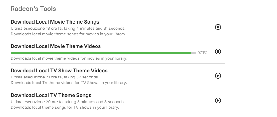

ReneSav 1 Posted April 27, 2025 Posted April 27, 2025 does not reach the end of the download activity..reaches up to 97.1% and remains stationary
Luke 42250 Posted April 27, 2025 Posted April 27, 2025 Hi, I think I would just be patient and give it time to finish. Maybe it's just taking a long time. I will move this posting into the topic for the plugin to ensure that the developer sees it . Thanks. 1
radeon 760 Posted April 27, 2025 Author Posted April 27, 2025 Give it time. You're likely throttled if you've hit it hard. Other thing to do if you want to try would be to disabled audio normalisation and rerun as it might be your system wing hit hard by all the ffmpeg requests
Nexusei 0 Posted May 3, 2025 Posted May 3, 2025 Hi Radeon, unfortunately I have not solved the problem (I have not found where to remove the audio normalization), but I have done several tests, I have not added films or used emby so that it has all the resources available. The result is that the video download stops at 95% even for 10 hours... as if it encounters an error and goes into a loop... for audio downloads and video series everything is ok
Painkiller88 250 Posted May 3, 2025 Posted May 3, 2025 (edited) @radeonHi, just a quick question or an idea, maybe you could put the movies in the plugin section into a collapsable object. actually i have to scroll down over 6K movies to get to the settings Just an option for people with many movies. Thanks for your great work Edited May 3, 2025 by Painkiller8818 1
radeon 760 Posted May 4, 2025 Author Posted May 4, 2025 On 03/05/2025 at 04:56, Nexusei said: Hi Radeon, unfortunately I have not solved the problem (I have not found where to remove the audio normalization), but I have done several tests, I have not added films or used emby so that it has all the resources available. The result is that the video download stops at 95% even for 10 hours... as if it encounters an error and goes into a loop... for audio downloads and video series everything is ok Audio normalisation is within the plugins options. Find the plugin and you'll have an option for audio normalisation. Turn it off, hit save and run up the plugin. Otherwise I'll need a debug log to see where it's stalling.
ReneSav 1 Posted May 4, 2025 Posted May 4, 2025 I disabled normalization and in 15 minutes it finished the process. So should I leave it disabled or do I occasionally try again to see if it works again? In the meantime, thanks for the support Rene'
radeon 760 Posted May 4, 2025 Author Posted May 4, 2025 It's not really required these days as the majority of themes are already normalised server side. It was an early days feature that some original users still use. If you're finding the volumes are ok then just leave it off. Glad you're sorted! 1
