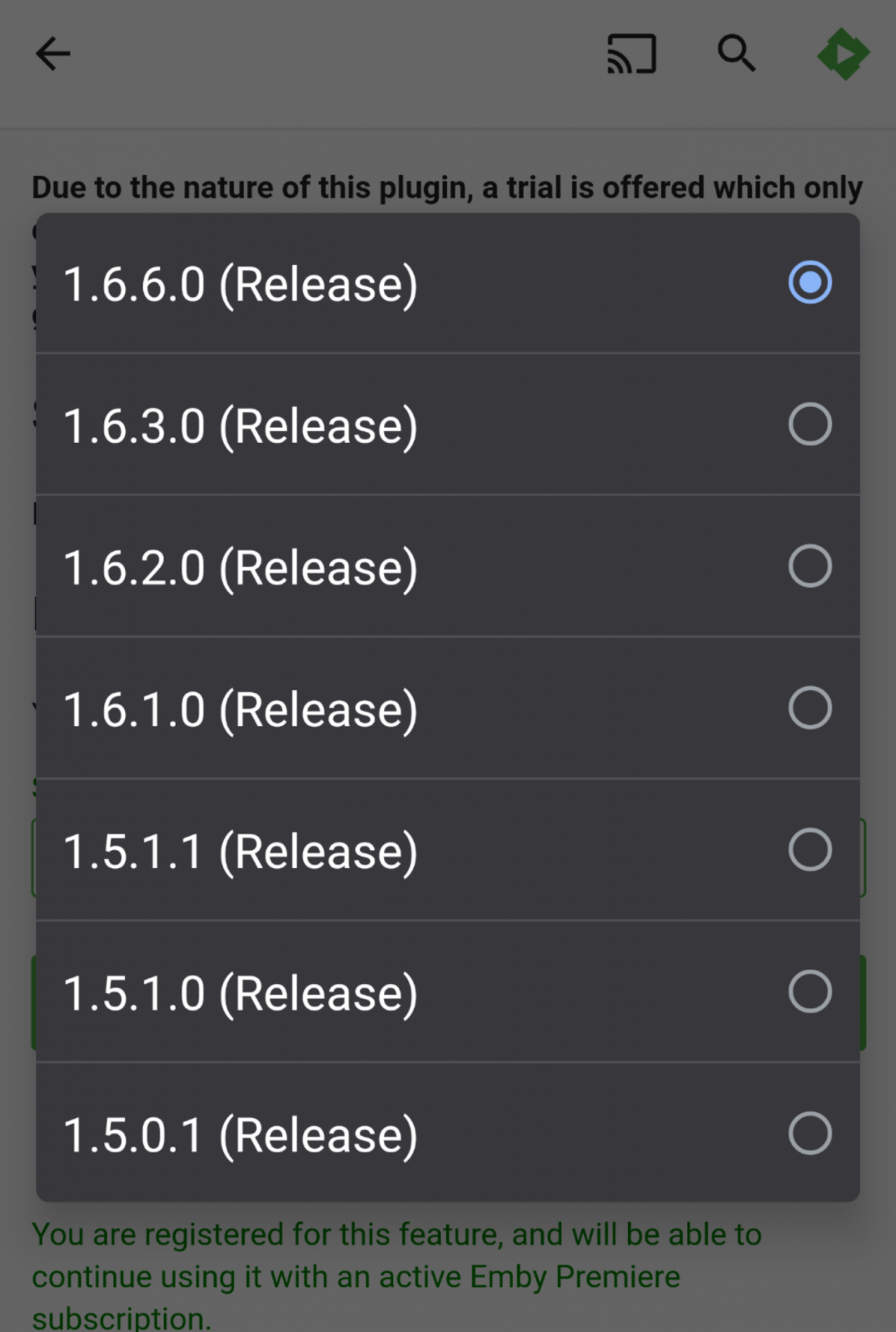

soloam 3 Posted December 10, 2019 Posted December 10, 2019 I only can see the 1.6.6.0 (Release) and bellow, 1.6.3.0... Etc, nothing dev! What I'm missing? Thank you
radeon 760 Posted December 10, 2019 Author Posted December 10, 2019 I only can see the 1.6.6.0 (Release) and bellow, 1.6.3.0... Etc, nothing dev! What I'm missing? Thank you You should have a 1.6.6.6 for movie theme videos. Only the movie theme videos though
soloam 3 Posted December 10, 2019 Posted December 10, 2019 (edited) I only have this options! I tried to reboot the server, and I only can see this! I'm running emby server 4.2.1.0, is this the reason? I tried updating to the latest version, but I was having a error on the streaming that I was not able to solve and rolled back! Edited December 10, 2019 by soloam
radeon 760 Posted December 10, 2019 Author Posted December 10, 2019 Yeah, that'll be why. You need 4.3 to get the latest release of my plugin. I can probably reduce that though
