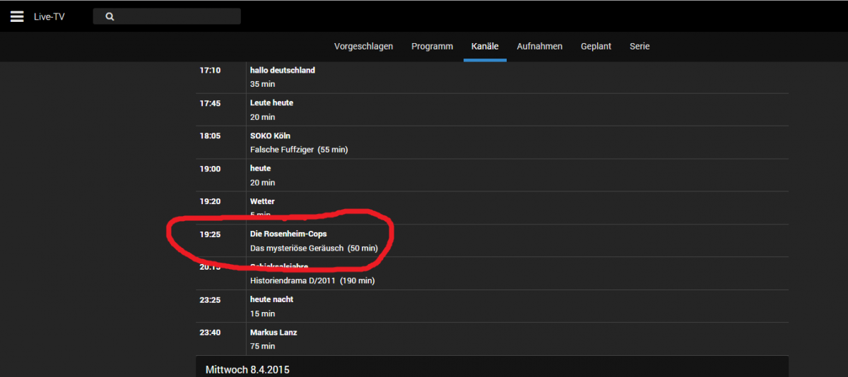

Hi,
I add a ProgramInfo with the following data:

This entry is not shown in the EPG table.
Any idea why?
Yours Tolotos

Most of the EPG entries are correct but a few are missing complete (holes in the time line).
EDIT: It must be an error in Emby. In the timeline of the according tv-channel the entry is displayed - only in the EPG view it is missing. See attached screenshots.
Yours Tolotos
Edited by Tolotos
it's an old bug, remember it from about a year back. When you click channel you get full epg, while the timeline is missing several because it only shows 30 minute blocks.
