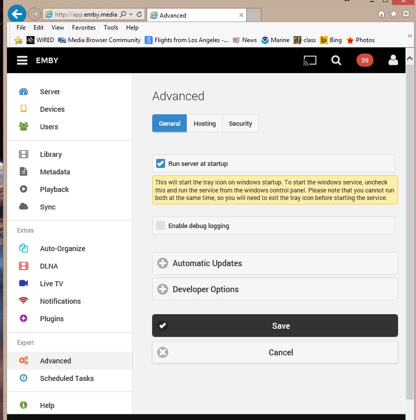

lang-server 2 Posted April 5, 2015 Posted April 5, 2015 (edited) Everything is looking good, but I still think it's a user connection error. Frostbyte is correct on the service issue. Sorry, if this sounds remedial, but I attached an image of the emby server "advanced" screen. Does your server have the entry "checked" "run server at startup"? At least we can eliminate or not the "service" issue. Edited April 5, 2015 by lang-server
HDJedi 2 Posted April 5, 2015 Author Posted April 5, 2015 (edited) Everything is looking good, but I still think it's a user connection error. Frostbyte is correct on the service issue. Sorry, if this sounds remedial, but I attached an image of the emby server "advanced" screen. Does your server have the entry "checked" "run server at startup"? At least we can eliminate or not the "service" issue. Check box was unchecked. Checked the box and rebooted. Suddenly Media Browser reinstalled itself. Note media Browser not EMBY installed. Anyway the ability to add homeserver folders came back too so I setup a few media folders. Unfortunately within Media Centre when I click the Media Browser icon it says.. cannot find server make sure it is running. Checked, It is running and in taskbar. Trying to restart the server gives the error in the attached photo. I will try to reinstall EMBY and see what happens. Have to wait until the HTPC is free again :-) Edited April 5, 2015 by HDJedi
ebr 16354 Posted April 5, 2015 Posted April 5, 2015 If you run as a service, you don't want to check that box because then you will have two of them running.
HDJedi 2 Posted April 5, 2015 Author Posted April 5, 2015 If you run as a service, you don't want to check that box because then you will have two of them running. I assume if I check the box then after a reboot it wont run as a service anymore. Is that not right?
lang-server 2 Posted April 5, 2015 Posted April 5, 2015 Just a clarification for me, wouldn't a restart of the server computer (not just a server restart) using the new server settings NOT start the service with the box checked?
ebr 16354 Posted April 5, 2015 Posted April 5, 2015 Just a clarification for me, wouldn't a restart of the server computer (not just a server restart) using the new server settings NOT start the service with the box checked? It depends. If you setup the service to start automatically, then it will start.
lang-server 2 Posted April 5, 2015 Posted April 5, 2015 So you saying, if one "checks" the startup box, emby wouldn't change the "emby service" to manual, and vice versa and unchecked box will not change the service to automatic. The whole service startup needs to be altered by the end-user.
ebr 16354 Posted April 5, 2015 Posted April 5, 2015 Correct. The app doesn't necessarily have proper authority to modify your system level service settings. Running as a service is considered an advanced feature only for people who are familiar with setting them up and managing them manually. There is an explanation of this under the checkbox.
lang-server 2 Posted April 5, 2015 Posted April 5, 2015 (edited) Hence, being an advanced feature, shouldn't the default be "start emby on startup". Eliminating the confusion for first time users. This user, I assume just started the application and didn't realize that without checking the box, MB3 was starting as a service. Edited April 5, 2015 by lang-server 1
