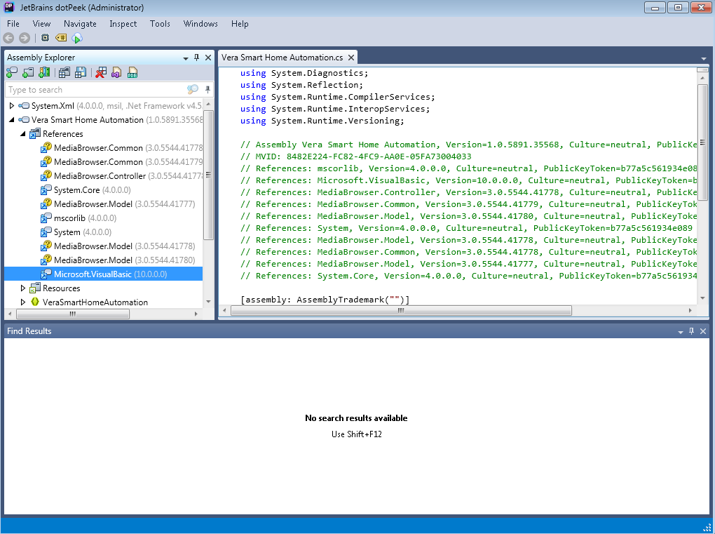

GlennNZ 92 Posted February 18, 2016 Posted February 18, 2016 (edited) Check out DotPeek .net Dll Reviewer -https://d1opms6zj7jotq.cloudfront.net/resharper/dotPeek32_10.0.2.exe (Free) As Below on new Dll (as above) shows VisualBasic Reference still there? (and it has a find usages - check - with shows 5 usages in AssemblyReference - debug) Edited February 18, 2016 by GlennNZ
chef 3811 Posted February 18, 2016 Author Posted February 18, 2016 (edited) I am starting to hate VisualBasic. The Compiler will always grab the reference when building the DLL. Even If I use a Command Line with MSBUILD. I'm afraid that we might have to accept that this plugin won't be cross platform in the state it is in. VB.net wasn't a good choice of languages to use. Edited February 18, 2016 by chef
