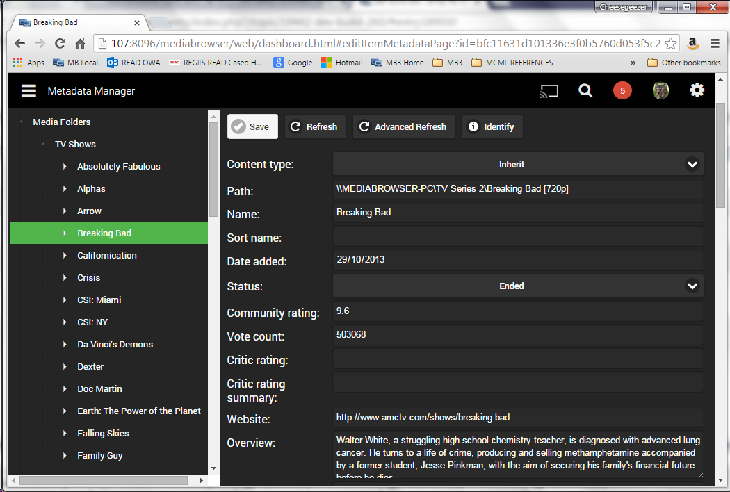

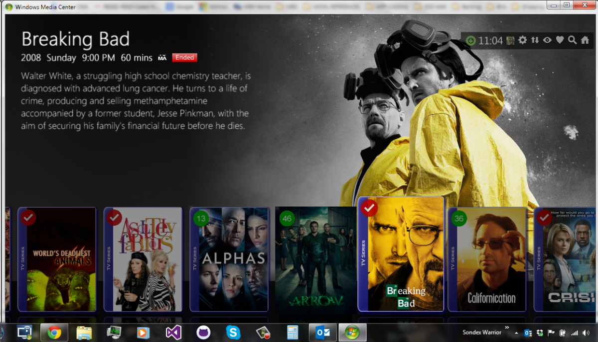

Cheesegeezer 3106 Posted March 24, 2015 Posted March 24, 2015 Which ratings have we added here just to be clear Item.imdbrating item.criticrating item.mpaa Nothing is showing up for me.
ebr 16334 Posted March 24, 2015 Author Posted March 24, 2015 I filled in ImdbRating and CriticRating for Series (which weren't before). Mpaa/Official should have already been there. CriticRating is probably not going to exist for TV series but I confirmed with the debugger that ImdbRating is being filled in.
Cheesegeezer 3106 Posted March 25, 2015 Posted March 25, 2015 (edited) I filled in ImdbRating and CriticRating for Series (which weren't before). Mpaa/Official should have already been there. CriticRating is probably not going to exist for TV series but I confirmed with the debugger that ImdbRating is being filled in. Ok, that's what I thought. I may just have to recheck my code as i can't see it. Thanks for the info. Do you have a good site to go for on debugging in mcml as the ones i've found are very convoluted. EDIT: @@BeppoMonkeyBoy can you also confirm this or not Just to confirm... This is not working using the Gospel Theme, also tried square, subdued, xenon, Iridium, classic Metadata Chocolate Edited March 25, 2015 by Cheesegeezer
ebr 16334 Posted March 25, 2015 Author Posted March 25, 2015 What I confirmed was that the value was being filled in at the c# level and it is. I assumed those themes were just not showing the field for Series but I'll have a look and see if there is something else in play.
ebr 16334 Posted March 25, 2015 Author Posted March 25, 2015 Yep, there was other code in the core that was blocking that value for series. Got it for next version.

Cheesegeezer 3106 Posted March 25, 2015 Posted March 25, 2015 Not tested the new build but will at some point tomorrow, the previous build it wasn't working but embedded mediainfo was working fine. Beppo it's working fine in 261. Just grab the [item.ImdbRating] to populate you scores or stars and what ever tier the TV Show is in it will grab and populate, so even if you had Season Scores it would do it for them too.
