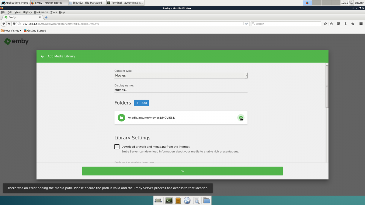

morpheus1 2 Posted January 31, 2017 Posted January 31, 2017 Installation Instructions See http://emby.media/download @@Luke, thanks for your real hard work on this project. I'm yet to enjoy its juices. Lots of friends are enjoying it. My latest problem, I decided to remove OMV and set up a vanilla server using Debian 8 as the base. So far so good, until it's time to add media folders and Emby would not do it. I've read up on this and lots of people with just as many solutions. I read your post here: https://github.com/MediaBrowser/Wiki/wiki/Library%20Setup But unfortunately, even though this is a recognized problem, that did not mention how one can resolve the issue of adding media folders to emby. I deeply appreciate that you mention emby has to be given, at least, read access. But you know what, I don't know how to do this. Perhaps you could help. Or, better, perhaps future releases of emby would make this issue absolete. It seems a very common problem. And truly, some of the hacks out there, up until this year, are just nuts! I thank you, dearly.
Luke 42242 Posted January 31, 2017 Author Posted January 31, 2017 Hi @@morpheus1, the mono runtime does not natively support unc network paths so what you need to do is mount the path locally within Debian and then add the mounted local path to Emby. 1
morpheus1 2 Posted January 31, 2017 Posted January 31, 2017 Hi @@morpheus1, the mono runtime does not natively support unc network paths so what you need to do is mount the path locally within Debian and then add the mounted local path to Emby. @@Luke. You really are great. I thank you. You encourage me to stick with emby. And as I read about it in Linux Format, I'm sticking it out as well because it's pure open source. Here's what I've done. I added the drives to fstab, using uuid (UUID /mountpoint/ ext4 /defaults 0 0) The label of the disk is movies1 and the folder with the data is MOVIES1 This means they're auto mounted on boot. Once mounted, I then click on them to open the folders on them to get to the folder with data. Then I copied the complete directory path from the File Manger, open emby on the browser and then added that path as seen on the picture. And then hit "OK". This is what I understood by what you asked me to do, which to me makes sense than the loads of solutions I read on the forum. As you would see below, the result is not good, as seen in the same picture. I am out of ideas. Can I encourage you to see if I you can find a way around mono to make this part much efficient, as virtually everyone using emby on linux would have to solve this problem. And that's not a good thing. When I had OMV, I did not have to deal with it like this, so perhaps that's an idea. Anyway, I'm waiting and being patient and thankful for your help. Can you say when next you expect the release that settles the profile issue for the WD Plus box. I look forward to your response in proceeding. Can I also make clear that the hard drives are not off a server. They are physically attached to the machine.
morpheus1 2 Posted February 1, 2017 Posted February 1, 2017 @@Luke. You really are great. I thank you. You encourage me to stick with emby. And as I read about it in Linux Format, I'm sticking it out as well because it's pure open source. Here's what I've done. I added the drives to fstab, using uuid (UUID /mountpoint/ ext4 /defaults 0 0) The label of the disk is movies1 and the folder with the data is MOVIES1 This means they're auto mounted on boot. Once mounted, I then click on them to open the folders on them to get to the folder with data. Then I copied the complete directory path from the File Manger, open emby on the browser and then added that path as seen on the picture. And then hit "OK". This is what I understood by what you asked me to do, which to me makes sense than the loads of solutions I read on the forum. As you would see below, the result is not good, as seen in the same picture. I am out of ideas. Can I encourage you to see if I you can find a way around mono to make this part much efficient, as virtually everyone using emby on linux would have to solve this problem. And that's not a good thing. When I had OMV, I did not have to deal with it like this, so perhaps that's an idea. Anyway, I'm waiting and being patient and thankful for your help. Can you say when next you expect the release that settles the profile issue for the WD Plus box. I look forward to your response in proceeding. Can I also make clear that the hard drives are not off a server. They are physically attached to the machine. @@Luke have we reached a deadend on this?
