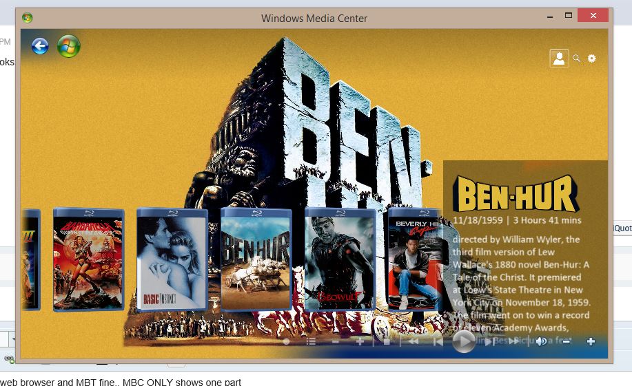

lang-server 2 Posted March 15, 2015 Author Posted March 15, 2015 (edited) Oops, wrong information... I have been testing this numerous ways and mixed up the results. As stated above, with using the stack feature, web browser looks good. MBC and MBT ONLY shows (1) movie. When I select the movie, there is no option for the second part? Edited March 15, 2015 by lang-server
FrostByte 5464 Posted March 15, 2015 Posted March 15, 2015 I also bought and ripped Ben-Hur from BD recently and noticed your pics show the total time for both parts. Have you tried playing it to see if it maybe plays both though only shows it as one? The app I use doesn't support multi disk movies yet so I ended up using mkvmerge and appended both into one mkv. Worked very well and you can select chapters from the whole movie which I don't believe you could in the webclient
lang-server 2 Posted March 15, 2015 Author Posted March 15, 2015 The total time comes from the metadata, not the actually disk(s), in fact there is only one (1) metadata entry.. And no, it doesn't play both parts as one. I have used mkvmerge, but wanted to see if the new mediabrowser with stacking would work.

lang-server 2 Posted March 18, 2015 Author Posted March 18, 2015 Never mind... The multiple part structure is "playing" perfectly in MBC.. I had too many different tests running and failed to notice when it actually worked. Final: Use the stack option: \movies\ben-hur (1959)\Ben-hur (1959)-part1.mkv \movies\ben-hur (1959)\Ben-hur (1959)-part2.mkv MBC will only show the first parts chapters, on the detail screen. However during playback, when it reaches the end of part 1, it will indeed automatically start playing the second part. This is using an external player MPC-HC. This at least for me, eliminates the need to use MKVmerge.
