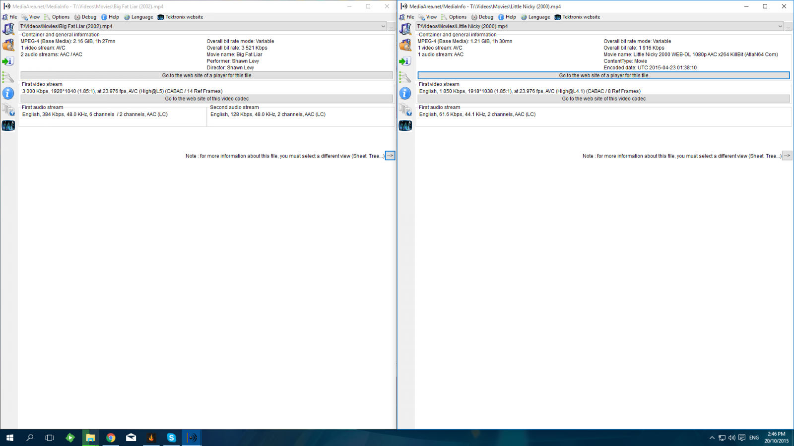

strugglez 8 Posted October 20, 2015 Posted October 20, 2015 Heya FrostByteI am indeed using the stable version on both TV's (V 0.593). I also did indeed mean DLNA from within the server. I use Windows 10 and have managed to cast it to both TV's perfectly, I'll try find my USB stick and try playing them directly through that. As far as I can tell, the media isn't any different from the rest in terms of codecs and containers. It transcodes fine through Plex but doesn't seem to want to with Emby. I don't know how to crop a sample of the file without altering it's format etc. unless you could guide me on how to do so (most software I imagine re-encodes).Here's some screen shots of the 2 files in question with mediainfo.
FrostByte 5453 Posted October 20, 2015 Posted October 20, 2015 (edited) Could you possibly change the mediainfo to something like html under View and repost? I usually can't see everything using that view. Just by looking at that view though I can see that your file on the left is High Level 5. If you look in the back of your user's manual for your F series tv there should be a chart of supported containers and codecs, etc. Under that chart there is also a few paragraphs of more information of supported files. My F series tv only supports files up to High Level 4.1 and I'm pretty sure all F series devices are the same. Sometimes you can fool the tv by just changing the header info within your file to level 4.1 Not sure if the Emby app is checking for the Level, or even if it's checking for High, High10, etc. It might not be, so it may be streaming the file and when the tv sees it then it can't play. The app does for sure check things like bitrate, audio channels, codecs, etc that are in the chart With that second file, I'm not 100% but it's possible that it isn't playing because of the number of reference frames? Not sure though. Level 4.1 only supports 4 ref frames at that resolution. Playing the files from USB using Samsung's built in media app should tell you if they can't be played without transcoding. If they don't work using that, then they have to be transcoded on the fly or reencoded by you If you haven't already then maybe have a look at the "TV Settings" in the Emby app. There is one for AAC and another for transcoding with D series devices which may help you with the one TV and are off by default I think https://forum.handbrake.fr/download/file.php?id=49&sid=f2cee6fbc8a278b439d627190bd4bd9f&mode=view Edited October 20, 2015 by FrostByte
strugglez 8 Posted October 20, 2015 Posted October 20, 2015 Here you go! General Complete name : T:\Videos\Movies\Big Fat Liar (2002).mp4 Format : MPEG-4 Format profile : Base Media Codec ID : isom File size : 2.16 GiB Duration : 1h 27mn Overall bit rate mode : Variable Overall bit rate : 3 521 Kbps Movie name : Big Fat Liar Performer : Shawn Levy Director : Shawn Levy Actor : Frankie Muniz / Paul Giamatti / Amanda Bynes / Lee Majors / Amanda Detmer / Donald Faison / Sandra Oh / John Cho Producer : Mike Tollin / Brian Robbins Genre : Comedy ContentType : Short Film Recorded date : 2002 Encoded date : UTC 2014-11-24 04:17:35 Tagged date : UTC 2014-11-24 04:25:01 Cover : Yes ContentRating : mpaa|PG|200| LongDescription : After a young boy's school essay erroneously finds its way into the hands of a Hollywood producer who turns the idea into a hit film, the boy travels to Los Angeles to claim his credit. Video ID : 1 Format : AVC Format/Info : Advanced Video Codec Format profile : High@L5 Format settings, CABAC : Yes Format settings, ReFrames : 14 frames Codec ID : avc1 Codec ID/Info : Advanced Video Coding Duration : 1h 27mn Bit rate : 3 000 Kbps Maximum bit rate : 13.2 Mbps Width : 1 920 pixels Height : 1 040 pixels Display aspect ratio : 1.85:1 Frame rate mode : Constant Frame rate : 23.976 fps Color space : YUV Chroma subsampling : 4:2:0 Bit depth : 8 bits Scan type : Progressive Bits/(Pixel*Frame) : 0.063 Stream size : 1.84 GiB (85%) Writing library : x264 core 130 r2273 b3065e6 Encoding settings : cabac=1 / ref=14 / deblock=1:-1:-1 / analyse=0x3:0x113 / me=umh / subme=10 / psy=1 / psy_rd=1.00:0.15 / mixed_ref=1 / me_range=32 / chroma_me=1 / trellis=2 / 8x8dct=1 / cqm=0 / deadzone=21,11 / fast_pskip=1 / chroma_qp_offset=-3 / threads=6 / lookahead_threads=1 / sliced_threads=0 / nr=0 / decimate=1 / interlaced=0 / bluray_compat=0 / constrained_intra=0 / bframes=16 / b_pyramid=2 / b_adapt=2 / b_bias=0 / direct=3 / weightb=1 / open_gop=0 / weightp=2 / keyint=240 / keyint_min=24 / scenecut=40 / intra_refresh=0 / rc_lookahead=60 / rc=2pass / mbtree=1 / bitrate=3000 / ratetol=1.0 / qcomp=0.60 / qpmin=0 / qpmax=69 / qpstep=4 / cplxblur=20.0 / qblur=0.5 / ip_ratio=1.40 / aq=1:1.00 Encoded date : UTC 2014-11-24 04:17:35 Tagged date : UTC 2014-11-24 04:18:07 Color range : Limited Color primaries : BT.709 Transfer characteristics : BT.709 Matrix coefficients : BT.709 Audio #1 ID : 2 Format : AAC Format/Info : Advanced Audio Codec Format profile : LC Codec ID : 40 Duration : 1h 27mn Source duration : 1h 27mn Bit rate mode : Variable Bit rate : 384 Kbps Maximum bit rate : 460 Kbps Channel(s) : 2 channels Channel(s)_Original : 6 channels Channel positions : Front: L C R, Side: L R, LFE Sampling rate : 48.0 KHz Compression mode : Lossy Stream size : 241 MiB (11%) Source stream size : 241 MiB (11%) Language : English Tagged date : UTC 2014-11-24 04:18:07 Audio #2 ID : 3 Format : AAC Format/Info : Advanced Audio Codec Format profile : LC Codec ID : 40 Duration : 1h 27mn Bit rate mode : Variable Bit rate : 128 Kbps Maximum bit rate : 233 Kbps Channel(s) : 2 channels Channel positions : Front: L R Sampling rate : 48.0 KHz Compression mode : Lossy Stream size : 80.2 MiB (4%) Language : English Encoded date : UTC 2014-11-24 04:18:04 Tagged date : UTC 2014-11-24 04:18:07 General Complete name : T:\Videos\Movies\Little Nicky (2000).mp4 Format : MPEG-4 Format profile : Base Media Codec ID : isom File size : 1.21 GiB Duration : 1h 30mn Overall bit rate mode : Variable Overall bit rate : 1 916 Kbps Movie name : Little Nicky 2000 WEB-DL 1080p AAC x264 KillBit (AtlaN64 Com) ContentType : Movie Encoded date : UTC 2015-04-23 01:38:10 Tagged date : UTC 2015-04-23 01:38:31 Writing application : MkvToMp4 [www.mkvtomp4.ru] version: 0.224 (x64) Video ID : 1 Format : AVC Format/Info : Advanced Video Codec Format profile : High@L4.1 Format settings, CABAC : Yes Format settings, ReFrames : 8 frames Codec ID : avc1 Codec ID/Info : Advanced Video Coding Duration : 1h 30mn Bit rate : 1 850 Kbps Maximum bit rate : 9 669 Kbps Width : 1 918 pixels Height : 1 038 pixels Display aspect ratio : 1.85:1 Frame rate mode : Constant Frame rate : 23.976 fps Color space : YUV Chroma subsampling : 4:2:0 Bit depth : 8 bits Scan type : Progressive Bits/(Pixel*Frame) : 0.039 Stream size : 1.16 GiB (96%) Writing library : x264 core 138 r2358 9e941d1 Encoding settings : cabac=1 / ref=9 / deblock=1:-2:-1 / analyse=0x3:0x133 / me=umh / subme=9 / psy=1 / psy_rd=0.90:0.02 / mixed_ref=1 / me_range=24 / chroma_me=1 / trellis=2 / 8x8dct=1 / cqm=0 / deadzone=21,11 / fast_pskip=0 / chroma_qp_offset=-3 / threads=12 / lookahead_threads=1 / sliced_threads=0 / nr=0 / decimate=1 / interlaced=0 / bluray_compat=0 / constrained_intra=0 / bframes=6 / b_pyramid=1 / b_adapt=2 / b_bias=0 / direct=3 / weightb=1 / open_gop=0 / weightp=2 / keyint=240 / keyint_min=23 / scenecut=40 / intra_refresh=0 / rc_lookahead=60 / rc=2pass / mbtree=1 / bitrate=1850 / ratetol=2.0 / qcomp=0.60 / qpmin=0 / qpmax=69 / qpstep=4 / cplxblur=20.0 / qblur=0.5 / vbv_maxrate=14000 / vbv_bufsize=14500 / nal_hrd=none / ip_ratio=1.40 / aq=1:1.00 Language : English Encoded date : UTC 2015-04-23 01:38:10 Tagged date : UTC 2015-04-23 01:38:22 Audio ID : 2 Format : AAC Format/Info : Advanced Audio Codec Format profile : LC Codec ID : 40 Duration : 1h 30mn Bit rate mode : Variable Bit rate : 61.6 Kbps Maximum bit rate : 104 Kbps Channel(s) : 2 channels Channel positions : Front: L R Sampling rate : 44.1 KHz Compression mode : Lossy Stream size : 39.8 MiB (3%) Language : English Encoded date : UTC 2015-04-23 01:38:19 Tagged date : UTC 2015-04-23 01:38:22 I've mucked around with those settings with no luck. I understand that my TV probably isn't capable of direct playing or streaming those files, but I was wondering more or less why they still didn't play because everything else that isn't directly played or streamed, is transcoded without a problem. It's just those 2 that seem to be the problem. They do however transcode with plex. So yea, is it the files I should just delete or re-encode, or is it an actual Emby problem trandcoding too?
