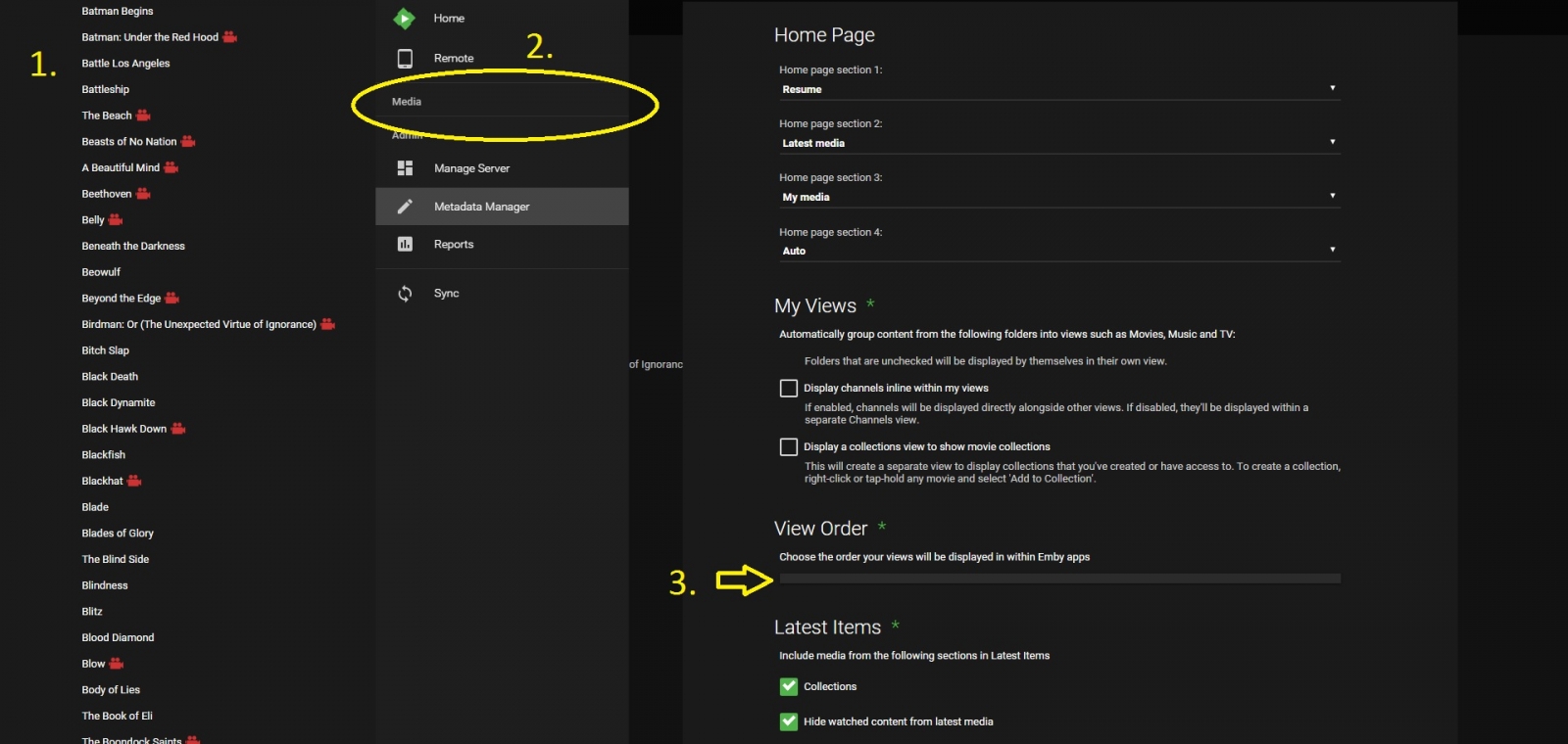

pmac 143 Posted February 24, 2016 Author Posted February 24, 2016 My library scan has completed, and I restarted the server just to make sure, but now I'm having a strange issue: All of my media shows up in the metadata manager, and my media folders are correct in the server settings, but my libraries don't show up in ET or in the web client. The media section is just blank. So I have no way of watching any of my media. Any ideas?

pmac 143 Posted February 24, 2016 Author Posted February 24, 2016 can you show screenshots that demonstrate the issue? 1.) Metadata editor shows all media/metadata for everything in my libraries. 2.) "Media" section in Web client is empty. 3.) Can't adjust views because media folders are not showing up in Web Client (other than in metadata editor) My Media Libraries are linked to the correct folders using a UNC network path, and the folders are shared (I confirmed this by Copy/Pasting the full path as written in the Emby Server into Windows explorer, and it linked to the correct folder).
Solution Luke 42186 Posted February 24, 2016 Solution Posted February 24, 2016 double check user access. if that doesn't help then provide the server log http://emby.media/community/index.php?/topic/739-how-to-report-a-problem/ 1
pmac 143 Posted February 24, 2016 Author Posted February 24, 2016 Thanks! I didn't have access to my libraries for some reason. Fixed now though!
