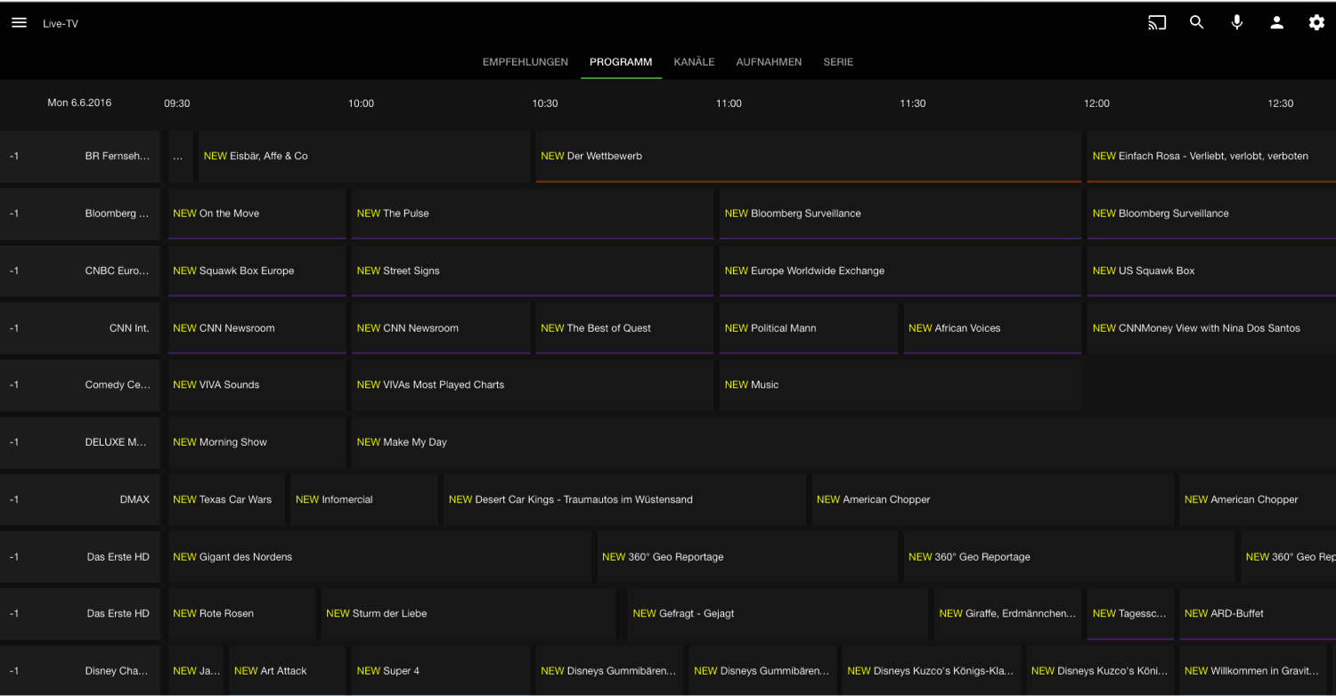

Michael_Schmitz 7 Posted June 6, 2016 Posted June 6, 2016 Hi, I am currently unhappy with the display of the channels in emby. I upgaded on DVB-Link 6 and using newest Plugin. still there is no transfer of channel numbers from DVB-LINk Server to emby via the live plugin. Apart from that it has problem with some cannel names. In DVB-LInk the channel numbers and the sorting are displayed correctly. Enclosed find a screenshot:

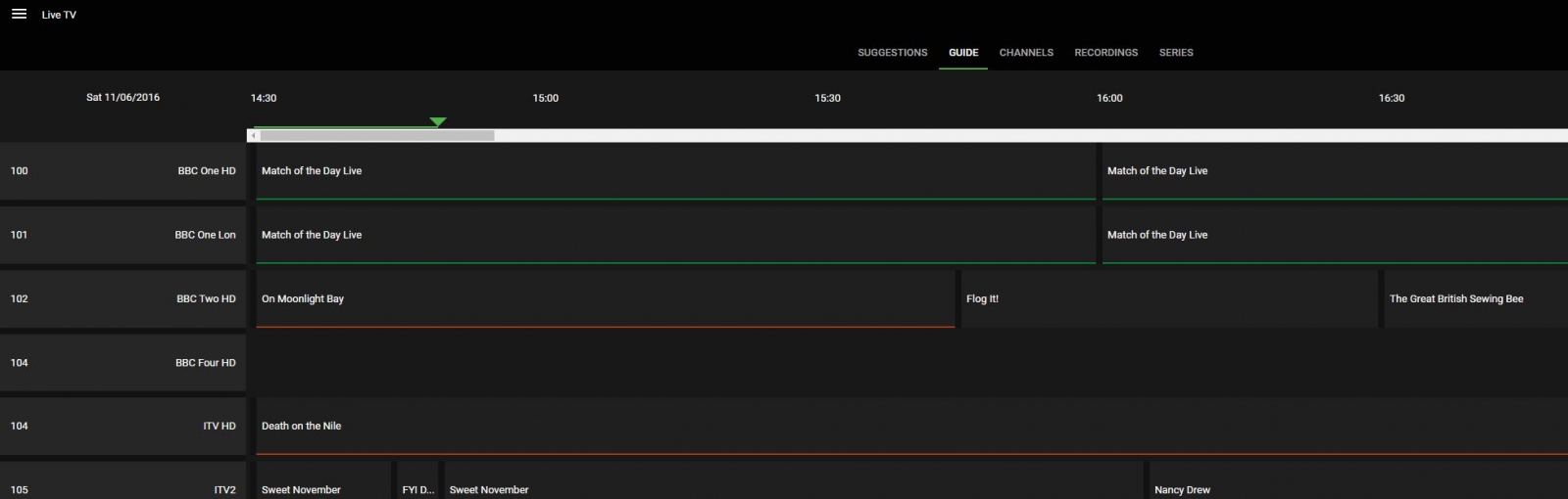

Spaceboy 2573 Posted June 11, 2016 Posted June 11, 2016 (edited) hi @@Michael_Schmitz i don't see the same problem as you, in fact i have always had channel numbers properly transferred to emby. i just came here to request support for native tv logos in dvblink which has been added in 6.0 and is very easy to configure. is this possible @t.andre ? Edited June 11, 2016 by Spaceboy
