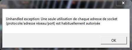

zzdez 3 Posted October 31, 2013 Author Posted October 31, 2013 Thank you, I have made exactly what you say, but the service won’t start (I have tried few reboot). When I go to services and try to manually start the Media Browser service, I have a 1053 error. I have no Media Browser icon in the taskbar and if I run the program manually I have the same error as before (see the snapshot I have joined). If I let the error message open and don’t click on the OK button the server continue working, but if I click OK on the error message, the server stops working and the Media Browser task bar icon disappears. I hope I’m clear. I’m not a newbie on MCE. My site www.media-center7.fr is the biggest MCE French site and I have made few articles about older versions of Media Browser...But here, I don't understand what’s wrong. Thank you server-63518839561.zip
mboehler 94 Posted October 31, 2013 Posted October 31, 2013 Make sure Media Browser Server is not already running as an application when you try to start the Service.
zzdez 3 Posted November 1, 2013 Author Posted November 1, 2013 I verified that MediaBrowser are not in the process before try to run again the MB service, but same thing as explained above: Error 1053. Media Browser works only when I run the app and don’t click OK on the error message…Very strange !

zzdez 3 Posted November 10, 2013 Author Posted November 10, 2013 Hi Thilo... After many tests and searches, I have finally found the program that causes the socket issue. It was a plugin called “MaConfig.com” that is used by a site to find drivers (touslesdrivers.com). If anyone has the same issue, just uninstall it in the windows uninstall panel. 3
