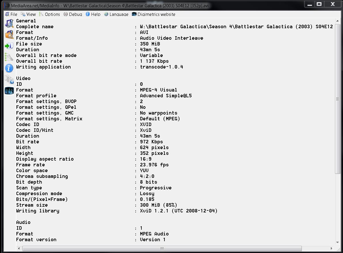

blakeusblade 4 Posted January 3, 2015 Author Posted January 3, 2015 Hi Administrators, I've completed Hi Administrators, Standby... Attempting to The attached screenshot is of MediaArea.net/MediaInfo interrogating a video file that MediaBrowser was working on at a time of a crash. All appears fine. I'm not sure if its of any help, MetaBrowser also uses MediaInfo to interrogate the media files and appears to be working fine.
Luke 42184 Posted January 3, 2015 Posted January 3, 2015 can you provide a sample file on something like dropbox?
blakeusblade 4 Posted January 4, 2015 Author Posted January 4, 2015 Hi Administrators, Uploading now........ Standby
blakeusblade 4 Posted January 4, 2015 Author Posted January 4, 2015 Hi Administrators, Please find the complete file here https://www.dropbox.com/s/ayporn2hnkqqbq1/Battlestar%20Galactica%20%282003%29%20S04E12%20%5B352p%5D.avi?dl=0 I've had to upload the whole file. If I was to provide an edited small sample file, it would introduce another variable which may produce a different result. This file is one of the files that Media Browser was in the process of or was the last file scanning when Media Browser crashes.
