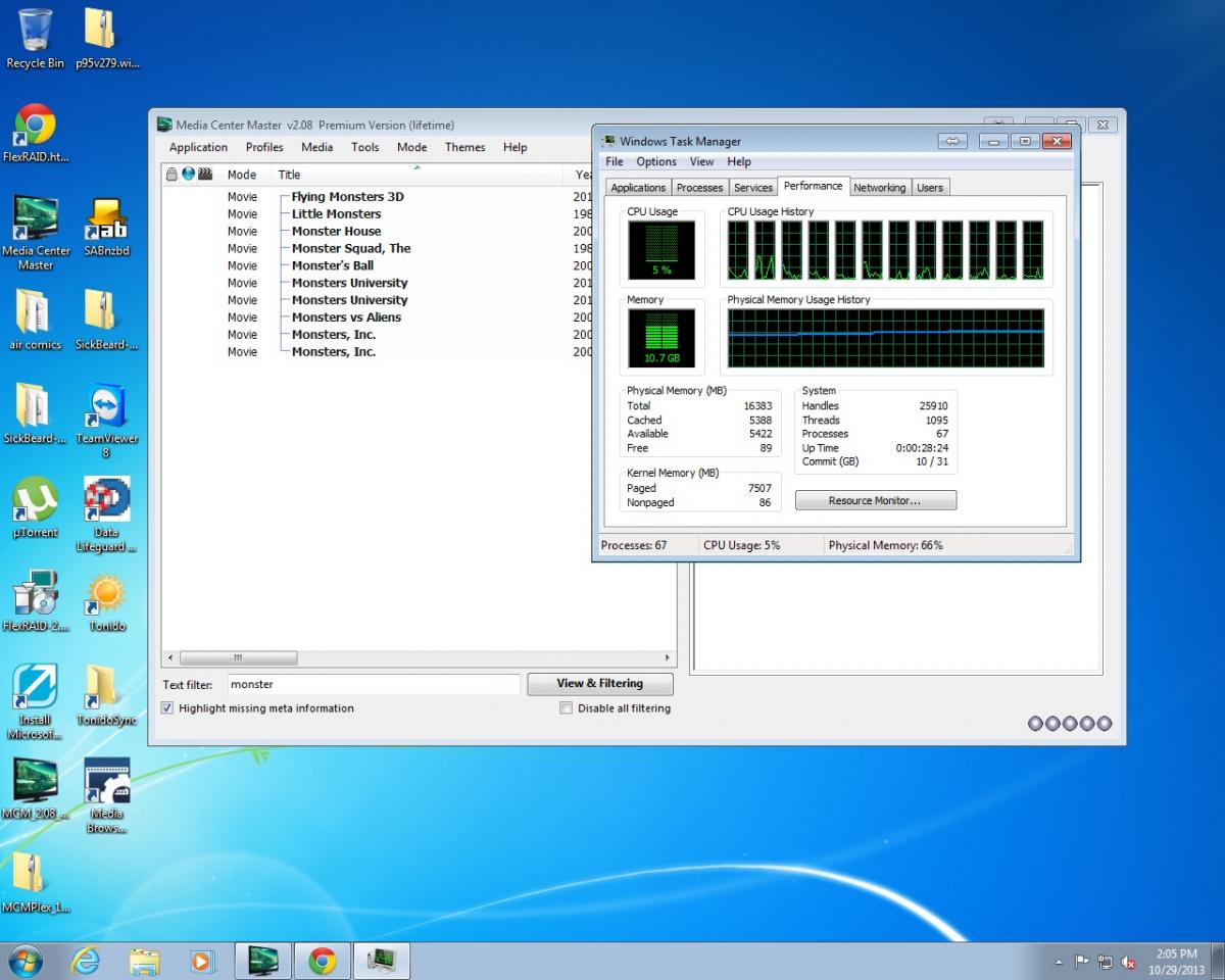

ebr 16354 Posted October 29, 2013 Posted October 29, 2013 Does it come back down when the scan is over?
wraslor 70 Posted October 29, 2013 Posted October 29, 2013 No it stays high, even if I kill the process.
ebr 16354 Posted October 29, 2013 Author Posted October 29, 2013 No it stays high, even if I kill the process. How can our use of memory stay high if you kill our process?
Della Dog 19 Posted October 30, 2013 Posted October 30, 2013 (edited) How can our use of memory stay high if you kill our process? Current process (task maybe) not killing children? http://stackoverflow.com/questions/3342941/kill-child-process-when-parent-process-is-killed Edited October 29, 2013 by pdcinc
Luke 42288 Posted October 30, 2013 Posted October 30, 2013 An application releasing memory, and the operating system putting it back into the available pool are two completely separate events.

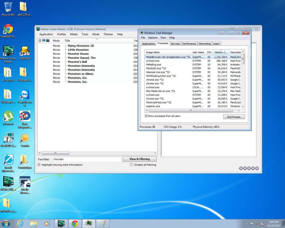

wraslor 70 Posted October 30, 2013 Posted October 30, 2013 I'm having an issue with the server when it runs the media scan. I usually sit around 2-3gb of memory in use and I see MB just start sky rocketing all the way to just under my system ram of 16gb. Right now for example it's scanning and I'm showing just under 9 gigs in use, granted in task manager mb server app shows 1,307,992k (highest memory use by far of anything else) and climbing steadily. I can run the computer for days without mb server running and it will sit at 2-3gb depending on what's going on but once I run mb server and it kicks off a scan memory utilization starts climbing to the roof. Any ideas? What would be the best way to log this to give you guys more information? 1
Luke 42288 Posted October 30, 2013 Posted October 30, 2013 this affects a small number of people. one of the next two server releases will bring our memory usage down. 2
ebr 16354 Posted October 30, 2013 Author Posted October 30, 2013 Yeah, the system only goes to re-claim memory when it needs to so watching task manager isn't always accurate. But, I was confused by the statement of "it stays high" when you kill our process. 1) what is "it" because if we are gone, we wouldn't display in task manager for you to see any memory associated with us 2) when you say "kill the process" do you mean actually kill it in task manager? Why would you do that as opposed to just shutting down the server?
wraslor 70 Posted October 30, 2013 Posted October 30, 2013 by it stays high I mean that in task manager the memory usage stays close to max and will drop slightly when I kill the process in task manager. IE using 14gb of memory, kill process now using 13.8. Same story if i just exit the server app. The only time i've seen behavior like this is from a memory leak thus the OS not reclaiming the memory and it showing in use. Let me know if I can get you any more information.
