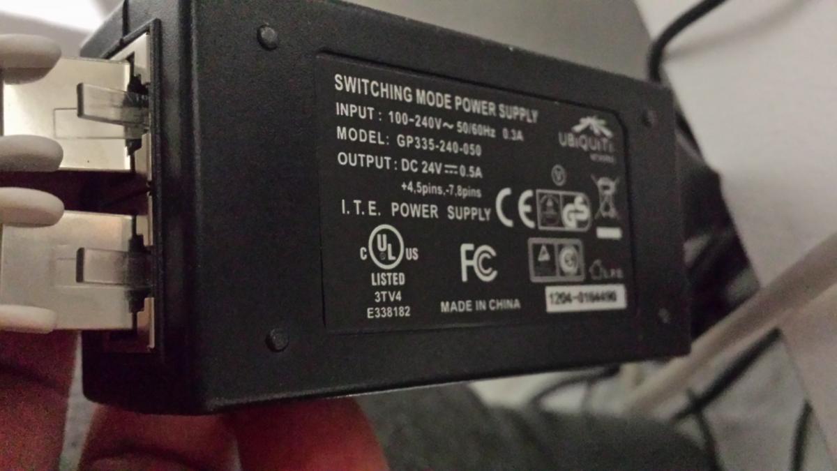

embeathome 8 Posted December 24, 2014 Author Posted December 24, 2014 guys I have checked my switch (Netgear GS108E) and it seems it has really nothing to do with port forwarding. I have checked once again my stuff - from the roof there is a cable entering the house to Ubiquiti power supply, hopefully this is not a modem also...attached prinstcreen,,,and from it, cable goes directly to router, Nothing behind router except switch or behind this Ubiquiti stuff,

shaefurr 1340 Posted December 24, 2014 Posted December 24, 2014 Ah ok, with that type of ISP the router is also the antenna up on your roof or wherever it is. It goes into a power supply and then into your home router. You can see in the pic below how the setup is. Its still should have its own setup, try and follow this guide to access the configuration webpage to port forward mediabrowser on it. http://portforward.com/english/routers/port_forwarding/Ubiquiti/AirOS/Media_Browser.htm 1

embeathome 8 Posted December 26, 2014 Author Posted December 26, 2014 (edited) @ shaefurr - Kudos for you! I contacted ISP again and they have re-checked settings in Ubiquiti stuff and found it acts as router, not bridge. So i had to change some settings in my router (WAN settings-->Internet to PPPOE with login and password) and they changed behavior of ubiquity and now all works fine!! Many many thanks! Now i am trying to get Wake on Lan working from outside of home my LAN. In home LAN it works OK, My WOL android app wakes FreeNas server without any issues (after setting ifconfig in FreeNas shell), i am able to send network message to wake up PC from my Asus RT-AC66U from outside of my LAN, but i am not able to make it working with any app i tried. Simply nothing happens....it is possible that Router blocks packets from outside despite i set Port forwarding to ports 7 and 9 and also turned firewall in router off... Any idea? Ah ok, with that type of ISP the router is also the antenna up on your roof or wherever it is. It goes into a power supply and then into your home router. You can see in the pic below how the setup is. Its still should have its own setup, try and follow this guide to access the configuration webpage to port forward mediabrowser on it. http://portforward.com/english/routers/port_forwarding/Ubiquiti/AirOS/Media_Browser.htm Edited December 26, 2014 by embeathome 1
