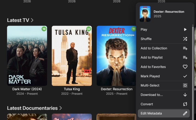

Also, seems to be more than I thought... it appears to be if I edit the ROOT series metadata, make a change, save it. Come back to it... it appears to have done it, if I go and edit it again and save... it now will revert to external metadata site's data and not let me change it again.
Edited to add screenshot...
Edited by ElylArneseph
ElylArneseph
Here, I stopped my Emby Server service and restarted so I have a clean log file. Once the service started, I went to the Dexter: Resurrection show icon, clicked the ellipsis and selected edit metadata. I deleted the show's overview text and selected to lock series from future changes and then clicked save. Edited the metadata again, everything was unchanged and no lock enabled. That's all I did then grabbed the logfile and attached here.
