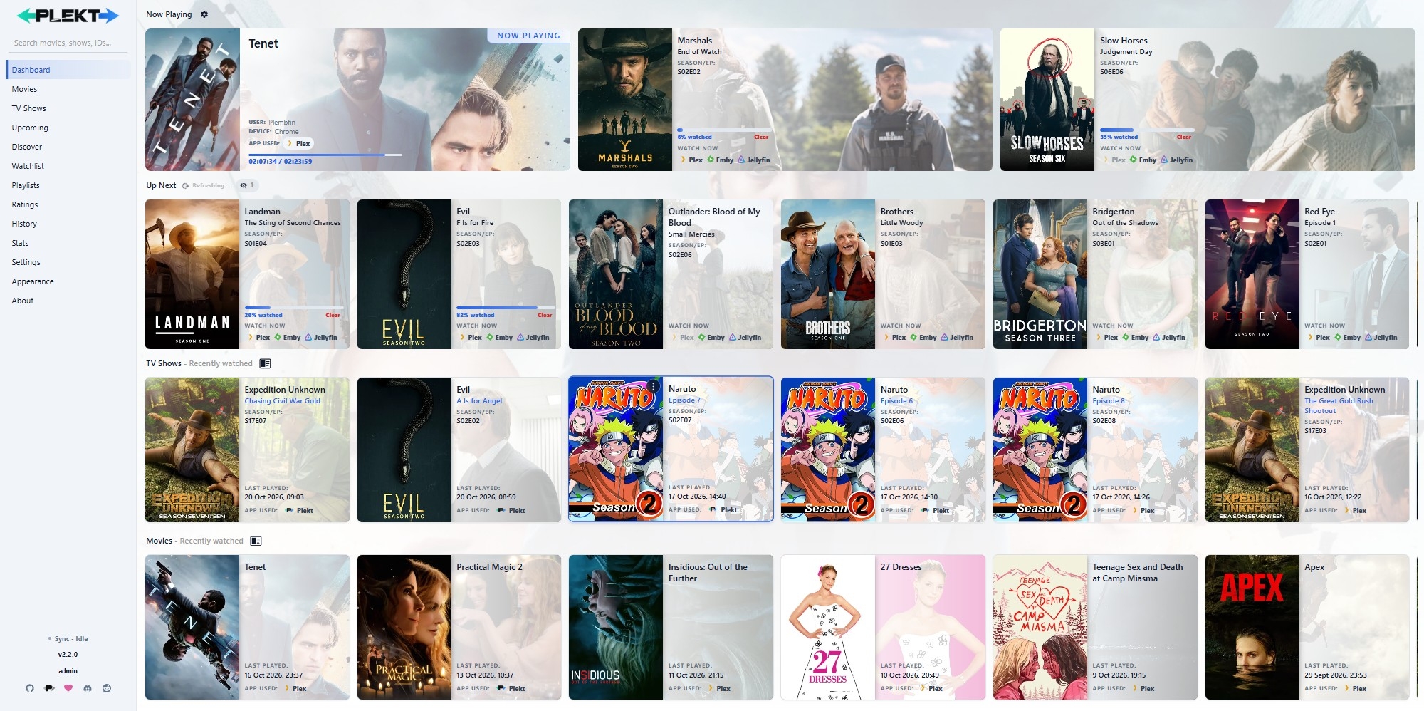

Sadly I'm not able to get an intial sync.
The dashboard features the actual playback, but polling a sync throws:
