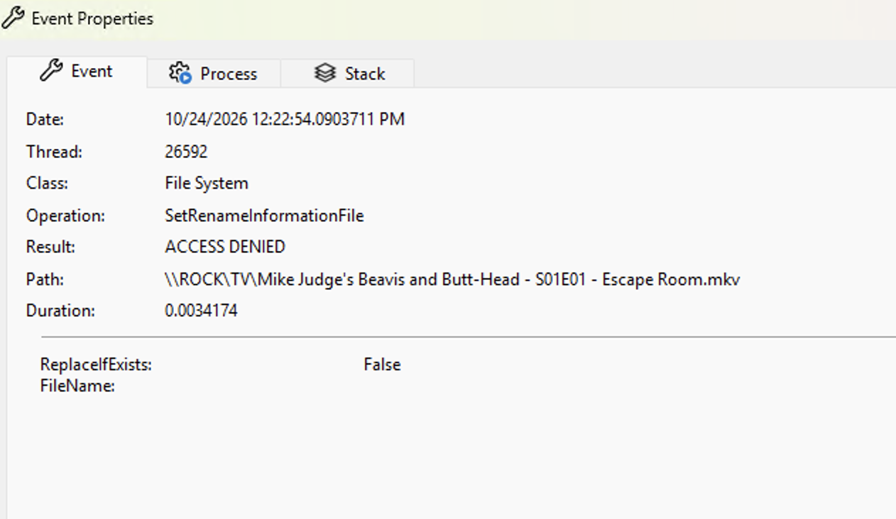

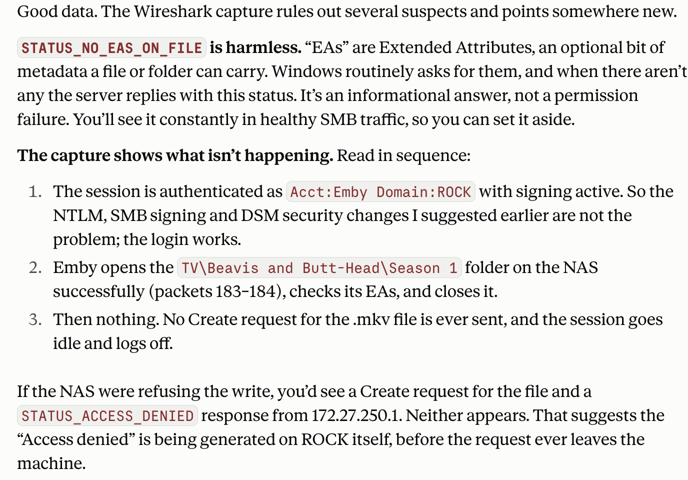

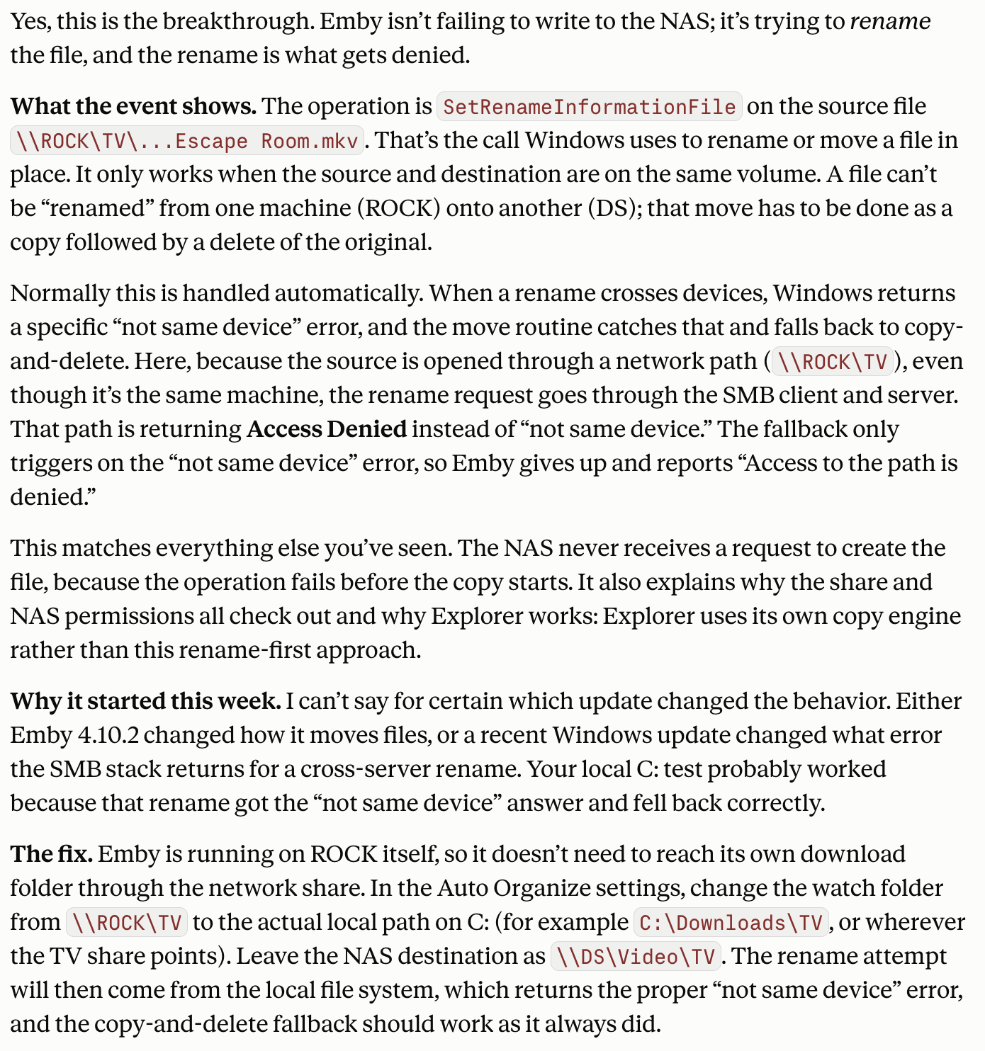

Solution moviefan 189 Posted 3 hours ago Author Solution Posted 3 hours ago (edited) Okay so I spent some time doing troubleshooting and analysis this morning. Here is what I found: - I tried making Emby user an Administrator but this didn't resolve anything. So switched it back. - Your suggestion of moving the destination to the C drive worked. Because of that, I started digging into the Synology logs. It's strange because I wasn't even seeing the Emby user hit the Synology. I downloaded Wireshark and Initially thought I found an Error: STATUS_NO_EAS_ON_FILE. I plugged the data into Claude to see if it could point me in the right direction. It then pointed me to use Process Monitor to see what was happening there. This is what I found there: And here is what Claude had to say to this. I was doing this as a network share because my main download folder was running under my primary user account and Emby didn't have file system access to it. But I figured I would give this a shot and I just moved the download location for auto organize into the Emby's user folder. This solved the problem. So anyway, I am fixed, but it appears that Emby changed the way it does auto organize in a way that if it believes that source and destination are on the same system (or if both source and destination are on network shares), it does a rename operation, instead of a copy. I'm sure you are going to have at least some other users who may be using network paths as the source and destination for auto-organize, and they are likely going to run into the exact same problem as I did here. Edited 3 hours ago by moviefan minor change 1
