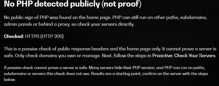

Chillout 142 Posted October 21 Posted October 21 PHP Security Warning - Does this affect Emby? It passes the checker at a high level...
remid12 7 Posted October 21 Posted October 21 (edited) I just also see the new, most of french governement web site was passed in maintenance mode as 2 critical security issue was found on PHP. I would be interested to know if emby use php and if it's better to turn off any external access temporary. Thanks a lot. Edit : I checked the server processes for PHP-related components (PHP, Apache, Nginx and IIS), and nothing was detected. Based on this initial check, it appears that Emby is not using PHP on this server, so the recently disclosed PHP vulnerabilities should not directly affect this installation. Anyway, better to look for confirmation from the Emby team in case any embedded component is involved. Edited October 21 by remid12
