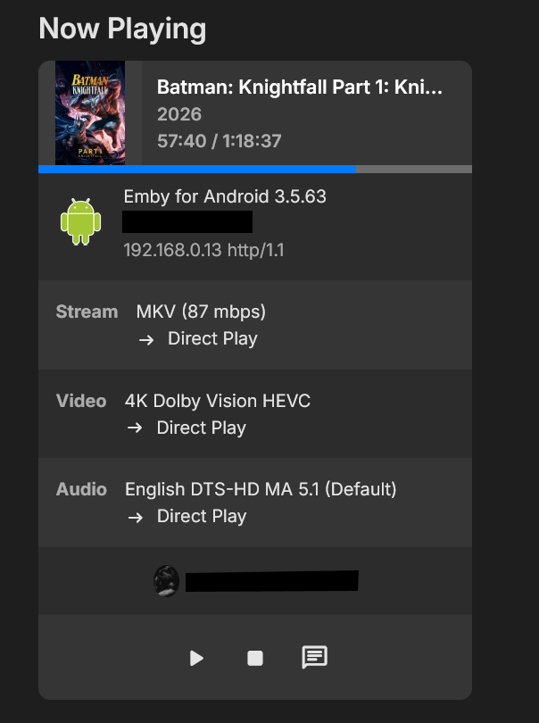

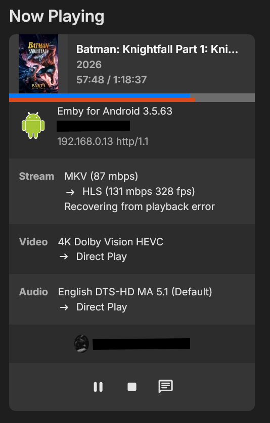

Obsidian21 1 Posted October 16 Posted October 16 Hi, Over the last couple of months I would say, I've been having this issue where sporadically content that is directly playing, with all forms of transcoding disabled on the LAN will run into an error, mid playback where it will say "Playback Error - There was an error processing the request. Please try again later." I've attempted to replicate this on the media and I've found that it throws an error, just a few seconds before the chapter heading (roughly 57:44/45), however if I play from the beginning and then skip to the chapter (57:48) then it plays with no issues. I've had a look at the logs and couldn't make much sense of them. However, allowing changing of the video container format allows the video to play, however it goes from Direct Play to Direct Stream and says "recovering from playback error" please see screenshots 1 and 2 (ss1/ss2) below for examples from the dashboard. When the error occurs, there's a very visible loop, where the client can be seen to sort of resolve the error in realtime, it goes black, then plays the content again, then goes into the next scene. I'm confident if we disabled change of video format, the black screen would just end in the error being thrown again. First log file - disabled changing format, play content, scrub back 20 seconds, let it play, playback error shown at around 57:45) - (log file called SCENARIO 1) Second log file - enabled changing format, play content, scrub back 20 seconds, let it play, playback error not shown, scene repeated twice, then plays into subsequent scenes. This time, as I didn't have audio transcoding enabled, the audio also failed to play. I then enabled this, scrubbed back and let it play past the error point at which point audio played as expected. < Video is of this scenario Please let me know if there's anything else I need to include. SCENARIO 2.mp4 SCENARIO 2.txt SCENARIO 1.txt
