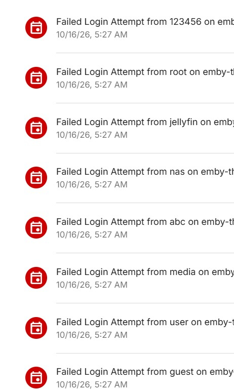

SanguineWren 7 Posted October 16 Posted October 16 In the past two days I've been seeing these failed logins - always spammed (all in the same minute) when I check my server activity logs. To my knowledge, I do not have any usernames like this in either Emby (unless they are built-in/hidden?) nor do I have them on my Synology. Is there anything I can / should do about this?
yocker 2078 Posted October 16 Posted October 16 One of them is an attempt with the user "root" so highly likely.
Neminem 1984 Posted October 16 Posted October 16 I have see this in the past. Script kiddy's scanning the internet looking to get access to Emby ports. Jellyfin uses the same port as Emby, fyi. Have not seen this since I setup a reverse proxy + Geo-blocking in my Unify network. I would advice disabling the port forwarding for a couple of days, just to see if they give up and move on.

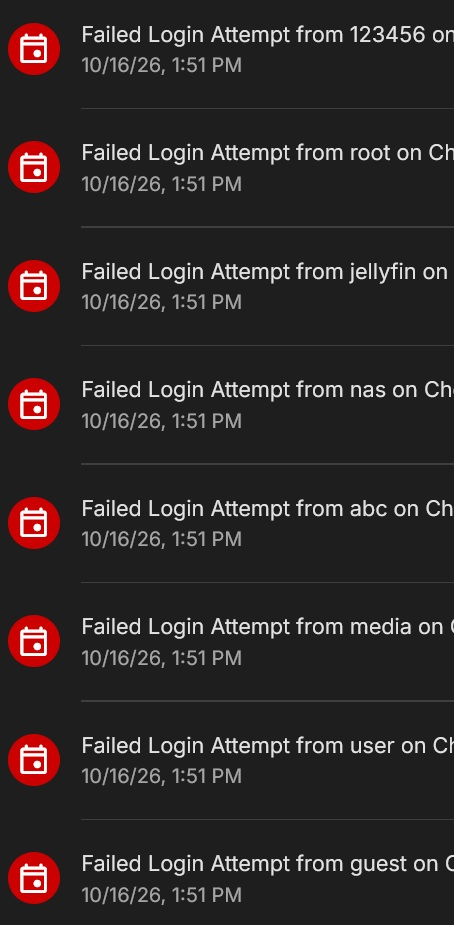

Symen_4ab 9 Posted October 21 Posted October 21 Got the same list of attempts on the same day If you have decent enough passwords, this should not be a problem. Any internet-exposed service will get brute-force attempts, that's expected. Emby displays those attempts in big on the admin page, but many others just log them in a text file somewhere. Also I'm on the team that thinks changing the port is not a bad idea. You will definitely avoid simple mass scanners. (I'd bet this one, with its 17 login tries with "root", "emby" and "123456", only scans the default port).

heffeque 120 Posted October 21 Posted October 21 I also got the same login attempts around the same date as you. I blocked all communications coming from that IP (a data center in the US). Hopefully nothing comes out of it. Question for Emby: can you put something up to auto-block IPs that have unsuccessfully tried to log in? Cheers! 1

BalthazarBux 19 Posted October 21 Posted October 21 I also got exactly that, from data center in US. Still a bit weird, have our logs some info in them maybe, if we have posted them here sometime?
yocker 2078 Posted October 21 Posted October 21 18 minutes ago, BalthazarBux said: I also got exactly that, from data center in US. Still a bit weird, have our logs some info in them maybe, if we have posted them here sometime? Probably some rented machine.
