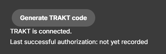

podonnell 55 Posted October 14 Posted October 14 Hi, While looking through my Emby log I have been seeing errors, looks like my last Trakt update was on July 16th of this year. The errors I see in the log: 2026-10-14 00:03:31.345 Info HttpClient: POST https://api.trakt.tv/oauth/token 2026-10-14 00:03:31.385 Info HttpClient: Http response 400 from https://api.trakt.tv/oauth/token after 39ms 2026-10-14 00:03:31.386 Error Trakt: Exception handled sending status update *** Error Report *** Version: 4.10.1.0 Command line: \EmbyServer.dll -noautorunwebapp MediaBrowser.Model.Net.HttpException: MediaBrowser.Model.Net.HttpException: BadRequest Source: Emby.Server.Implementations TargetSite: Void MoveNext() I have reinstalled Trakt and then reconnected my account directly in the Trakt section for my user. It shows that I successfully connect, but I see this: Any ideas what is happening?

podonnell 55 Posted October 15 Author Posted October 15 I did give that a shot a few times but the image above is the state that it remains in. I never see a successful authorization.

podonnell 55 Posted October 15 Author Posted October 15 I clicked generate code, it gave me the code. I opened the linked Trakt website and it asked me for the code. I input it and received: Then, back in Emby: This is the pattern I saw before. I will now play a video and expect to see the same errors in the previously attached log.
Solution Luke 43675 Posted October 15 Solution Posted October 15 Quote Then, back in Emby: And then what did you do?
podonnell 55 Posted October 15 Author Posted October 15 Hah... I did not click save at the bottom. That has now corrected the issue: > Last successful authorization: 10/15/2026, 5:05:13 PM 1
