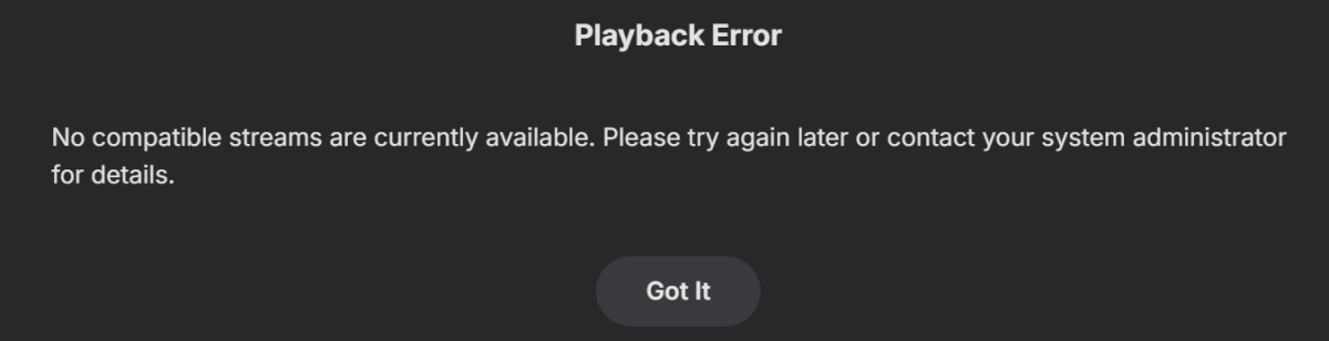

danergo 50 Posted October 14 Posted October 14 Environment Emby Server 4.9.5.0, Linux (Ubuntu, kernel 7.0.0-38-generic), x64 Bundled ffmpeg: 5.1-emby_2023_06_25_p4 GPU: NVIDIA Quadro P400 (Pascal, CC 6.1), detected correctly. NVDEC/CUVID HEVC decoders and NVENC H.264 encoder are all listed and pass checks. Hardware acceleration mode: Advanced Client: Emby Web 4.9.5.0, Chrome on Windows, remote connection Source file DJI Osmo Action 4 recording, MP4, 3840x2160, HEVC Main 10 (yuv420p10le), 50 fps, ~110 Mbit/s, Level 150, SDR/BT.709 The camera was mounted upside down, so the file carries rotation metadata: Side data: displaymatrix: rotation of -180.00 degrees Problem Playback fails with “No compatible streams are currently available.” Non-rotated 4K HEVC files from the same camera transcode fine on the same server with full NVDEC → NVENC. The transcode does start, but runs at about 6 fps (`speed=0.11x`) for a 50 fps source. The client gives up and stops it (`[q] command received`): elapsed=00:00:09.54 frame=58 fps=6.1 ... speed=0.111x [q] command received. Exiting. Analysis The processing plan shows rotation is not supported in hardware: Name CanDoInHW WillDoInHW NVDEC Quadro P400 - H.265 (HEVC) >> True True VideoInput >> True False Rotation >> False False Scaling >> True True ColorConversion >> True True VideoOutput >> True True NVENC Quadro P400 - H.264 (AVC) >> True True The resulting filter chain rotates in software before uploading to CUDA: HEVC >> rotate >> hwupload_cuda >> scale_cuda >> setsar The plan says NVDEC will be used, but the actual ffmpeg command line uses the software HEVC decoder limited to a single thread. There is no `-hwaccel cuda` and no `hevc_cuvid`: -c:v:0 hevc -threads:v:0 1 -noautorotate ... -filter_complex "[0:0]rotate@f1=angle=180*(PI/180),hwupload_cuda@f2,scale_cuda@f3=w=1920:h=1080:format=yuv420p,setsar@f4=sar=sar[f4_out0]" So a single CPU thread has to decode 4K 10-bit HEVC at 110 Mbit/s, and then a generic software `rotate` filter runs on every 4K 10-bit frame. NVENC encoding itself works fine. The bottleneck is entirely the forced software decode plus software rotation. Why this seems unnecessary The hardware can do it. A 180° rotation is just a horizontal plus vertical flip. The decoded frame is already in GPU memory after NVDEC, so a trivial CUDA operation (or NPP, e.g. `transpose_npp`) could handle it without leaving the GPU. Even if rotation must stay in software, the fallback could be much better. The pipeline could still decode on NVDEC, `hwdownload`, flip on the CPU, and `hwupload_cuda` again. Failing that, it could at least use a multi-threaded software decoder instead of `-threads 1`. The software `rotate` filter is a poor choice for 180°. It is a general arbitrary-angle rotation with interpolation. `hflip,vflip` (or `transpose`-based equivalents) would be considerably cheaper for 90/180/270° cases. Requests Add hardware rotation support for NVIDIA (CUDA/NPP-based flip/transpose), at least for 90/180/270°, so rotated videos can stay on a full HW pipeline. Until then, when rotation forces a software step, keep hardware decoding and only download/upload around the rotation step, or don’t limit the software decoder to one thread. Use `hflip`/`vflip`/`transpose` instead of the generic `rotate` filter for right-angle rotations. This affects a very common use case: action cameras (DJI, GoPro) and phones often record with rotation metadata, especially when mounted upside down. Workaround for now: re-encode the affected files outside Emby, so the rotation is baked into the pixels and the metadata tag is removed. Full transcode log available on request.

danergo 50 Posted October 14 Author Posted October 14 @Luke, this is the error I'm seeing: Please find the logs attached. ffmpeg-transcode-3f43cb06-7e9b-452f-b29f-e83969546f98_1.txt embyserver (12).txt
