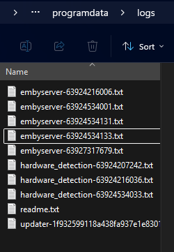

GeorgeCalli 23 Posted October 11 Author Posted October 11 Found these under programdata logs. All 9 September, except the last embyserver which is todays.

Solution Luke 43549 Posted October 11 Solution Posted October 11 I would try installing the server again from the website on top of your existing installation.
