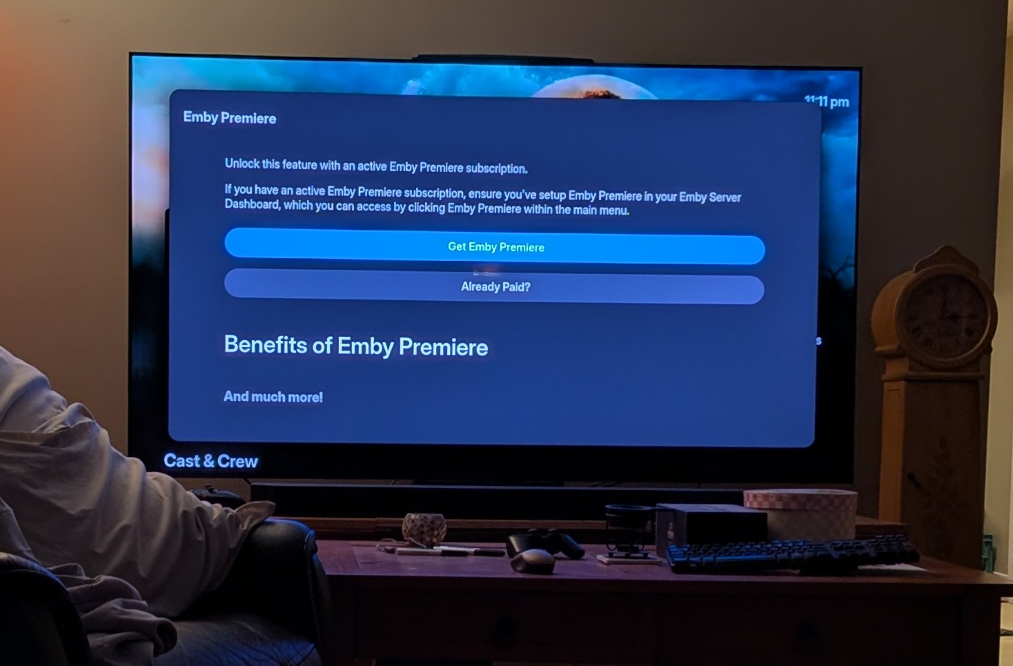

marriedman 126 Posted October 10 Posted October 10 I have had this popping up on my TV a lot lately. I've been a premiere user for years. I only get this on my TV for some reason. Server log attached too. I usually just press I have a premiere 10 times or so and it finally start playing. But this is annoying. embyserver.txt
Luke 43719 Posted October 10 Posted October 10 Hi, does the TV have an internet connection? What model is it?
marriedman 126 Posted October 10 Author Posted October 10 It's a Samsung QN77S90DDFXZA and yes it has internet connection, however I do block a lot of their crap with the following: https://github.com/Perflyst/PiHoleBlocklist/blob/master/SmartTV.txt However, I have had that for the past 5 years. First on a pihole, and since January 2026 on OPNSense.
Solution ebr 17102 Posted October 10 Solution Posted October 10 9 hours ago, marriedman said: however I do block a lot of their crap with the following: Make sure you whitelist mb3admin.com. 1
marriedman 126 Posted October 10 Author Posted October 10 I just added that to the whitelist. I'll report back later if that solved it.
marriedman 126 Posted October 12 Author Posted October 12 On 10/10/2026 at 10:03 AM, ebr said: Make sure you whitelist mb3admin.com. It's been a couple days and I haven't seen the prompt again. That seems to be the solution. Did a search on it and found the reason. Makes sense. Thanks for the tip. 1 1
