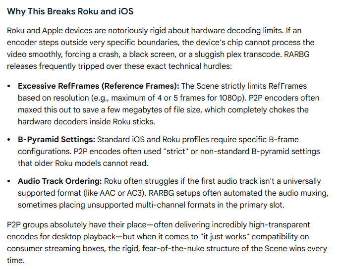

user84 54 Posted October 9 Author Posted October 9 (edited) 41 minutes ago, speechles said: That is the problem. I knew it when you said you had that stuttering issue. I went man, I wonder if this is those RARBG encodes that do not follow standards? Low and behold it is. This release group does not follow standards required for streaming playback. They encode as if you have the entire file on your hard drive and are playing with something that can load the entire file at once. They put chapters at the end, use lots of embedded tags, and other nonsense. My advice is run anything from RARBG through MKVToolNix GUI and correct these at that point. Then these will play correctly. Are all the others you have issues with also from RARBG? I haven't checked any of my own personal rips, but I can try to do that at some point. @speechles The file in question is already an MKV. How would MKVtoolnix fix this? Edited October 9 by user84

speechles 2130 Posted October 9 Posted October 9 (edited) hmm. Blame the encoding again. Does it switch to automatic playback recovery at that point and create an ffmpeg-transcode log? Or afterwards with that stutter does it stay as ffmpeg-remux? That is why I still blame the encoding. If it isn't forcing a playback method change. That means it isn't an error causing the Roku nor ffmpeg to abort they just cruise through it. It is something _in_ the video the stream itself is encoded. Some B-frame not done correctly where its part of the video stream now. Bad timestamps inside the video stream. There is no way to fix it without reobtain their same exact source material and encode it correctly. This issue should expose itself in the ffmpeg data log somewhere too, but I do not see it. Other than those guessed frames which could be it. If it plays correctly on other devices it must do that same hiccup at that same spot there. Those other devices are just more adept at how they handle the interruption. If you are saying all other devices play it perfectly just the Roku is being a dork, then we might need a sample. The full sample. A partial sample may not give the same issue. The full file. It is okay to share in this instance because this is to better the app for educational and such reason. You can share via dropbox, or google drive, or anything you want to share with either myself or @ebr. Make sure to send the link to the file in private message. Once we can duplicate your issue which should then be possible we can get the right people involved and make this move much faster. Thanks. Edited October 9 by speechles
user84 54 Posted October 9 Author Posted October 9 2 minutes ago, speechles said: hmm. Blame the encoding again. Does it switch to automatic playback recovery at that point and create an ffmpeg-transcode log? Or afterwards with that stutter does it stay as ffmpeg-remux? That is why I still blame the encoding. If it isn't forcing a playback method change. That means it isn't an error causing the Roku nor ffmpeg to abort they just cruise through it. It is something _in_ the video the video is encoded. Some B-frame not done correctly where its part of the video stream now. There is no way to fix it without reobtain their source and encode it correctly. It should expose itself in the ffmpeg data somewhere too but I do not see it. Other than those guessed frames which could be it. If it plays correctly on other devices it must do that same hiccup at that same spot there. Those other devices are just more adept at how they handle the interruption. If you are saying all other devices play it perfectly just the Roku is being a dork, then we might need a sample. The full sample. A partial sample may not give the same issue. The full file. It is okay to share in this instance because this is to better the app for educational and such reason. You can share via dropbox, or google drive, or anything you want to share with either myself or @ebr. Make sure to send the link to download the file in private message.Once we can duplicate your issue which should then be possible we can get the right people involved and make this move much faster. Thanks/ I'm happy to do that, but just help me understand. If I made the adjustments with ffmpeg and changed audio to ac3 to direct play, and that solved the problem, how is it still the encode? As the guy who knows nothing here, doesn't this point to transcoding...or the non-ability to direct play as the cause? At this point I'd rather just use ffmpeg on my library to make AC3 track one and solve this issue.
speechles 2130 Posted October 9 Posted October 9 (edited) 1 minute ago, user84 said: I'm happy to do that, but just help me understand. If I made the adjustments with ffmpeg and changed audio to ac3 to direct play, and that solved the problem, how is it still the encode? As the guy who knows nothing here, doesn't this point to transcoding...or the non-ability to direct play as the cause? At this point I'd rather just use ffmpeg on my library to make AC3 track one and solve this issue. Because it changed the audio which is how the timing is performed on the Roku. Aka, you did remux it when you did that and it did work. MKVToolNix would do the same thing. Edited October 9 by speechles
