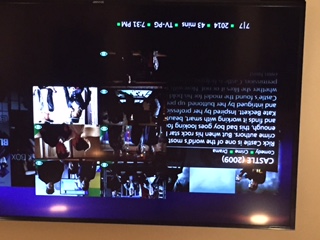

BorgSquared 2 Posted December 5, 2014 Posted December 5, 2014 (edited) I have been having a problem with Media Browser Classic on Xbox 360 extenders. After watching an episode and going back to the show list the interface freezes. The MCE button does not work and requires restarting the Xbox or going to the Xbox home screen and re-launching MCX. This happens every time an episode is watched. This leads to continuous rebooting of the Xbox after every episode and is very aggravating. Attached is a photo taken of the frozen screen and the media browser classic log for one such instance. The Windows event log did not show anything of interest other than the session being established and abruptly disconnecting. This issue seems to have started two MBC updates ago. Edit: For some reason the photo was rotated after uploading by the forum software and renders upside down. MBClassic-412201494c7ebf2ba354d42afbad19586d95ede.log Edited December 5, 2014 by BorgSquared
