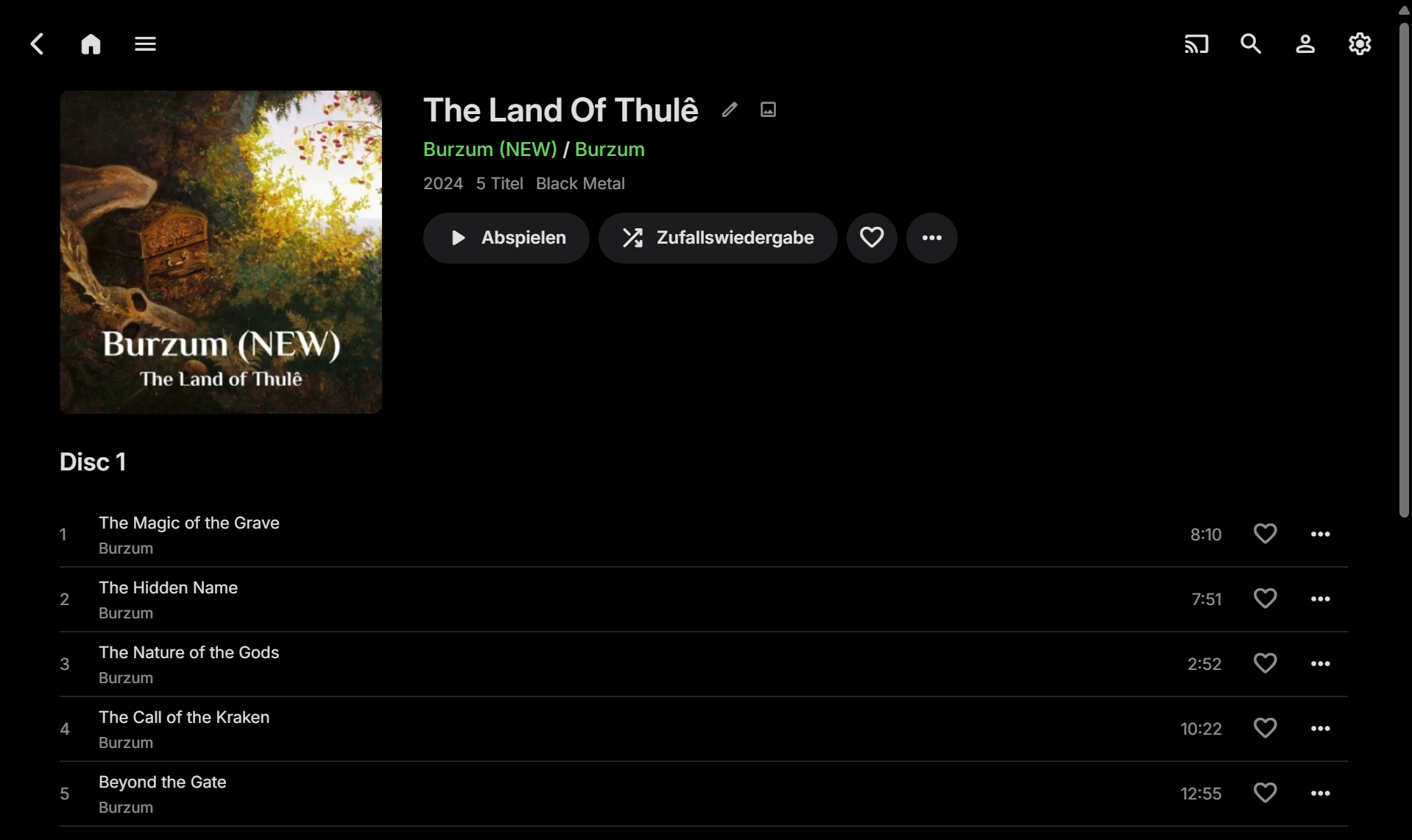

I don't know of any easy way to achieve exactly what you want, but here's a potential workaround that may at least group all of the Album Artist Albums together for all of the aliases, while still retaining the aliases for the individual Albums...
Emby will import multiple Tags for the Album Artist field, so you could leave the Album Artist alias (as you already have it now) and add the "main" Artist as an additional Album Artist across all of the different alias Albums. Then your Album page will link back to your complete Album Artist discography in Emby, via the combined Album Artist entity.
I'm not familiar with this Artist, but you would know if "Burzam" or perhaps "Burzum - Combined" or something else, would be suitable as a combined entity name.
Your example Album page view could look something like this:
An advantage could be that you could have different Album Artists primary images and overviews for the combined entity and the individual alias entities, if you wanted to? I've been testing this for a week, with my own library, and it's not too bad.
A disadvantage could be that there are still several Album Artist entities for the one Artist, when you would prefer to have just one?
Other different combinations of Album Artist / Artist / Composer Tags may give some other page views useful for you???
Anyway, perhaps it's something to test for yourself (if you haven't already) and easy to revert back if it's of no benefit for you. Cheers!

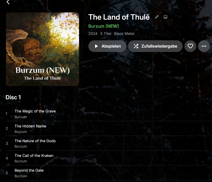

I tested the sample you sent me and I only got one album:
And the artists on each track all seem to match windows explorer, although I did not examine ffprobe info.
