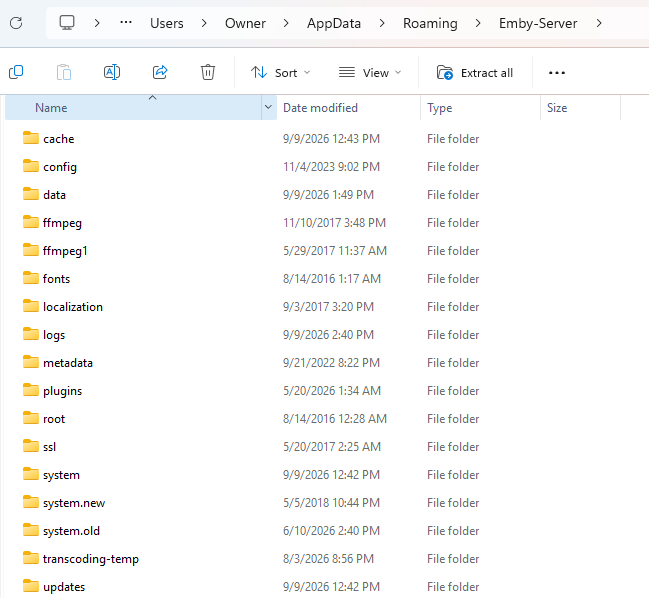

Lane03 17 Posted September 9 Author Posted September 9 2 minutes ago, GrimReaper said: Hm, something might have triggered StartupWizard flag reset. You can try shutting down your server, go to "C:\Users\Owner\AppData\Roaming\Emby-Server\programdata\config" folder and edit system.xml file, change: IsStartupWizardCompleted>false</IsStartupWizardCompleted> to IsStartupWizardCompleted>true</IsStartupWizardCompleted> Save, restart server. I don't have a programdata folder. My explorer view shows all hidden and system files btw.
GrimReaper 5202 Posted September 9 Posted September 9 @LukeHow did all folders ended up nested under main server folder? 3 minutes ago, Lane03 said: I don't have a programdata folder. It is either a really old install/incremental update or something has got amiss there in the update process; anyway (as your server seems to be running as it's accessible from other devices), do you have system.xml there under \config subfolder? 1
Lane03 17 Posted September 9 Author Posted September 9 2 minutes ago, GrimReaper said: @LukeHow did all folders ended up nested under main server folder? It is either a really old install/incremental update or something has got amiss there in the update process; anyway (as your server seems to be running as it's accessible from other devices), do you have system.xml there under \config subfolder? You rock! system.xml was under the \config subfolder. I changed the flag from false to true and looks good now! 1

Luke 43402 Posted September 9 Posted September 9 6 minutes ago, Lane03 said: @GrimReaperthanks again for the quick fix! @ebr, @GrimReaper, @Lukebeing that it sounds like my directory structure is "non standard", any recommendations or suggestions to avoid any update issues in the future? I don't mind uninstalling and re-installing emby if necessary, providing I can migrate over my config and not have to re-setup my users/libraries... How is it non-standard?
Lane03 17 Posted September 9 Author Posted September 9 1 minute ago, Luke said: HI, you also could just step through the wizard and do nothing other than press next on every step and that would have been fine. Good to know! I was worried doing so could mess up the current settings/database, so I figured better to come here first before proceeding. 1 minute ago, Luke said: How is it non-standard? Maybe I misunderstood, but GrimReamer seemed to think my folder structure was odd since I didn't have a "emby-server\programdata" folder.
ebr 16938 Posted September 9 Posted September 9 Just now, Lane03 said: Maybe I misunderstood, but GrimReamer seemed to think my folder structure was odd since I didn't have a "emby-server\programdata" folder. "Legacy" is probably a better description. We changed the structure a long time ago but should still support the flat layout you have (obviously, with a few quirks...). 1
