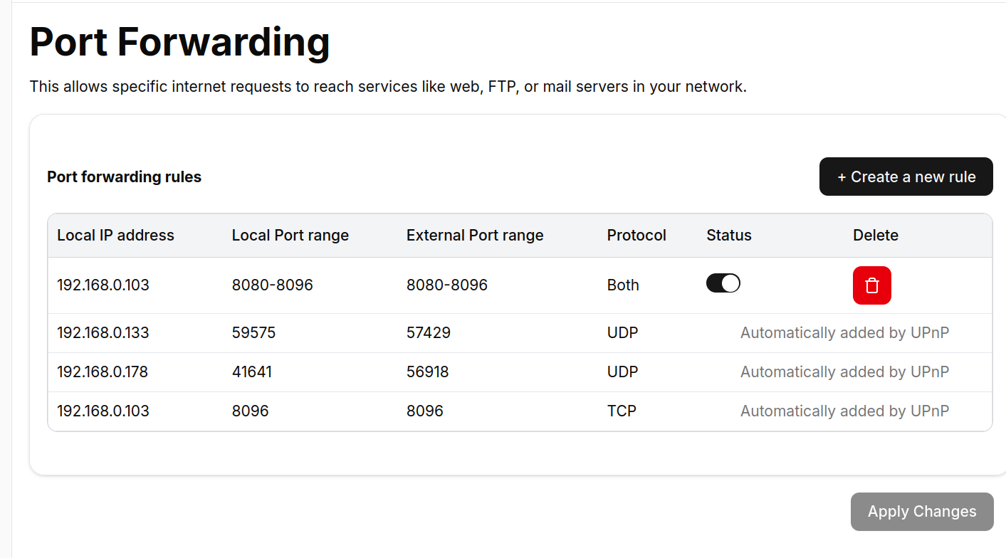

In the router settings, there is a Port Forwarding menu that lets you create rules.  There is also a separate UPNP menu that, once enabled, supposedly allows devices to set up port forwarding automatically.  In the attached screenshot, there is one rule I created, and three that were added automatically by UPNP.
There is also a DMZ item in the router menu - I have tried enabling this and entering the Emby server address.
I have checked the server address in the Emby server dashboard, and this matches the address entered in the router.  The server is running on a QNAP NAS.

Looking at your screenshot, I see one problem - your two overlapping port forwarding rules for Emby. Your manually created rule forwards ports 8080–8096, while UPnP has also created a rule for TCP port 8096. That can cause timing synchronization issues that will cause dropped the internet connection that requires a manual restart.

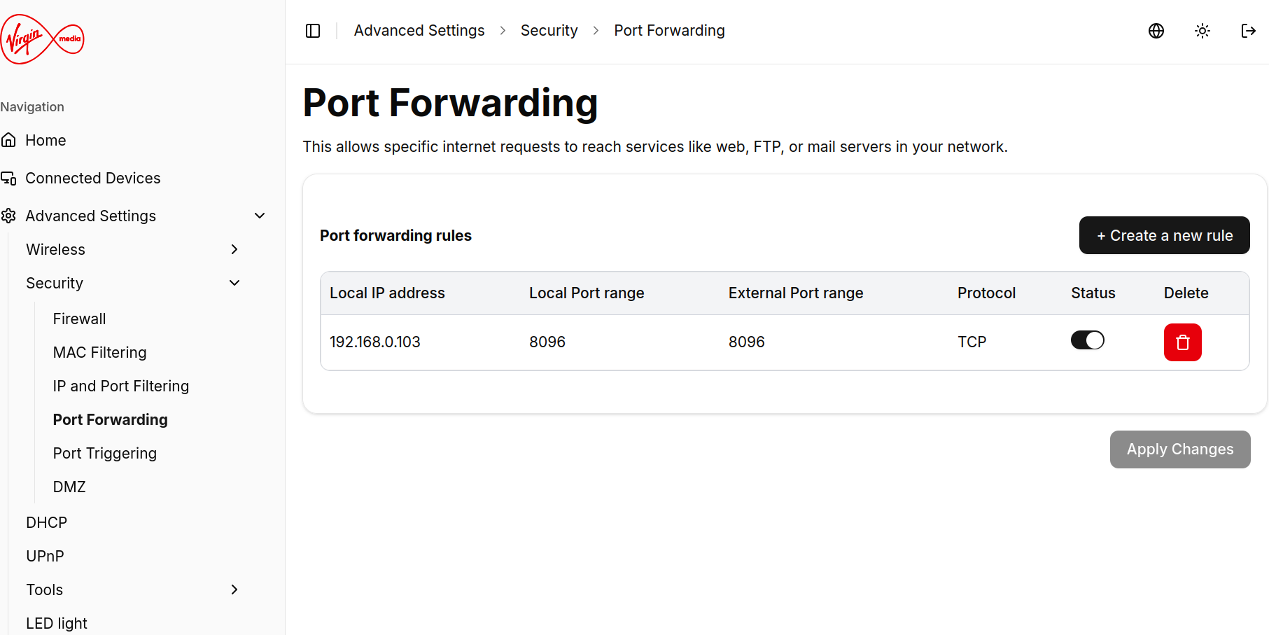

I've followed your troubleshooting suggestions and removed the existing port forwarding, disabled DMZ & UPNP, and created a new single port forward rule for TCP port 8096 to TCP port 8096 at 192.168.0.103
After re-starting the router, I can still access Emby on the local network, but still no success outside the LAN.

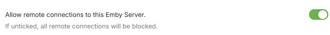

You said you checked Remote Access is enabled on Emby Server. There are two places where that is set, Can you check both: in Network Settings and also on the user account

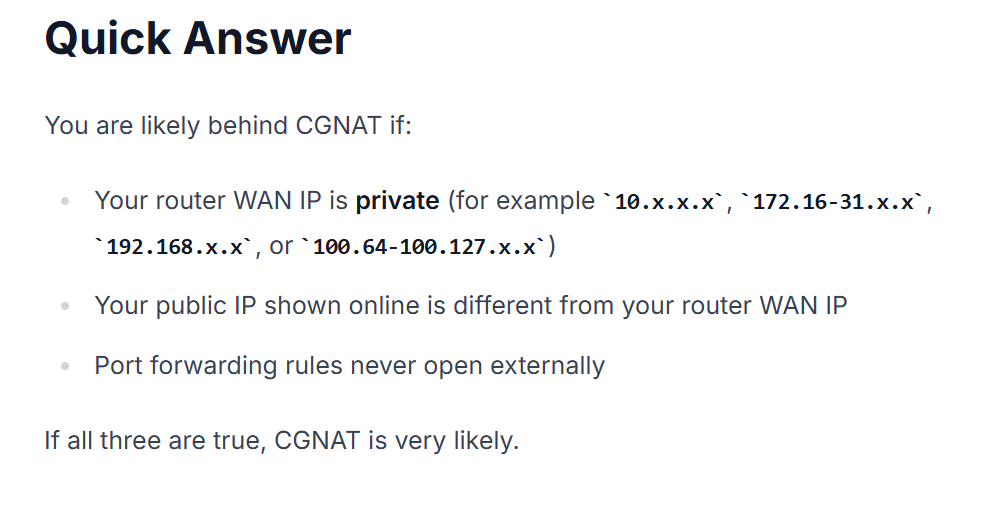

Did you eliminate CGNAT as a possibility ?   You can easily establish that by checking if the WAN Public IP address is within this range: 100.64.0.0 - 100.127.255.255

Could you get a fresh screenshot of the router port forrwards screen
I have not had a virgin media super hub for a few years now - is the black status toggle on the port forward line showing that it is enabled or disabled?

I've checked, and Remote Access is enabled in both locations

The toggle status is 'enabled' when it's black on the Virgin hub - I've checked this, and it shows as greyed out if disabled.  New screenshot is attached
sa2000
Thank You. It looks perfect and it should work
Do you need to click on "Apply Changes" for it to be active?
Anything setup under Port Triggrting ? There shouldn't be any

There are more IP ranges that indicate CGNAT.
