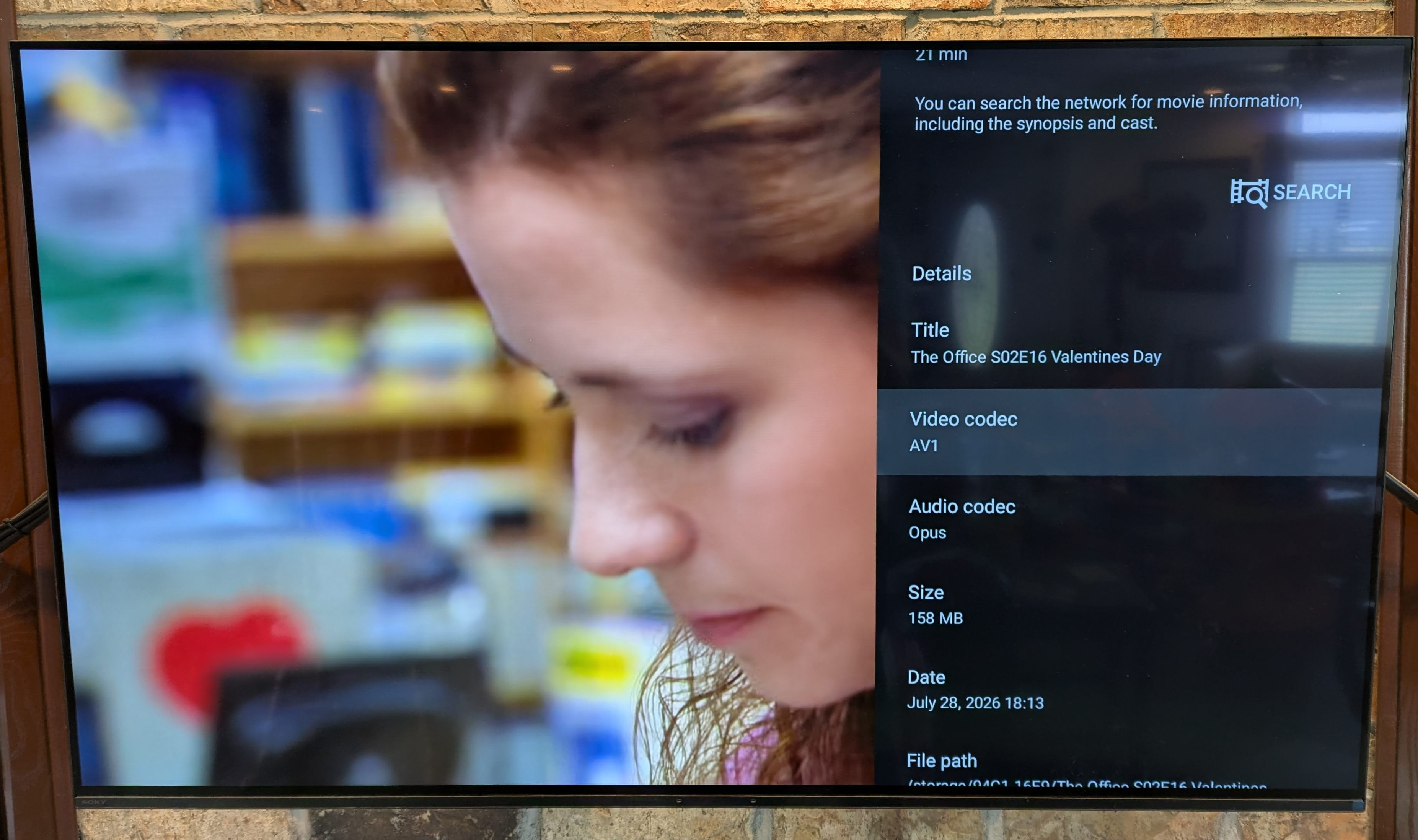

esaym153 1 Posted July 29 Author Posted July 29 23 hours ago, ebr said: Hardware. Your TV does not have an opus decoder. That's because, prior to recent versions, the TV app was using an embedded ffmpeg to decode it in software on-device. We can no longer do that in this app so have to run it through the server when the hardware doesn't directly support it. The standard app can still use ffmpeg to decode in software. I never assumed the TV had hardware support for opus, but software decoding for opus should be built in unless Sony ripped it out of their Android TV firmware. As a test I put one of the episode on a usb drive, then played it using the TV's native player (whatever that is). The audio and video worked fine (attached) But in other news, installed the regular Android app and everything working fine.
