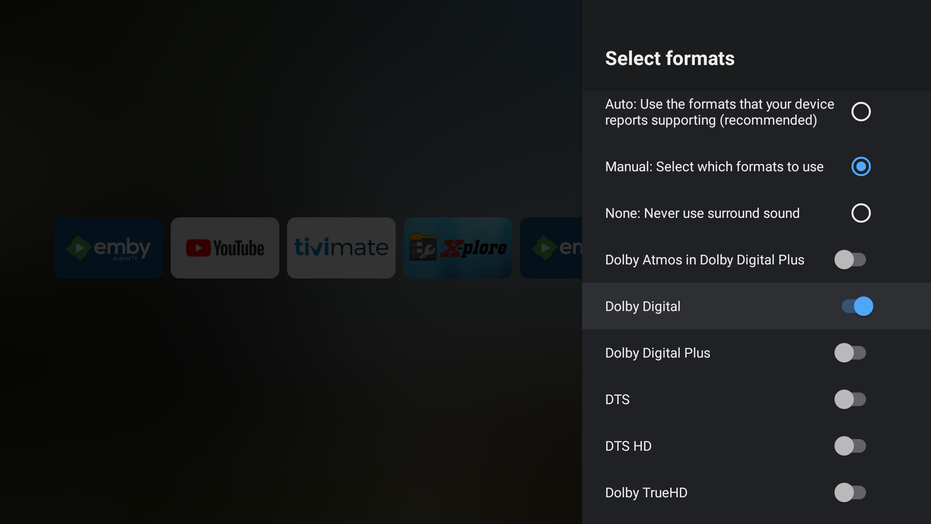

tattler 32 Posted August 1 Posted August 1 Hi @CBersand @FrostBytethanks for testing this functionality. I appreciate it. So I went on testing to compare the ATV version and the Android version. Shield TV Pro (2019) settings: Playing X-Men Days of Future Past with DTS-HD MA 7.1. The results are below. ATV version: SONOS app: Android version (option to convert to DD in the app setting is disabled): SONOS app: Android version (option to convert to DD in the app setting is enabled): SONOS app: One thing to note: please ignore the subtitle burn-in with hardware from the diagnostics plugin as it is not relevant. It has worked for me flawlessly so that is not the cause. I just want to focus on this comparison between the ATV and Android version. I hope this is more clear now what issue I am facing. If you need more details, please let me know.
FrostByte 5685 Posted August 1 Posted August 1 (edited) 36 minutes ago, tattler said: Hi @CBersand @FrostBytethanks for testing this functionality. I appreciate it. So I went on testing to compare the ATV version and the Android version. Shield TV Pro (2019) settings: Playing X-Men Days of Future Past with DTS-HD MA 7.1. The results are below. ATV version: SONOS app: Android version (option to convert to DD in the app setting is disabled SONOS app: Android version (option to convert to DD in the app setting is enabled): SONOS app: One thing to note: please ignore the subtitle burn-in with hardware from the diagnostics plugin as it is not relevant. It has worked for me flawlessly so that is not the cause. I just want to focus on this comparison between the ATV and Android version. I hope this is more clear now what issue I am facing. If you need more details, please let me know. @CBersI agree with tattler that when having the Android settings like I/we posted and playing TrueHD Atmos I get 5.1 with the AndroidTV app and stereo with the Android app. Both apps say it's direct playing. I just can't confirm what the converted format is with my hardware, though I'm pretty sure the new app is getting converted to PCM 2.0. But, I'm not sure why I'm still getting surround with ATV. The conversion must be getting done at the hardware level. I know it's not TrueHD because Atmos is lost. @CBers If you wouldn't mind testing TrueHD Atmos with the following Android settings? I had to turn off DTS, DTSHD, and TrueHD manually, but that's probably your default on the Sonos Then within the two apps make sure you aren't allowing the server to transcode and it's direct playing in SFN. I get 5.1 with one and 2.0 with the other being converted assumingly at the hardware level by both. Edited August 1 by FrostByte
CBers 7789 Posted August 1 Posted August 1 (edited) @tattlerSo you just need to have the "Convert unsupported audio to DD" option enabled in the Universal Android app and you will get DD 5.1 on your Sonos soundbar, remuxed by your server. The ATV app already does it all for you, hence no option. These are my audio settings on the 2015 Shield connected to my Sonos Playbar. Edited August 1 by CBers

tattler 32 Posted August 1 Posted August 1 (edited) 1 hour ago, CBers said: @tattlerSo you just need to have the "Convert unsupported audio to DD" option enabled in the Universal Android app and you will get DD 5.1 on your Sonos soundbar, remuxed by your server. The ATV app already does it all for you, hence no option. These are my audio settings on the 2015 Shield connected to my Sonos Playbar. Hi @CBersI think this is the whole point: I don't want the Emby server to transcode. If I can get this working properly on ATV, why can't the universal Android version do that? You can't convince me in this case that both apps do the same thing, because they are not as I have the evidence in the screenshots. So for now I will stick to ATV until this is fixed. Thank you for testing and explaining. I appreciate your time and effort here. Edited August 1 by tattler
