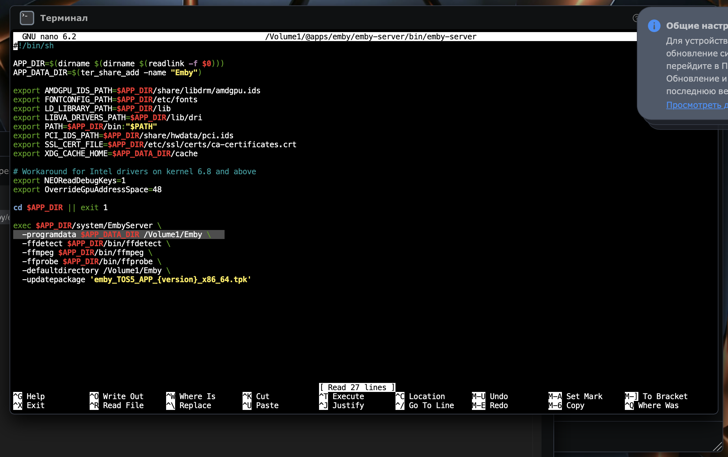

gluk147 9 Posted July 28 Posted July 28 (edited) On 7/11/2026 at 1:06 AM, Jincheng1 said: I have the some issue, i am really waiting for the newest version of Emby which will work correctly on TOS 7 To fix this bug, simply enter in the terminal nano /Volume1/@apps/emby/emby-server/bin/emby-server And replace -programdata in the config with the correct path -programdata $APP_DATA_DIR /Volume1/Emby \ After restarting the server, everything will work correctly. Edited July 28 by gluk147

AlexCh19720904 0 Posted July 28 Posted July 28 13 minutes ago, gluk147 said: To fix this bug, simply enter in the terminal nano /Volume1/@apps/emby/emby-server/bin/emby-server And replace -programdata in the config with the correct path -programdata $APP_DATA_DIR /Volume1/Emby \ With a space between $APP_DATA_DIR to /Volume1/Emby?
gluk147 9 Posted July 28 Posted July 28 (edited) 7 minutes ago, AlexCh19720904 said: With a space between $APP_DATA_DIR to /Volume1/Emby? I don't know if a space is needed or not; I have it written with a space in the config. The server detects everything correctly. Edited July 28 by gluk147
AlexCh19720904 0 Posted July 28 Posted July 28 1 hour ago, gluk147 said: The server detects everything correctly. How exactly do you get to that folder info?

svgetm 0 Posted August 10 Posted August 10 (edited) exec $APP_DIR/system/EmbyServer \ -programdata $APP_DATA_DIR /Volume1/Emby \ -ffdetect $APP_DIR/bin/ffdetect \ -ffmpeg $APP_DIR/bin/ffmpeg \ -ffprobe $APP_DIR/bin/ffprobe \ -defaultdirectory /mnt/public \ -updatepackage 'emby_TOS5_APP_{version}_x86_64.tpk' Version 4.9.5.0.02 from tos store tos - 7.0.0804 Replacing the line doesn’t fix it for me. Edited August 10 by svgetm
