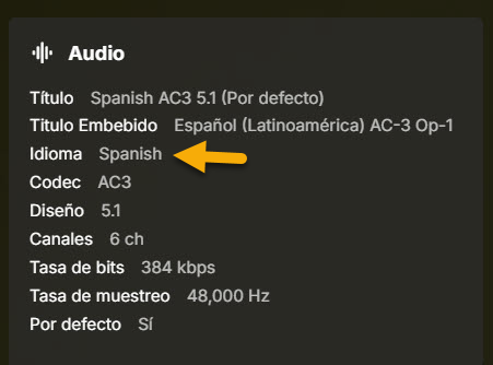

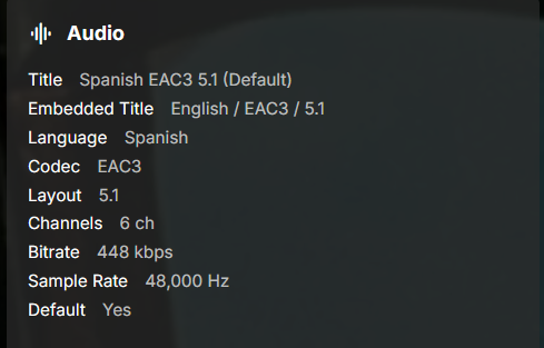

yocker 2082 Posted June 16 Posted June 16 (edited) 20 minutes ago, Luke said: Try refreshing the metadata on existing content. es-419 does indeed seem to get normalized as Spanish not as Latin American Spanish in Emby. Ignore the "embedded title" as it's a file i modified to test with. Edit: It's with Emby version 4.10.14. Edited June 16 by yocker

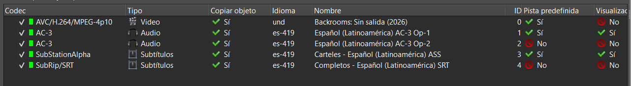

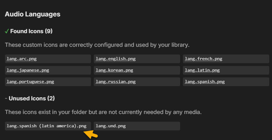

AngelSing 80 Posted June 16 Author Posted June 16 (edited) @LukeYes, I already did that. I updated the plugin, cleared all EmbyIcons caches, and rescanned the library, but it is still showing the same icon for Spanish (Spain). I even added new content to the library after the update, and it was still detected as es-ES instead of es-419. In the MKV file, the track is correctly tagged with the es-419 language code: However, in Emby's Media Info, it is displayed simply as "Spanish", with no reference to Latin America: In my custom icons folder, I already have the Latin American Spanish icon named exactly as: lang.spanish (latin america).png And in the EmbyIcons options, I can see that although the icon is present, it is still not being used: I noticed that @yocker updated the plugin, but at least in my case the issue with detecting Latin American Spanish still persists. Edited June 16 by AngelSing changes

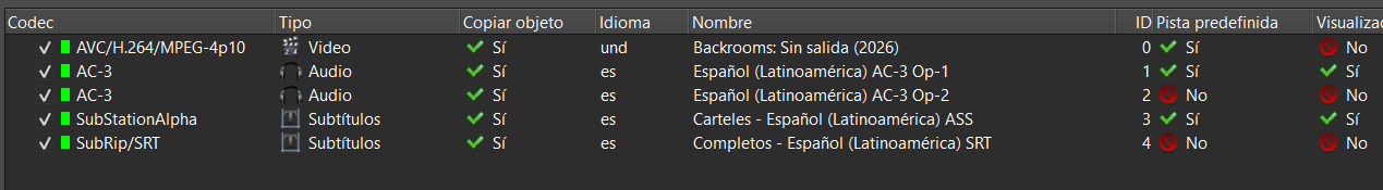

AngelSing 80 Posted June 16 Author Posted June 16 24 minutes ago, Luke said: In the file, the language code is probably just es and not es-419 I've already changed the code to (es), but it's still the same; it seems Emby is having trouble distinguishing between Spanish from Spain and Latin American Spanish. 1
