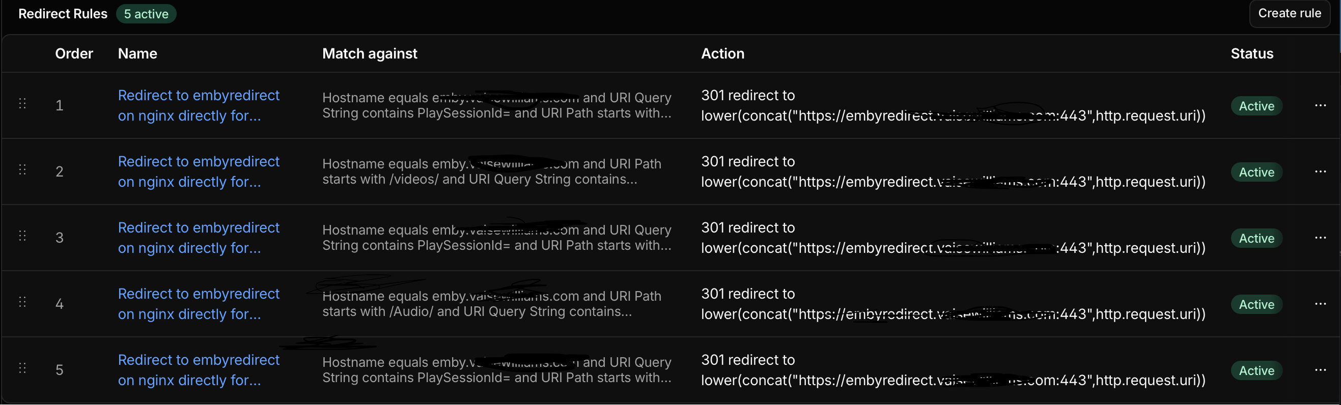

vaise 349 Posted June 16 Author Posted June 16 (edited) Not sure what you mean there ? The user is able to resolve this by turning their device fully off and on at the wall. I have had the same system for ages. Cloudflare does the app and WAF protection, then when it sees a bit of playback, it redirects those to run at my reverse proxy. This is the config in Cloudflare that does that - This system has been in use for many years. This is the first remote user to change to the new unified app. I then got another user to do it, and they got the ssl message only once. Never the guid one. I have now directed two more users to do it (reasonably technical), so lets see what happens to them. Edited June 16 by vaise

pünktchen 1430 Posted June 17 Posted June 17 You should change your Cloudflare action from 301 to 308 redirect, because with 301 most clients change POST to GET and do not preserve the request body.
vaise 349 Posted June 17 Author Posted June 17 13 minutes ago, pünktchen said: You should change your Cloudflare action from 301 to 308 redirect, because with 301 most clients change POST to GET and do not preserve the request body. Thanks heaps for that @pünktchen - I have had that set for many years however, this initial config was thought up by @HorsePDF. I did (and do not) have the skills to know the exact implications, just that is was working fine for ages. I googled what you said in AI, and it said you are spot on, so that has been done now. Thanks again for the assist, and I copied @HorsePDFon this in case he still uses this split connection method (the protection of CF WAF, without the risk of TOS bans).
