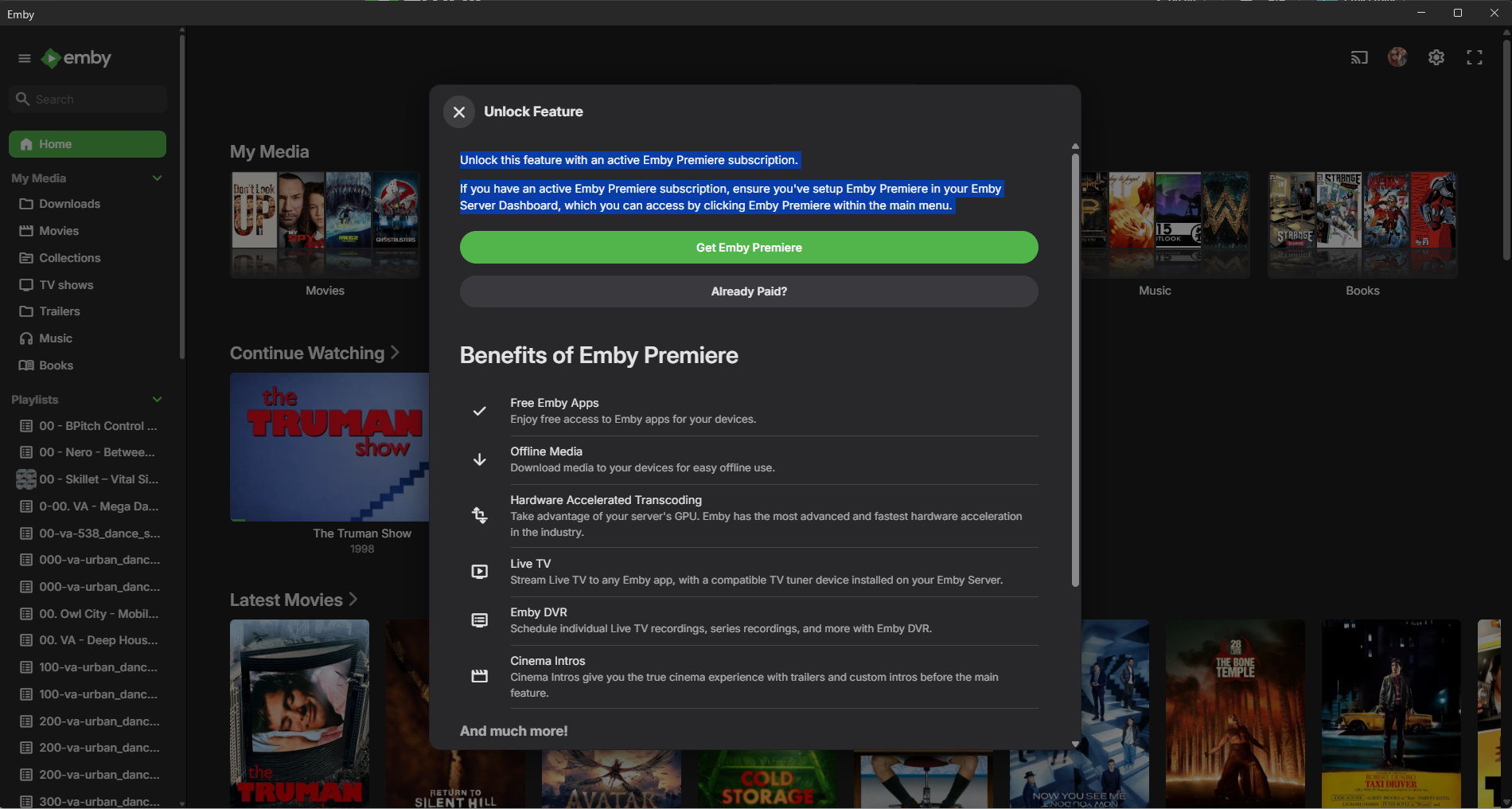

ProjectBlue 1 Posted June 9 Posted June 9 (edited) I have a licensed Emby server recently updated to 4.9.5.0 running on UNRAID. Since restarting the UNRAID server my Windows machines (Emby for Windows 2.310.2.0) can no longer play anything from the server and get the message: "Unlock this feature with an active Emby Premiere subscription." "If you have an active Emby Premiere subscription, ensure you've setup Emby Premiere in your Emby Server Dashboard, which you can access by clicking Emby Premiere within the main menu." I can play everything fine from my Android devices and Windows also worked fine up until the server reboot. I have tried: Signing into the app with another user. Resetting/Repairing the app via Settings > Apps > Installed Apps > Emby on Windows. Emby server logs attached. Any help would be appreciated! embyserver.txt Edited June 9 by ProjectBlue

ebr 17102 Posted June 9 Posted June 9 Hi. That log has virtually nothing in it but, based on your description, my guess is something in the browser you are using to try and play is blocking the license check. Ad blockers, privacy badger, etc.
ProjectBlue 1 Posted June 9 Author Posted June 9 (edited) 3 hours ago, ebr said: Hi. That log has virtually nothing in it but, based on your description, my guess is something in the browser you are using to try and play is blocking the license check. Ad blockers, privacy badger, etc. Thank you for the suggestion but this issue isn't affecting browser playback, only the Emby App for Windows from the Microsoft store is affected as mentioned in the original post. Playback via browser (Edge/Firefox) works fine, even when transcoding. Playback via Android app works fine (again, even while transcoding). I'd also like to add that all devices are accessing the server locally via LAN - not the internet. I have noticed that the Emby App for Windows was updated last night to version 2.310.0 on both of the affected Windows PC's. There were no issues before this update. To me, all evidence points towards the Emby for Windows 2.310.0 update causing this issue. Is there any way to revert the Emby App on the Microsoft Store to an older version? Edited June 9 by ProjectBlue
ebr 17102 Posted June 9 Posted June 9 1 hour ago, ProjectBlue said: To me, all evidence points towards the Emby for Windows 2.310.0 update causing this issue. Can you try re-installing manually? And, when you do so, pay very careful attention to any popups requesting access to the network or internet...
ProjectBlue 1 Posted June 9 Author Posted June 9 (edited) 53 minutes ago, ebr said: Can you try re-installing manually? And, when you do so, pay very careful attention to any popups requesting access to the network or internet... What do you mean by manually? Can you please provide steps to follow? As far as I'm aware there is only one installation option for Emby on Windows and that's the Microsoft store? I've already tried uninstalling the app (Windows 11 Settings > Apps > Installed Apps > Emby > Uninstall) And then re-installing the app (Microsoft Store > Emby > Install/Get) I know the app can access the server just fine as it allows me to sign in, play media (for a minute) and browse the libraries of the server. Edited June 9 by ProjectBlue

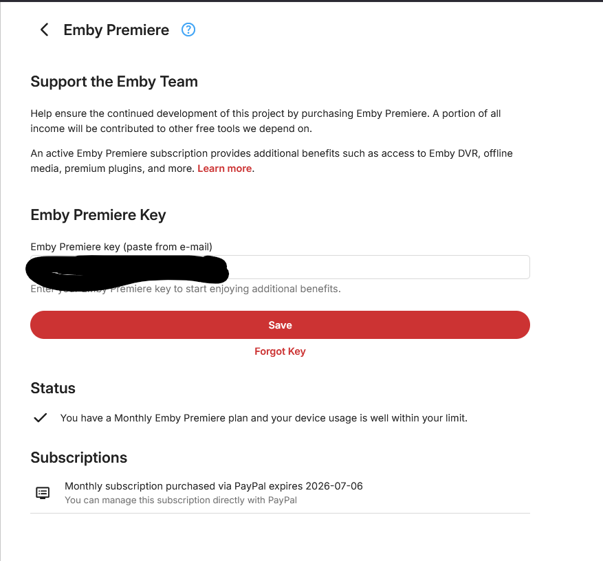

ProjectBlue 1 Posted June 10 Author Posted June 10 (edited) I have a licensed Emby server recently updated to 4.9.5.0 running on UNRAID as a Docker container. As you can see from the above image; my Premiere license is active on the server. However, I'm suddenly getting the following message on the Emby for Windows app on all of my Windows PC's: "Unlock this feature with an active Emby Premiere subscription." "If you have an active Emby Premiere subscription, ensure you've setup Emby Premiere in your Emby Server Dashboard, which you can access by clicking Emby Premiere within the main menu." I can play everything fine from my Android devices without limitation and Windows also worked fine up until yesterday. I am also able to transcode media when playing via a browser. I have tried: Signing into the app with another user. Switching server and using the server's IP address instead of hostname. Resetting/Repairing the app on Windows via Settings > Apps > Installed Apps > Emby > Repair/Reset. Reinstalling the app via the Microsoft Store. Deleting the affected devices from the Devices section on the server. I'd also like to add that all devices are accessing the server locally on the same network via LAN - not via the internet. I have noticed that the Emby App for Windows was updated last night to version 2.310.0 on both of the affected Windows PC's. There were no issues before this update. Emby server logs attached. Any help would be appreciated! embyserver(1).txt Edited June 10 by ProjectBlue

ebr 17102 Posted June 10 Posted June 10 2 hours ago, ProjectBlue said: I'm still unable to use the Emby Windows app. I'm still getting nagged with the "Unlock Feature" pop up when trying to play anything. That most likely means it cannot access our server over the internet. Make sure nothing is blocking it.

ProjectBlue 1 Posted June 10 Author Posted June 10 13 minutes ago, ebr said: That most likely means it cannot access our server over the internet. Make sure nothing is blocking it. Surely that would mean my Premiere key wouldn't "activate" after pasting it into the Premiere page on the server though? I tried removing the premiere key and then re-adding it and it allowed me to do this and shows a valid status as shown in my original screenshot. Nothing has changed on the network since this issue started and nothing outbound is being blocked from the server. Surely also; if the premiere status wasn't valid or couldn't access your servers I wouldn't be able to transcode on my web browser and Android device - correct?
ebr 17102 Posted June 10 Posted June 10 The server and the Windows app are two completely different processes. So, no, the fact that the server can validate does not mean that the Windows app can too. Please check your firewall settings.
