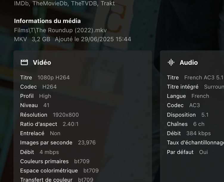

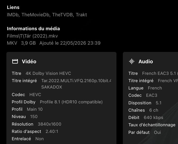

Rocco2123 0 Posted June 10 Author Posted June 10 Yes, I just checked two videos uploaded on the same day—one is listed as having been uploaded a few days ago, while the other looks like it was uploaded a year ago. It looks like there's still a trace of my old setup somewhere
