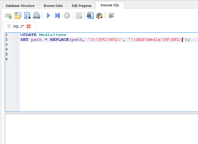

js28194 76 Posted June 11 Posted June 11 (edited) Shutdown EMBY. Make a copy of your library.db file.... then for good measure, copy your copy to another location then probably one more time to be on the safe side. Open library.db in dbbrowser for SQL Lite (free and open source) Navigate to Execute SQL tab and type the following: UPDATE MediaItems SET path = REPLACE(path, 'J:\TV1\NFL\', '\\NAS\Media\TV\NFL\'); Be mindful of the backslashes there and make sure they are correct. Again recommend change NAS to ip address but your call. (screenshots below) Click on Run (where you see the stop icon with X it should be a run icon instead) and be patient, be very patient until you see on the bottom the screen: Close DB Browser, it will ask you the save the project, you don't have to then it will prompt you save changes to the database itself. Hit Save and close. Cross your fingers and launch EMBY. Now the standard disclaimers and caveats that your are pretty much on your own with this method and it's obviously not approved by anyone, but worth a shot if you really to take the risk. Go check your paths at the library level and at check a few items directly in system metadata to confirm changes. Play a file or 5 to confirm. Edited June 11 by js28194 1

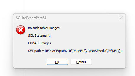

js28194 76 Posted June 11 Posted June 11 (edited) Turns out there is one more table that has a path so you must update it also. You can just modify the above command and hit run again. It is the Images table. Also, make sure the case sensitivity as these functions are case sensitive UPDATE MediaItems SET path = REPLACE(Images, 'J:\TV1\NFL\', '\\NAS\Media\TV\NFL\'); Edited June 11 by js28194 Fixing SQL Command 1
Lyfesaver 148 Posted June 11 Author Posted June 11 9 minutes ago, js28194 said: Turns out there is one more table that has a path so you must update it also. You can just modify the above command and hit run again. It is the Images table. Also, make sure the case sensitivity as these functions are case sensitive UPDATE Images SET path = REPLACE(path, 'J:\TV1\NFL\', '\\NAS\Media\TV\NFL\'); Step one ran fine, step 2 gave me this

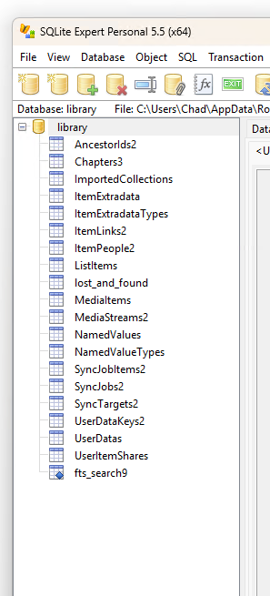

Lyfesaver 148 Posted June 11 Author Posted June 11 Only diff is I am using SQLite Expert but the table is not listed
js28194 76 Posted June 11 Posted June 11 (edited) My bad... my bad... my bad. UPDATE MediaItems SET path = REPLACE(Images, 'J:\TV1\NFL\', '\\NAS\Media\TV\NFL\'); I haven't done SQL in a very long time, my apologies. Luckily though, that command not running didn't break anything, just didn't update anything. Edited June 11 by js28194 1
