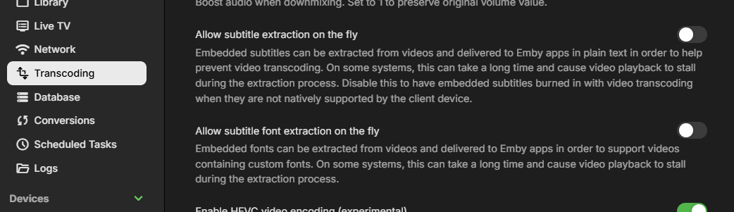

pwhodges 2132 Posted June 10 Posted June 10 22 hours ago, JsinFate said: Do any Devs know if extracting SRT files and and turning them into VTT streams in a web browser is expected behavior? You have some control over this in the Transcoding menu: And yes, extracted subtitles are converted to VTT. Paul 1
Luke 43549 Posted June 10 Posted June 10 On 6/9/2026 at 6:11 AM, JsinFate said: Do any Devs know if extracting SRT files and and turning them into VTT streams in a web browser is expected behavior? HI, yes it is. The browser video players don't support embedded subtitle streams, so it has to be supplied separately by the server. 1
