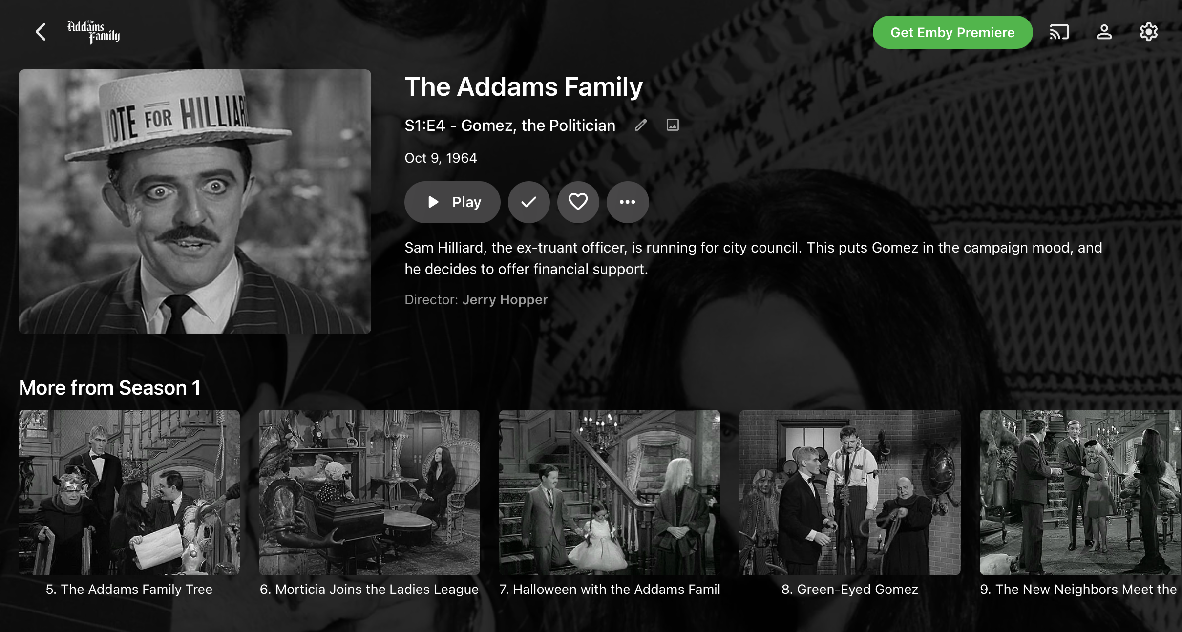

OMGzilla 2 Posted June 12 Author Posted June 12 9 hours ago, Luke said: I mean when you click on the episode to view the full information about it. What does it say there? Right. So basically as above if I understand correctly. Here's a screen cap from a TV episode as an example.
OMGzilla 2 Posted June 12 Author Posted June 12 32 minutes ago, Luke said: Is this a video file on your server? Yes, everything I have is self-hosted. All files are on an external drive connected to my iMac by USB-C. I did try making a new folder on the internal drive and tested with a TV series I hadn't yet added otherwise to rule out that as the culprit, but no change. Movies are also all on this same drive but are unaffected.
