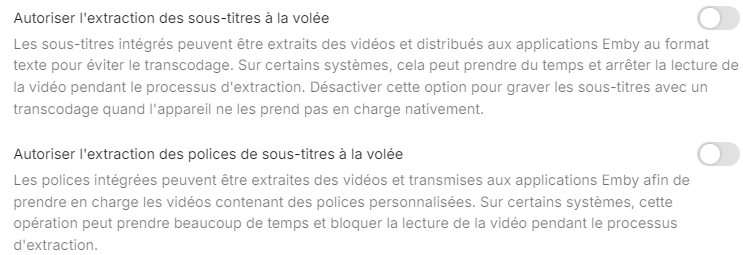

Luke 43719 Posted June 16 Posted June 16 If your system can't do this quickly enough then you may want to disable on the fly subtitle extraction in server transcoding settings. Just know that if you do that, you will see more video transcoding and less direct play.

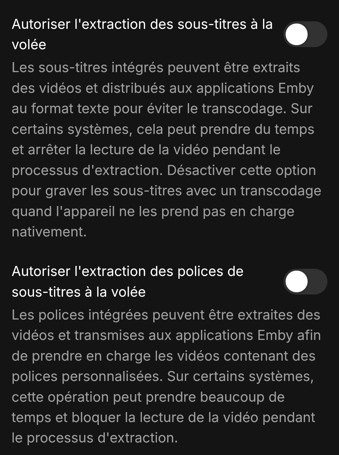

fabien_m2002 27 Posted June 16 Author Posted June 16 (edited) 3 hours ago, Luke said: If your system can't do this quickly enough then you may want to disable on the fly subtitle extraction in server transcoding settings. Just know that if you do that, you will see more video transcoding and less direct play. You mean theses settings? I have already enabled/disabled them but same result. Edited June 16 by fabien_m2002
Luke 43719 Posted June 16 Posted June 16 13 hours ago, fabien_m2002 said: You mean theses settings? I have already enabled/disabled them but same result. Now that you've disabled them, let's look at a new log example. thanks.
fabien_m2002 27 Posted June 17 Author Posted June 17 Hello @Luke I tested one VOD with disabling extraction on the fly settings. Same behavior: subtitles (not forced) start to appear after 4 mns. I noticed something strange: on my others clients (PC, Smartphone): forced subs not appeared but not forced subs appear immediatly Here the logs embyserver.txt
