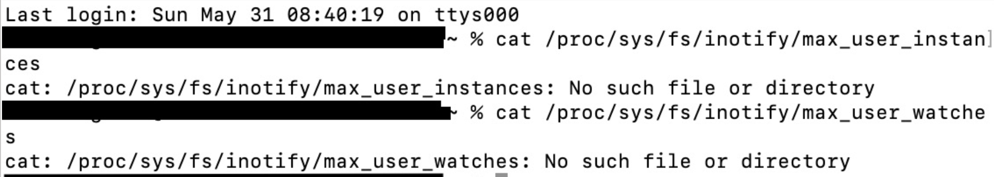

FrostByte 5685 Posted May 31 Posted May 31 1 hour ago, zhianjo said: I installed the previous version of Emby 4.9.3.0 and that works fine. In version 4.9.5.0 I did what @Neminem suggested but that didn't work. Could you post what the task settings are? Are you still getting inotify errors in your log? Were you logged on as an admin when doing the cat statements? You wouldn't be getting inotify errors if it didn't exist The instructions work so I'm trying to figure out what went wrong. BTW the inotify errors really only affect RTM. It isn't going to fix playback of movies. 1

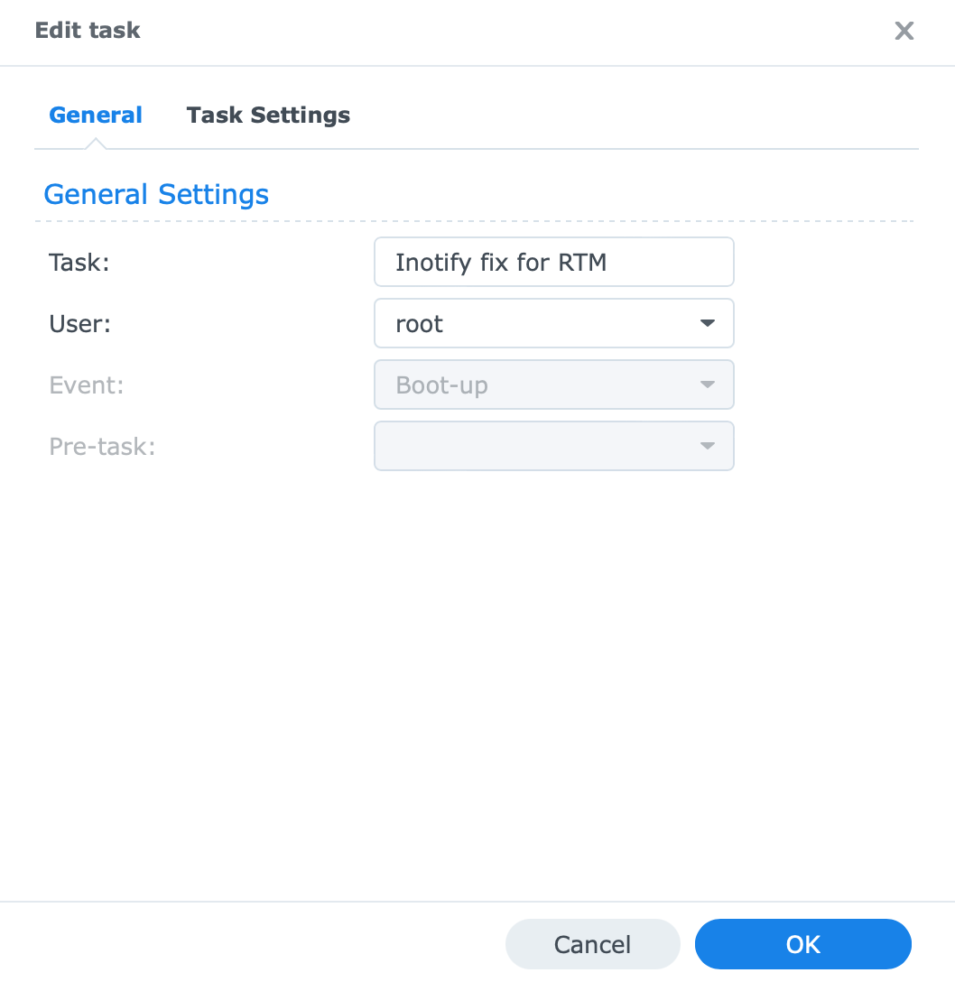

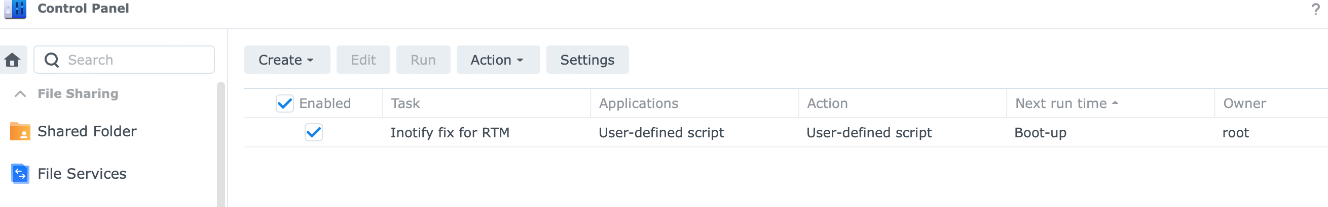

zhianjo 0 Posted May 31 Author Posted May 31 @FrostByte Thanks for the reply I appreciate the help. 1. Could you post what the task settings are? Look at the files below. 2. Are you still getting inotify errors in your log? I didn't get any inotify errors in my log as far as I can see. 3. Were you logged on as an admin when doing the cat statements? I am the administrator. 4. You wouldn't be getting inotify errors if it didn't exist. I think it's another issue because why does Emby 4.9.3.0 works fine (no errors-no delay) and with 4.9.5.0 it doesn't. With Emby 4.9.5.0 the movie start up screen comes up you can see all the settings but the movie doesn't start. In the middle of the screen you see the blue circle turning around and that's it. 22
FrostByte 5685 Posted May 31 Posted May 31 26 minutes ago, zhianjo said: @FrostByte Thanks for the reply I appreciate the help. 1. Could you post what the task settings are? Look at the files below. 2. Are you still getting inotify errors in your log? I didn't get any inotify errors in my log as far as I can see. 3. Were you logged on as an admin when doing the cat statements? I am the administrator. 4. You wouldn't be getting inotify errors if it didn't exist. I think it's another issue because why does Emby 4.9.3.0 works fine (no errors-no delay) and with 4.9.5.0 it doesn't. With Emby 4.9.5.0 the movie start up screen comes up you can see all the settings but the movie doesn't start. In the middle of the screen you see the blue circle turning around and that's it. 22 I was referring to what you input on the task settings tab. That's the General tab in the pick. However, if you are no longer getting inotify errors in the Emby server log then the script is working. Correct, as mentioned this only affects RTM. Has nothing to do with movie playback. 1
