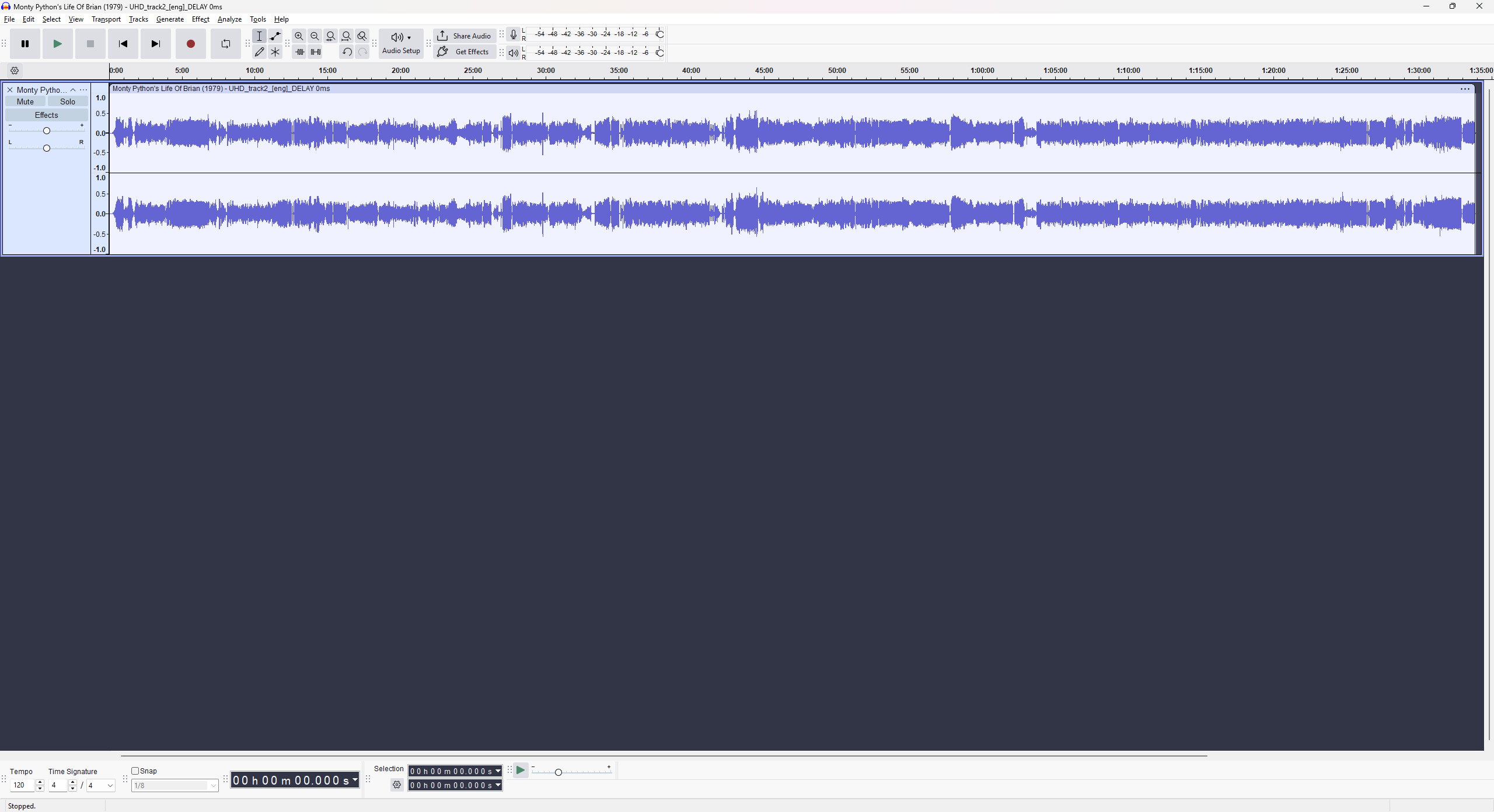

voodoo5_6k 36 Posted June 1 Author Posted June 1 Thanks Luke. But I'm not sure why it would need to transcode. This is a DTS-HD MA track. The other DTS-HD MA track is working fine. In the log, it says: Fri May 29 21:00:32.621 GMT+02:00 2026 DecoderAudioRenderer: Audio sink error androidx.media3.exoplayer.audio.AudioSink$InitializationException: AudioTrack init failed 0 Config(48000, 252, 8, 4500000) Format(4, Surround 5.1, video/x-matroska, audio/vnd.dts.hd, null, -1, en, [-1, -1, -1.0, null], [6, 48000]) This is a stereo track however, not Surround 5.1. Is it trying to initialize the audio sink for 5.1? Looking at the track in e.g. Audacity also shows it as stereo.
