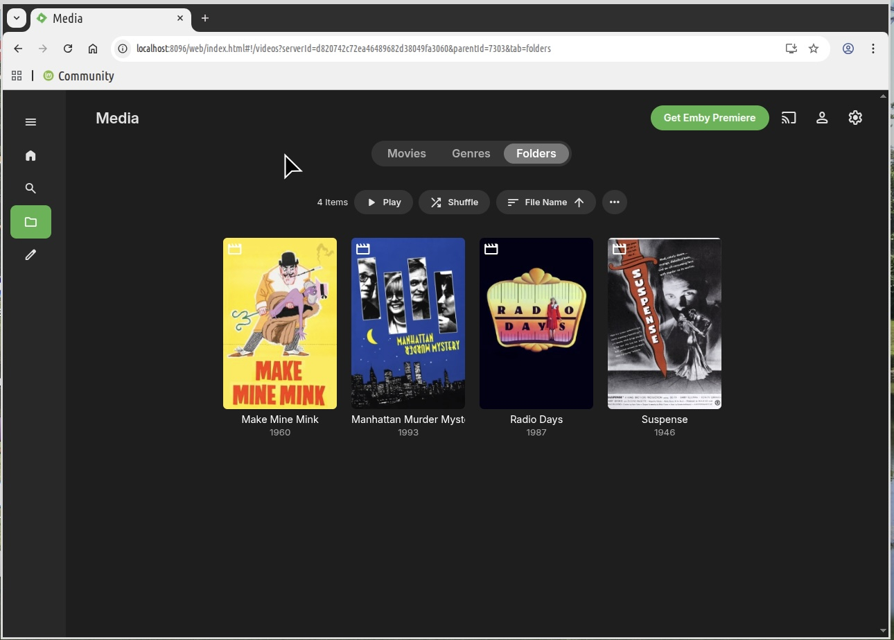

nypaulie 6 Posted May 29 Author Posted May 29 (edited) Yes, I’m aware of the OS mortality issue, but am reluctant to upgrade, as I’ve had some rough going dealing with this in the past, but thanks for reminding me. Thanks to your help my media directory now looks like this. Edited May 29 by nypaulie Wanted to add a graphic image. 1
