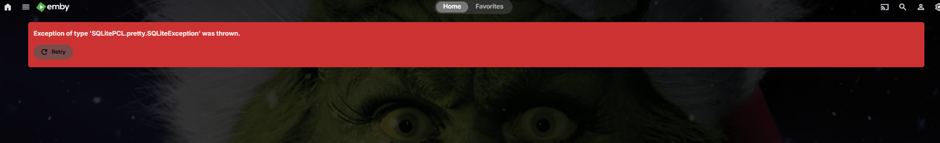

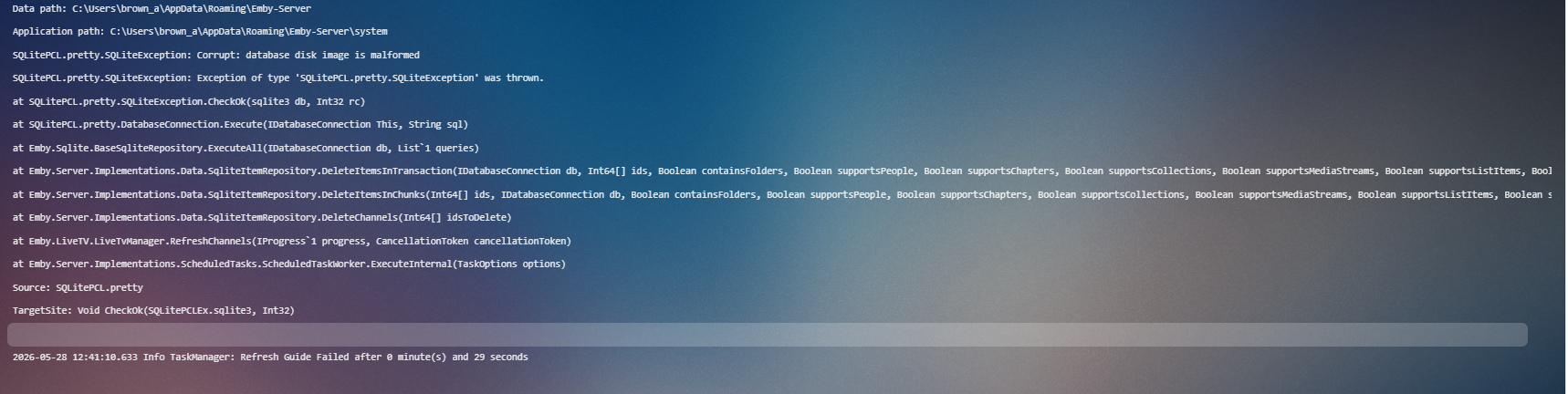

ab123ga 25 Posted May 28 Author Posted May 28 I restored from a backup and this is now what I get Data path: C:\Users\brown_a\AppData\Roaming\Emby-Server Application pe(s) and 29 seconds embyserver (5).txt

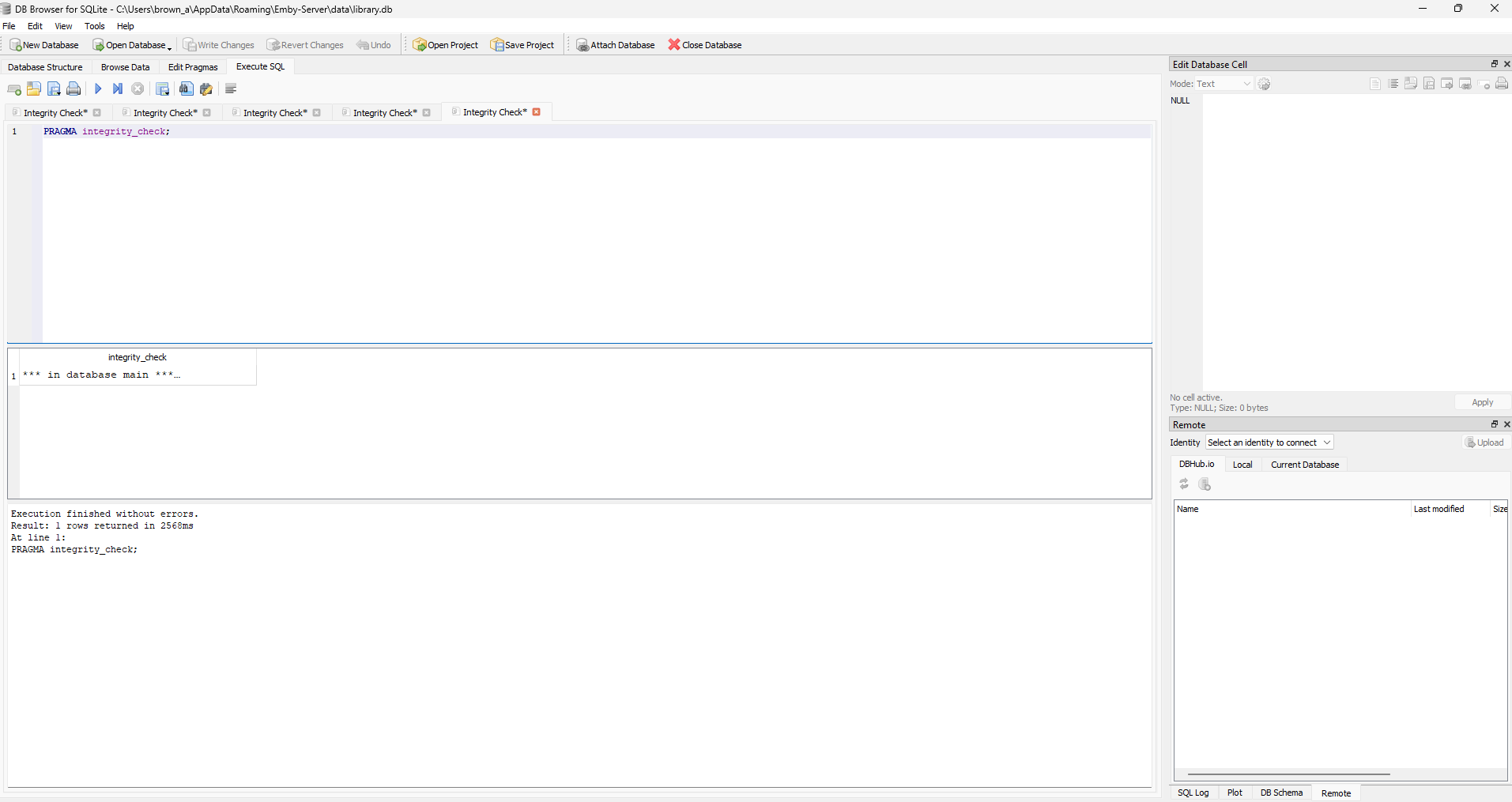

ab123ga 25 Posted May 28 Author Posted May 28 Based upon the SQLITE error above, I searched for issues in the forum and found how to check for corrupt DB. I downloaded the tool and ran an integrity check. I'm not sure if it is a versioning thing but the documentation says I should get an "ok" but it does not say that. However it says it ran without errors.

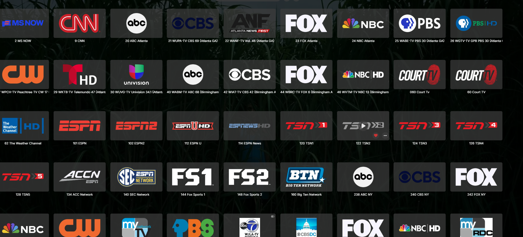

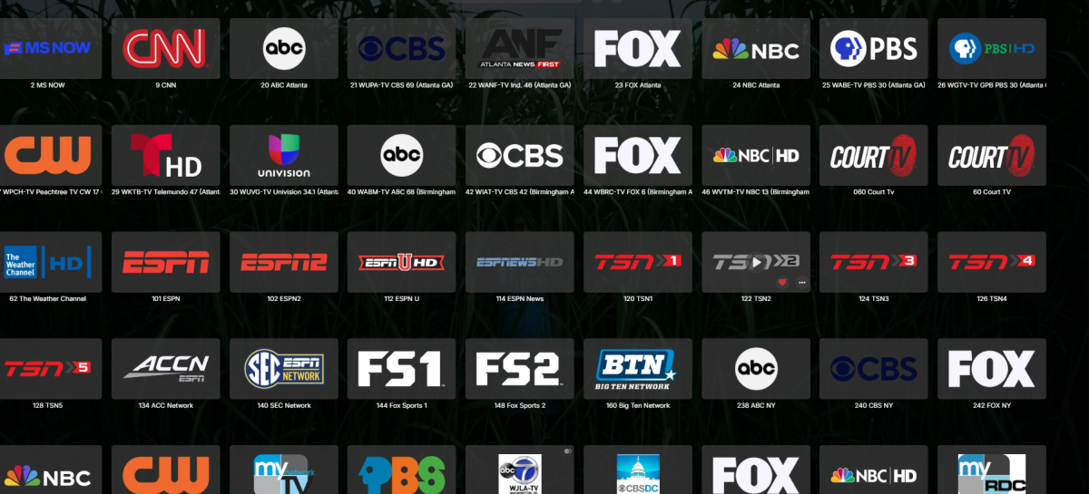

ab123ga 25 Posted June 1 Author Posted June 1 (edited) Something weird is continuing to happen with my system. After spending hours rebuilding my system, I got things back to normal. I have about 290channels off a proxy that I serve to emby. Sometime after a guide refresh (10ET), I was looking at my guide both on a firestick and web and only saw about 160+ channels. I refreshed the connection and saw the same thing. I see DB lock errors in the guide but not sure if that is causing it. About 30 minutes later, the guide now shows all of my channels. This is getting frustrating b/c 1) it appears that something is causing some failure to display all channels and 2) even if the channels return it was an issue and makes me believe I have more work to do. Note that around 11:45ET I did restart emby so not sure if the restart fixed whatever was happening. Two logs attached. Added information an hour after original post. In reviewing the guide, the guide is there but all programming for those that were missing is gone. I will have to do a refresh and who knows what I'll end up with. embyserver-5.txt embyserver (8).txt Edited June 1 by ab123ga
sa2000 878 Posted June 1 Posted June 1 Starting to look at the logs. In the initial logs the data folder path for Emby Server appears wrong Wondering if you have some non standard setup with regards to the emby server folders I am trying to figure out why the Emby Server Data path on the 28th May does not show folder programdata - Would you happen to have any embyserver logs from before 28th May 01:50 am? Anything specific you have done to result in this? This path does not look right Data path: c:\Users\brown_a\AppData\Roaming\Emby-Server It should be Data path: c:\Users\brown_a\AppData\Roaming\Emby-Server\programdata Similarly all these folders should be below programdata 2026-05-28 01:50:06.063 Info Main: Logs path: c:\Users\brown_a\AppData\Roaming\Emby-Server\logs 2026-05-28 01:50:06.063 Info Main: Cache path: c:\Users\brown_a\AppData\Roaming\Emby-Server\cache 2026-05-28 01:50:06.063 Info Main: Internal metadata path: c:\Users\brown_a\AppData\Roaming\Emby-Server\metadata At 2026-05-28 10:00:22 the database lock error started ? Do you have some tools/applications that may have accessing the database files then ? perhaps some system backup tool ? The log goes up to 2026-05-28 11:16:48 when you selected server restart from the dashboard On 28/05/2026 at 17:05, ab123ga said: I tried to restore from last night's backup and it went from bad to worse. What time was this on the 28th May ? And how did you do the restore? The server was launched again at 2026-05-28 12:15:40 Again the paths do not look right as there is no programdata folder showing Data path: C:\Users\brown_a\AppData\Roaming\Emby-Server Application path: C:\Users\brown_a\AppData\Roaming\Emby-Server\system 2026-05-28 12:15:40.610 Info Main: Logs path: C:\Users\brown_a\AppData\Roaming\Emby-Server\logs 2026-05-28 12:15:40.610 Info Main: Cache path: C:\Users\brown_a\AppData\Roaming\Emby-Server\cache 2026-05-28 12:15:40.610 Info Main: Internal metadata path: C:\Users\brown_a\AppData\Roaming\Emby-Server\metadata First indication of database being malformed was at 2026-05-28 12:16:56 The latest logs from 1 June do show there being programdata folder ! Data path: C:\Users\brown_a\AppData\Roaming\Emby-Server\programdata Application path: C:\Users\brown_a\AppData\Roaming\Emby-Server\system 2026-06-01 01:55:09.618 Info Main: Logs path: C:\Users\brown_a\AppData\Roaming\Emby-Server\programdata\logs 2026-06-01 01:55:09.618 Info Main: Cache path: C:\Users\brown_a\AppData\Roaming\Emby-Server\programdata\cache 2026-06-01 01:55:09.618 Info Main: Internal metadata path: C:\Users\brown_a\AppData\Roaming\Emby-Server\programdata\metadata I presume this is because this was a new install What is the history of your emby server - versions / installation / upgrades ?

ab123ga 25 Posted June 1 Author Posted June 1 (edited) @sa2000- The first log was probably pre new installation on Thursday. The folder is Use. rs\brown_a\AppData\Roaming\Emby-Server\programdata\data However, this does not answer why I keep losing channels. When I got home the number of channels in my guide was about 30. Something is severely wrong and its not clear what is the resolution to this issue. I had to restart emby and the more channels are showing up but not the 259 channels I have. After about another 45 minutes the rest of the channels show up however as noted before, the guide for the channels that were lost is now gone AGAIN. I have to do another refresh to get the data to show up. The most frustrating part is that one would assume a clean install would mean getting back to normal. Not here. embyserver (1).txt embyserver-6.txt Edited June 2 by ab123ga
