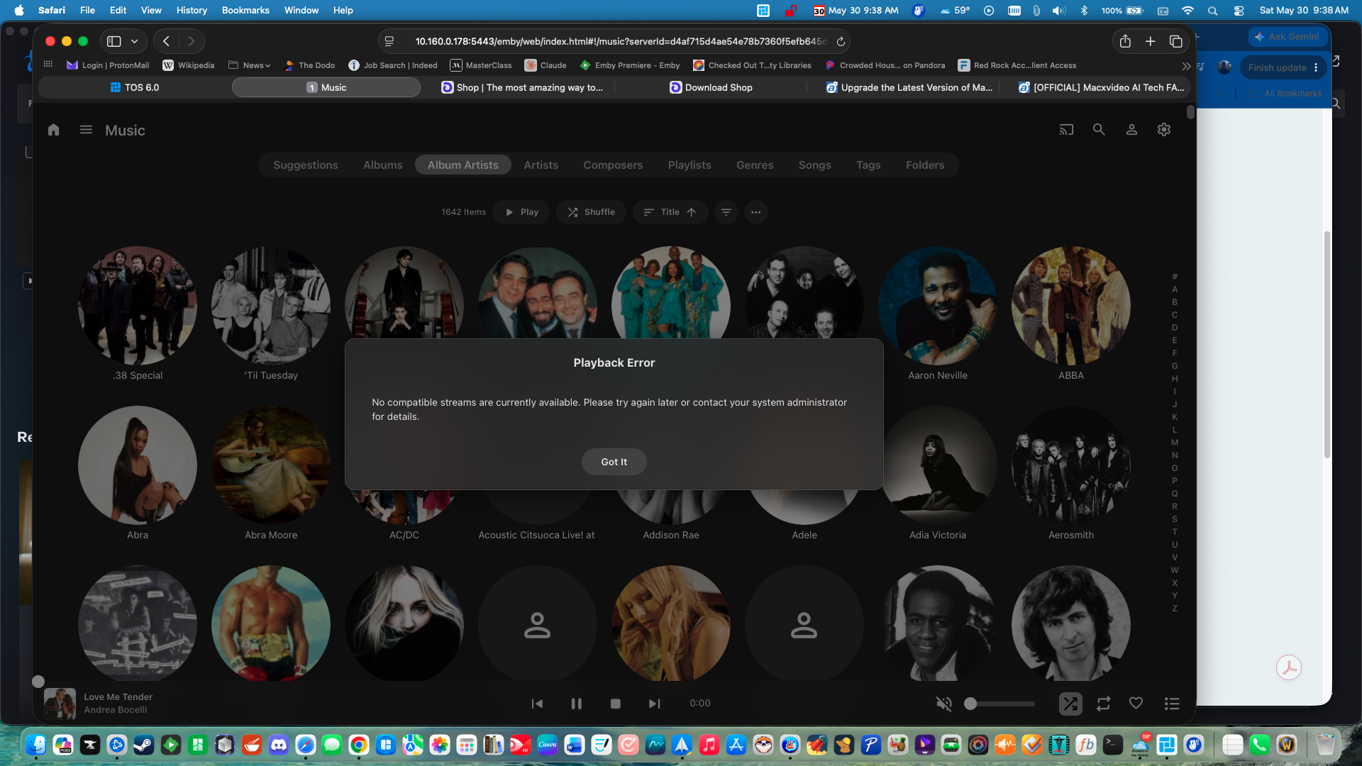

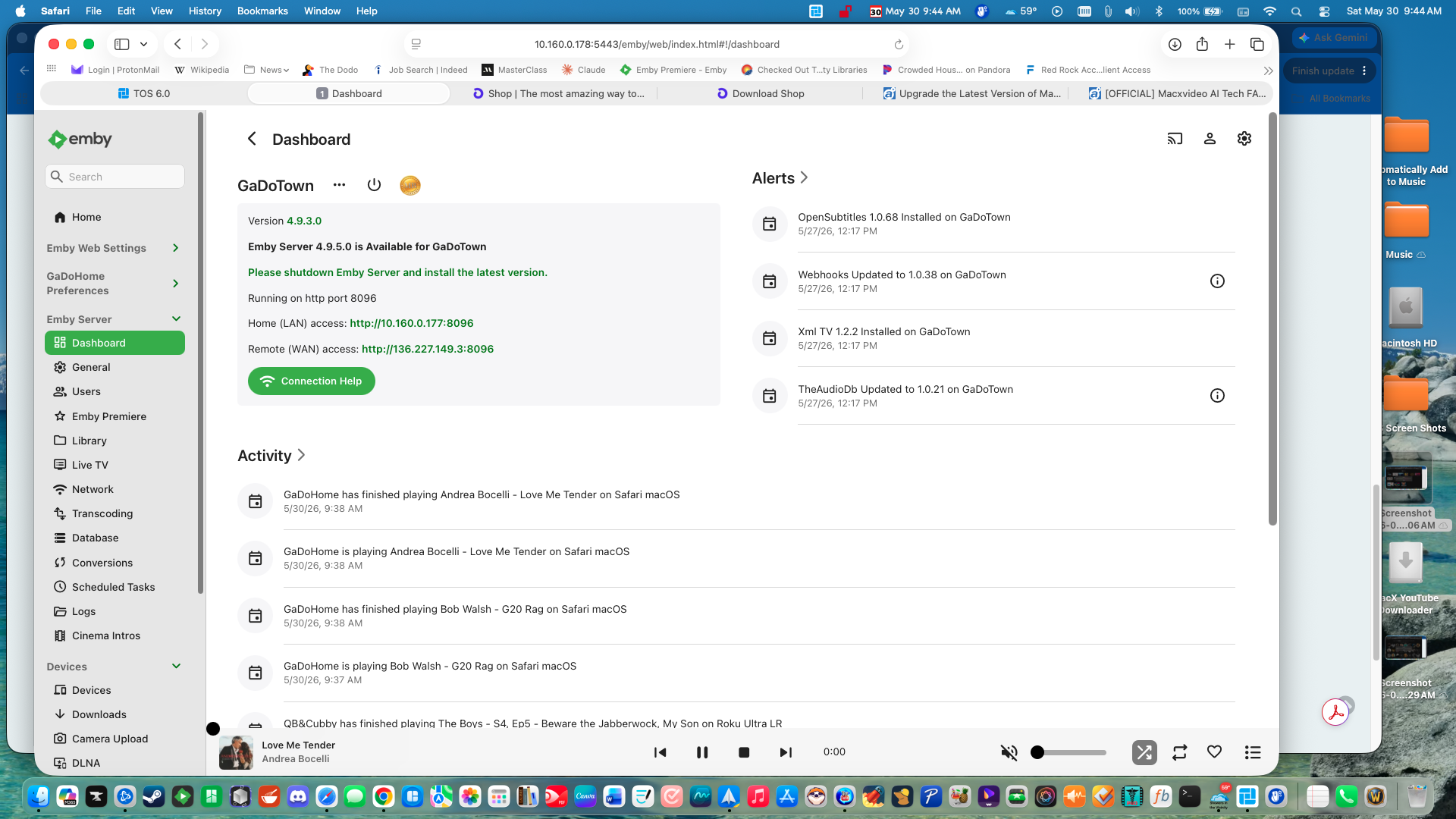

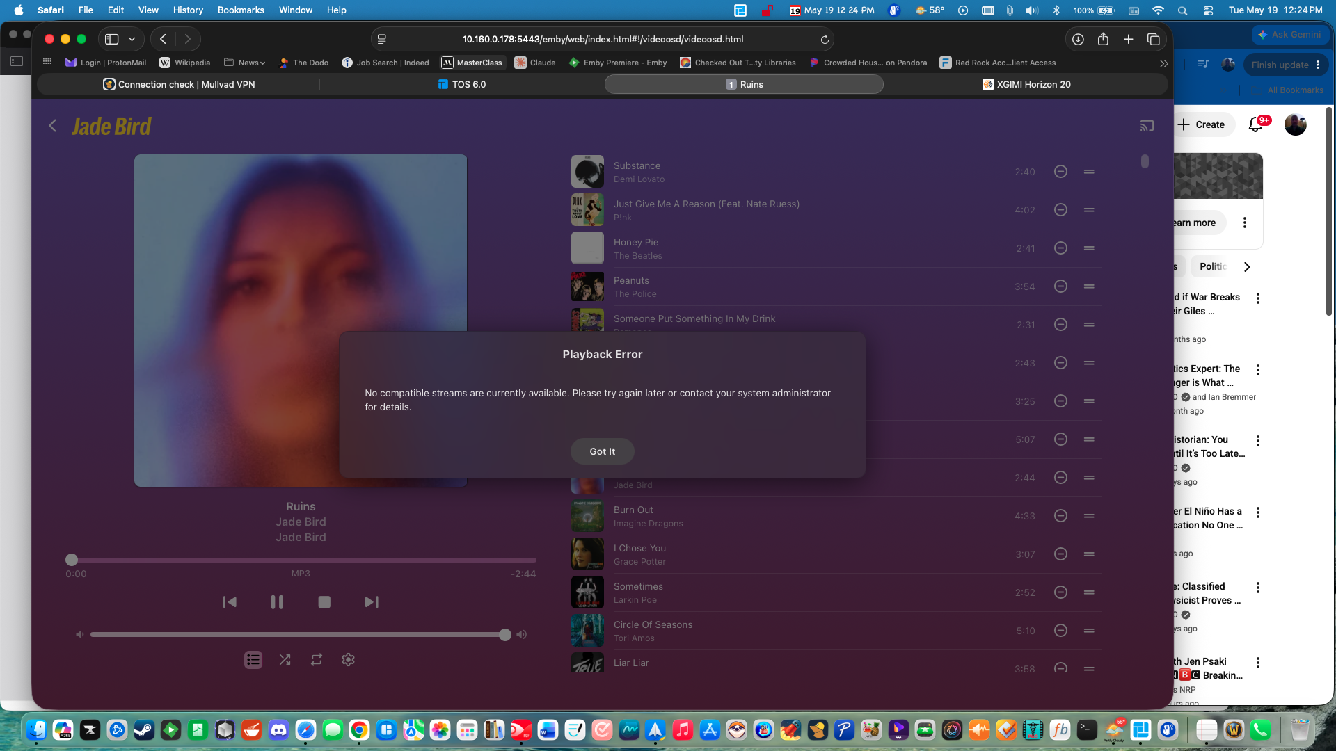

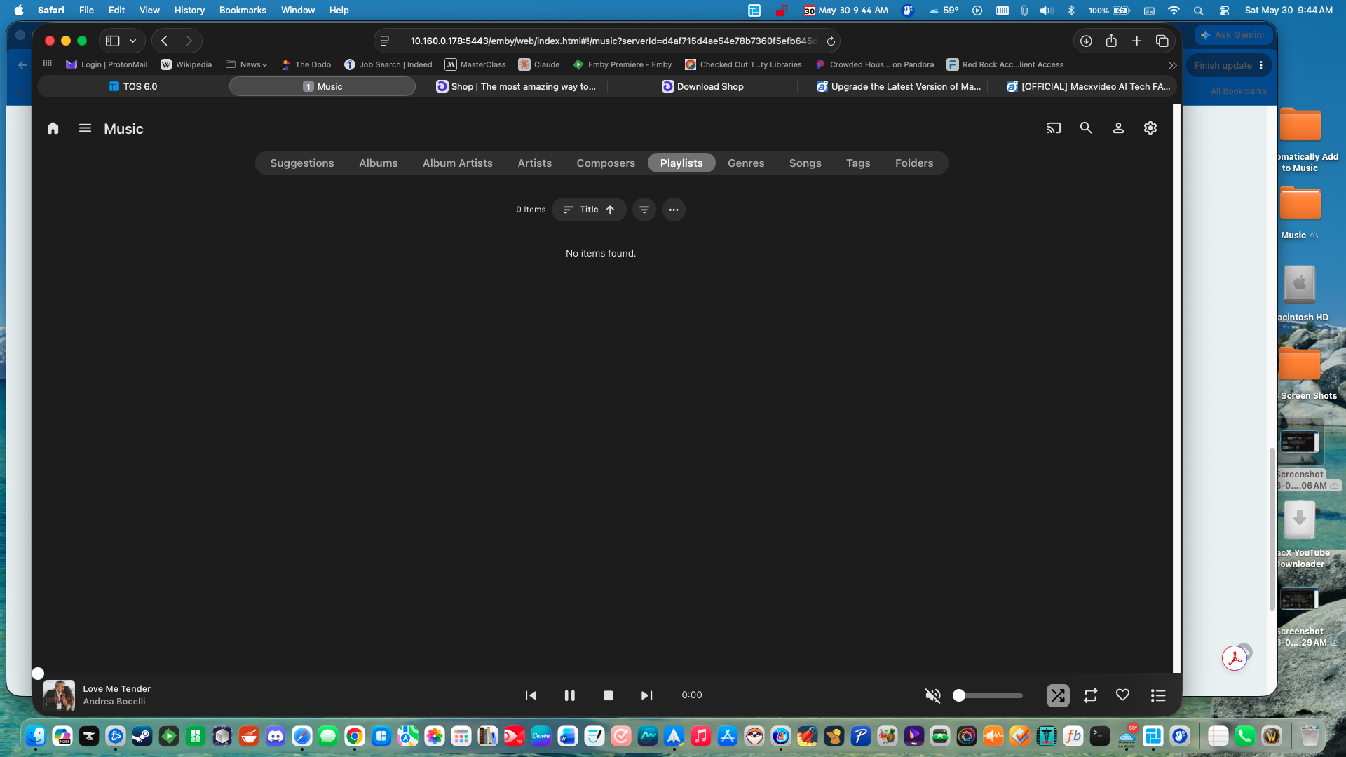

brucesnelgrove 2 Posted May 30 Author Posted May 30 This what happened after updating to 4.9.5. Ignore image 2. Firstly, Image 1 shows that the update did not take, remaining at 4.9.3. Secondly, and most importantly, Image 3 is a screenshot of my playlists afte the attempted update. Notice, there are no playlists. There used to be 50. All lot of work in those. The playlist files are still intact and where they are supposed to be. And I still run into the play errors in image 4. This seems to be limited to mp3 files. I don't run into any problems with .mp4 or .mkv files embyserver-2.txt

brucesnelgrove 2 Posted June 5 Author Posted June 5 I have rebooted twice. Still lists 4.9.3 as current rev. and also telling me 4.9.5 is available Before I updated I noticed 2 folders before my playlists disappeared. One said "Playlists" and the other "userplaylists". I noticed "userplaylists"was empty and "PLaylists" was occupied with the playlists I created. After my attempted upgrade and losing 50 playlists, I went back in and copied the ".m3u" files to "userplaylists" and my playlists returned, and they play. I am still running into problems with iOS not connecting. As a result, I have purchased dedicated music streaming software for my phone that allows me to stream and take my playlists with me. It appears the 4.9.5 leaves the media files alone, but destroys or damages "user created" data.
Luke 43719 Posted June 11 Posted June 11 @brucesnelgrovedid you notice this? This is why you can't play: 2026-05-30 09:38:00.004 Info UniversalAudioService-0HNLS95NDSS62:00000001: GetPostedPlaybackInfo request. IsPlayback: true, isInLocalNetwork: True 2026-05-30 09:38:00.005 Info UniversalAudioService-0HNLS95NDSS62:00000001: User policy for GaDoHome. EnableAudioPlaybackTranscoding: True 2026-05-30 09:38:00.005 Info SessionManager: Adding playSession 1779925271201 to session 1d77f26574f2d9bb4d71553ff1173c68 2026-05-30 09:38:00.006 Error UniversalAudioService-0HNLS95NDSS62:00000001: Error processing request *** Error Report *** Version: 4.9.3.0 Command line: /Volume1/@apps/emby/emby-server/system/EmbyServer.dll -programdata /Volume1/Emby -ffdetect /Volume1/@apps/emby/emby-server/bin/ffdetect -ffmpeg /Volume1/@apps/emby/emby-server/bin/ffmpeg -ffprobe /Volume1/@apps/emby/emby-server/bin/ffprobe -defaultdirectory /mnt/public -updatepackage emby_TOS5_APP_{version}_x86_64.tpk Operating system: Linux version 6.1.120+ (root@51f02058744a) (x86_64-tnas-linux-gnu-gcc.br_real (Buildroot 2023.08.1) 13.2.0, GNU ld (GNU Binutils) 2.40) #52 SMP PREEMP OS/Process: x64/x64 Framework: .NET 8.0.22 Runtime: Volume1/@apps/emby/emby-server/system/System.Private.CoreLib.dll Processor count: 8 Data path: /Volume1/Emby Application path: /Volume1/@apps/emby/emby-server/system System.UnauthorizedAccessException: System.UnauthorizedAccessException: Access to the path '/Volume1/GaDo_Storage1/MediaSource/Music/Andrea Bocelli/Passione (Super Deluxe Edition)/Love Me Tender.mp3' is denied. ---> System.IO.IOException: Permission denied The server is being denied permission to access the file. It's a shame you had to purchase new software for something that can be easily resolved. Can you ensure the server has permission to read the file and then try again? Thanks !
Marcel230984 1 Posted August 2 Posted August 2 Had this issue on 4.9.5 i moved my playlists from userplaylists to playlists folder (old structure) after serverreboot all seems to be fine. 1
